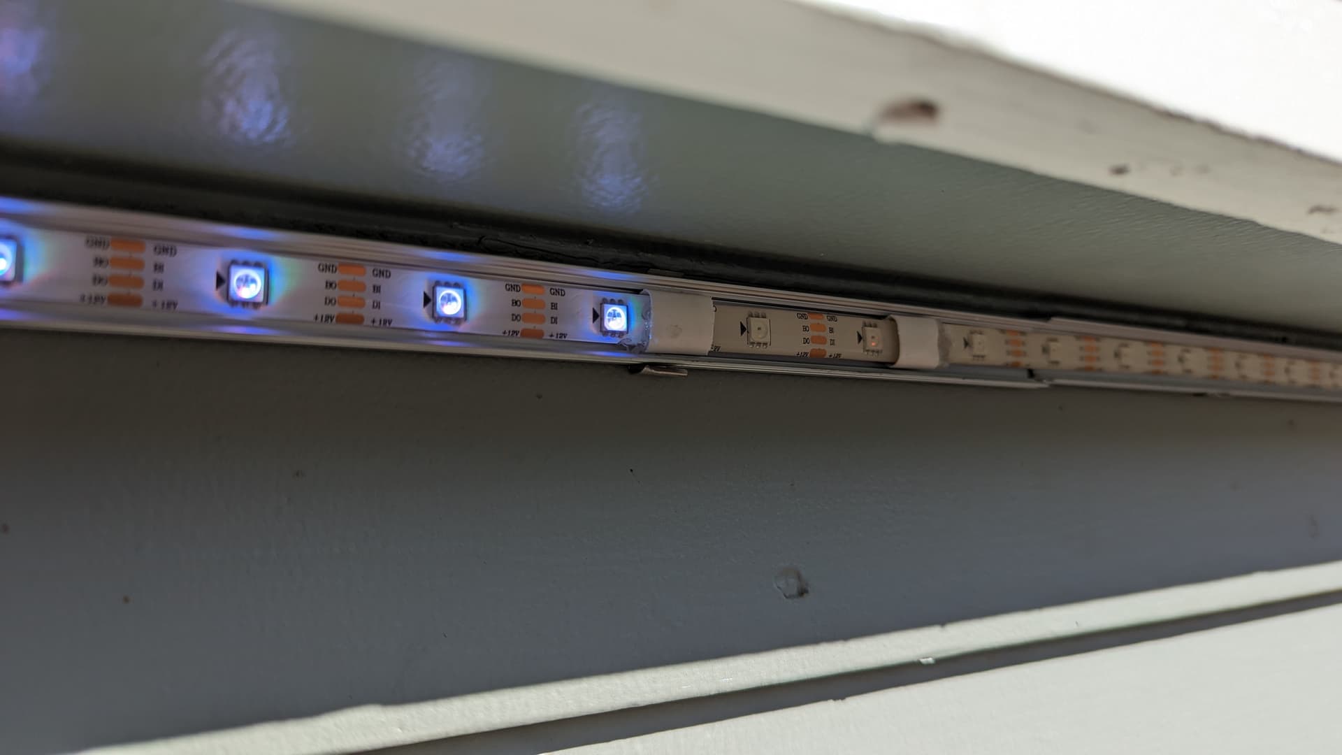

I found my pics from last year’s fault:
You can see the two pixel strip I used to fix a bad pixel in the original install.
When I removed the insulation, it was clear the solder had been pulled apart. I assume the backing strip was flush when I started, and the solder was just stretched until it broke. This is a very long section, so I think some stretch is unavoidable. Since it wants to stretch here, I think I will let it and just add some wires.

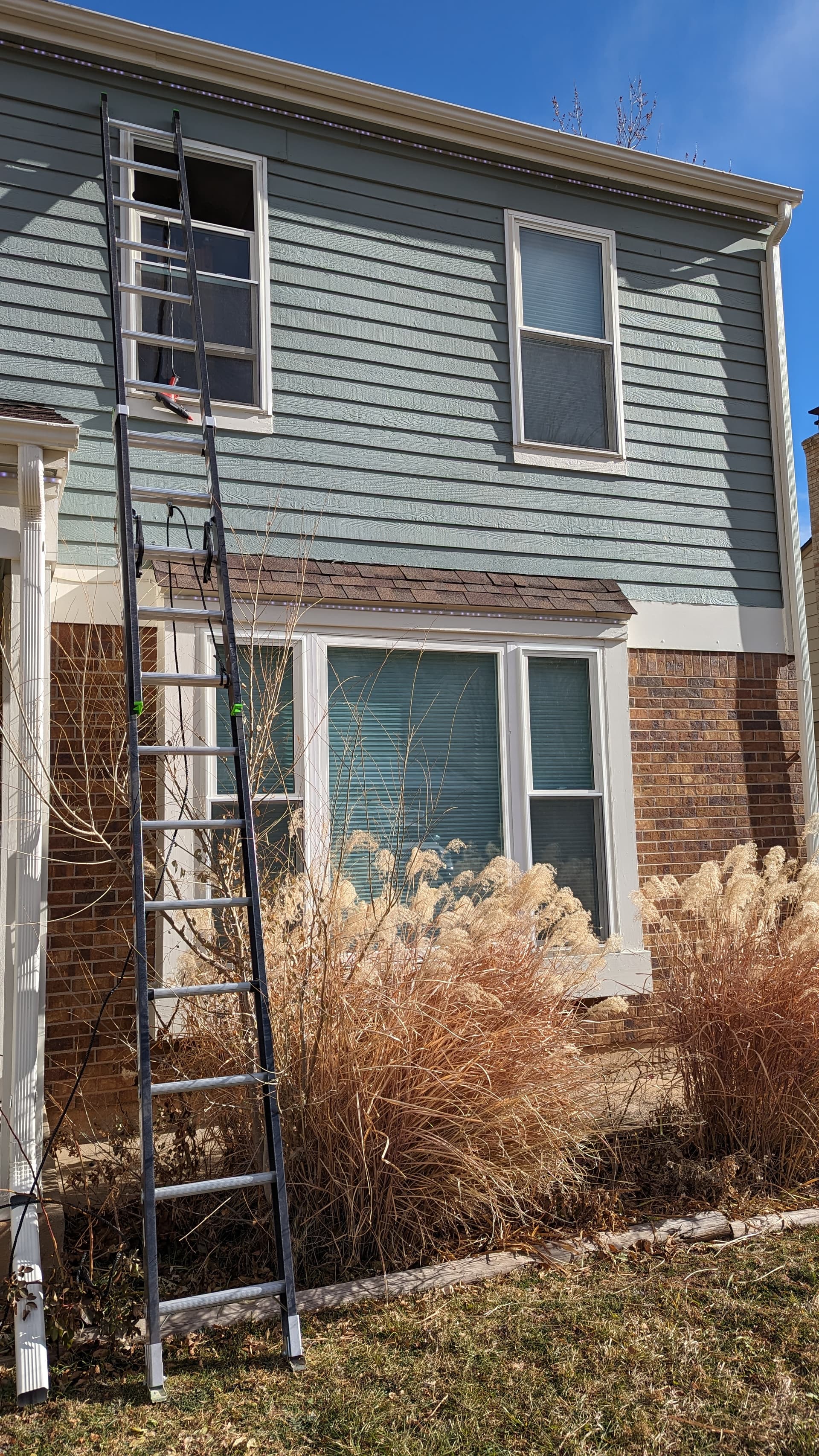

Any advice on buying a ladder? This is the top of the second story of my house. I used a 24’ before and it worked fine. I could borrow it again, but it would have come in handy a couple of times.

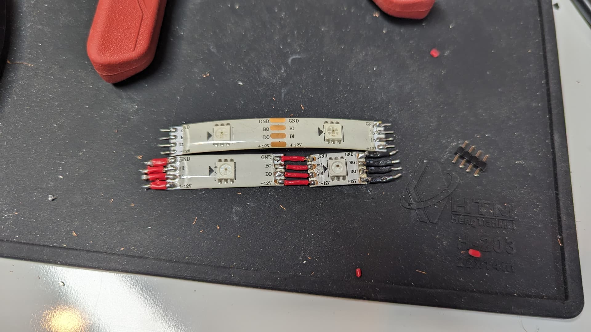

I have some more dense version of the same leds. It is extra, but I made this patch with more stranded wire. I haven’t installed it yet.
A few things I do with my LEDs when I patch them.
  1. I put a layer of electrical tape under the new LEDs as a precaution
  2. I do the solder jumper when I solder the new LEDs in place
  3. I put a healthy globe of hot glue over the top of the new solder joint to seal the joint and also glue everything to the underlying metal frame

Yeah. I put heat shrink over them and fill the heat shrink with hot glue before I shrink it. This is before that to show the detail.
Should solve your stretching problem! I wouldn’t call that extra. Just precautious
So, I have been up and down the ladder a bunch and I keep screwing it up. I ruined a bunch of pads on the LEDs and had to make longer patches. The final patch is 7 pixels now :roll_eyes:.
This is my new least favorite place to solder:
This morning was also cold and windy. So that sucked. But it is fixed. I hope it is permanent now. Someone remind me to check next november.
