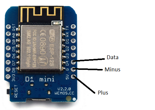

Hmprf - tried the Wemos D1 now, and couldn’t even get the single led working…ah. need sleep. Perhap’s I’ll buy one of those led strips that comes with a receiver and a remote. Too bad they don’t have those flashy rainbow options.
Is a resistor really necessary for short wires? Do you have an image of your setup?
led on d1 mini

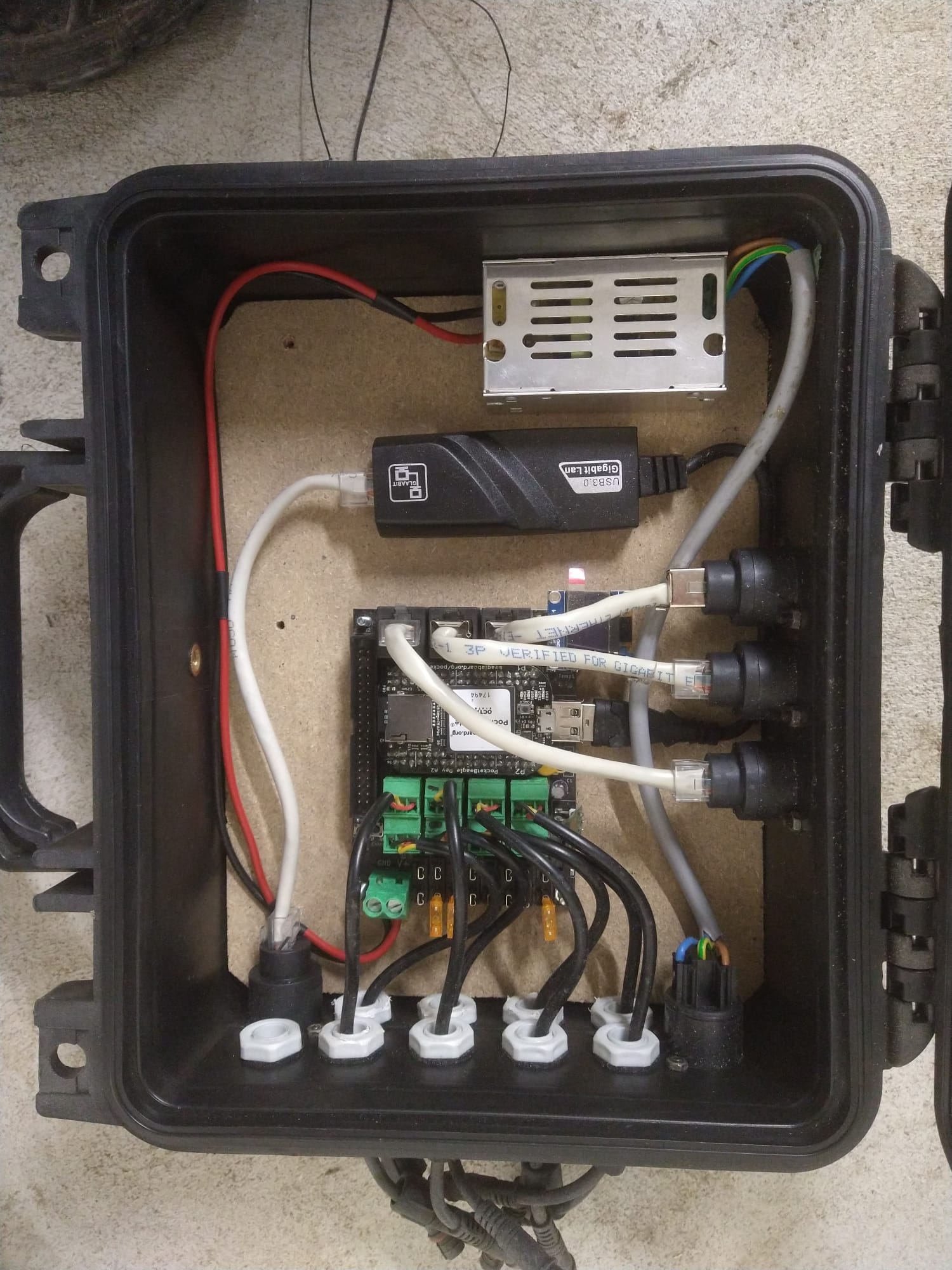

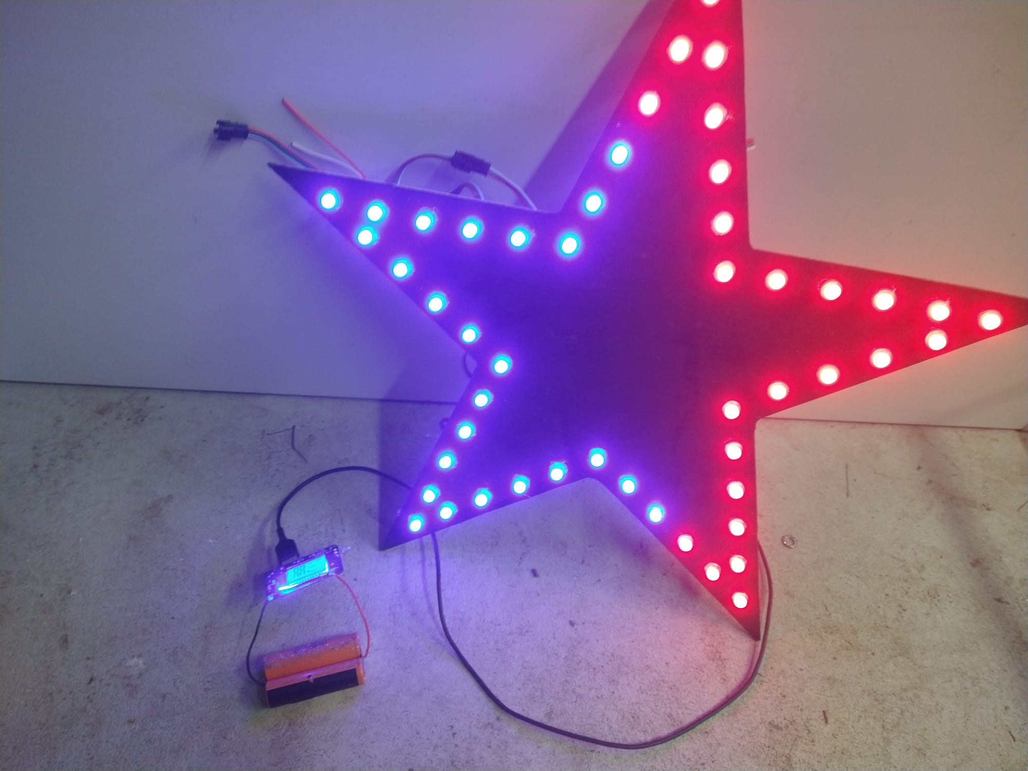

I understand your frustrations; have been busy tonight with espixelstick 4.0 beta on an esp32 using multiple outputs and a pixel matrix.
IRL…
Testing ESP32 with multiple outputs
On of the big boys for many more pixels
A small powerbank is all that is needed for some action!

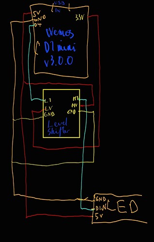

Wow - @jeffeb3 and @kockie-nl you deserve more than a beer, I’d better get you guys half a raindeer! Thanks a lot, and thanks for your thourough rant AND explenation Jeff. I’ve been wondering how the ws2812s are supposed to work with the d1 3v logic. I’ve had several holes in my understanding, that only have made me bang my head against the wall. But now the brainfog is gone - and I feel like I somehow understand what is going on!
My wife sends you all her regards - seriously! She is pleased that my mood have lightened, and that I’m out of the “banging-my-head-against-the-wall mood” :smiley:

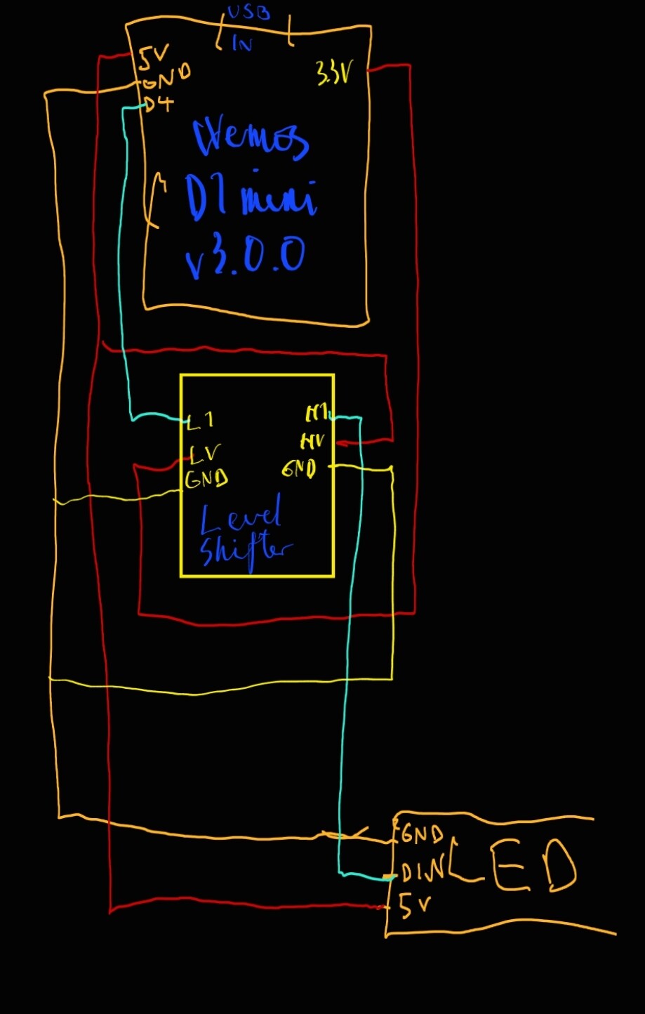

Soo - now I have to see of the logic converters I’ve got lying are the right ones for this task. I hooope it’s bi-directional.
You don’t need bi-directional. The leds don’t answer…
OK, they do, but with lightpulses instead of electric signals.
I was thinking in terms of the direction of the converter, if it supports converting both 3-5v and the opposite. Perhaps it’s obvious, but what do I know, I’m only a fine arts guy :person_shrugging:
These are the ones I’ve got: 5PCS 4 Channel IIC I2C Logic Level Converter Bi-Directional Module 5V to 3.3V
https://a.aliexpress.com/_mMe261q
From what I can fathom, they should be able to do the trick yes? Edit: talking to myself here. Yes they will.

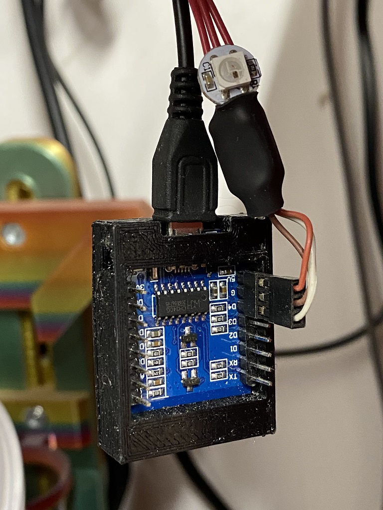

This is what I have, with 39 more pixels after the first:
I lied earlier… it was a 470ohm, not 4k7 resistor. There is also a panasonic FP 440uF 16V cap hiding in the heatshrink. The resistor and cap are wired like this:
https://learn.adafruit.com/assets/30892
I’m guessing the reason the resistor is supposed to be there is to limit current from D4. I’ve never wired one of these without one.
That is a super clever idea. The leds create the output jist fine for the rest of the LEDs, at 5V. So having that one LED there probably makes a big difference. I will have to remember that next time I am struggling. Plus, having one led at the controller gives you some idea of what is happening outside. Brilliant.

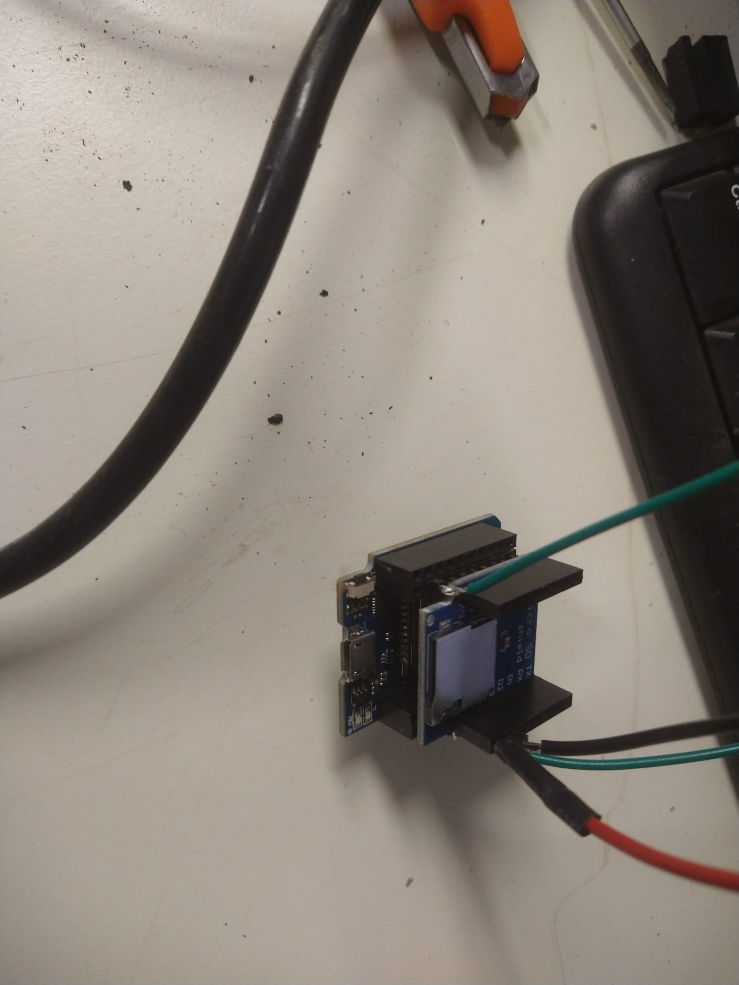

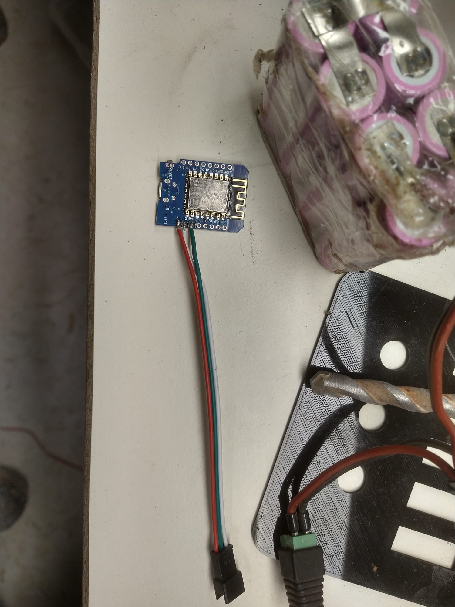

Shouldn’t this be working??
Tried same wiring with extra 5v source for LED and common ground, with no luck.
