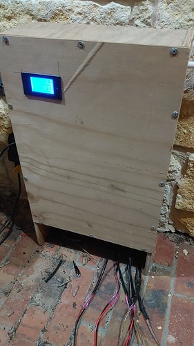

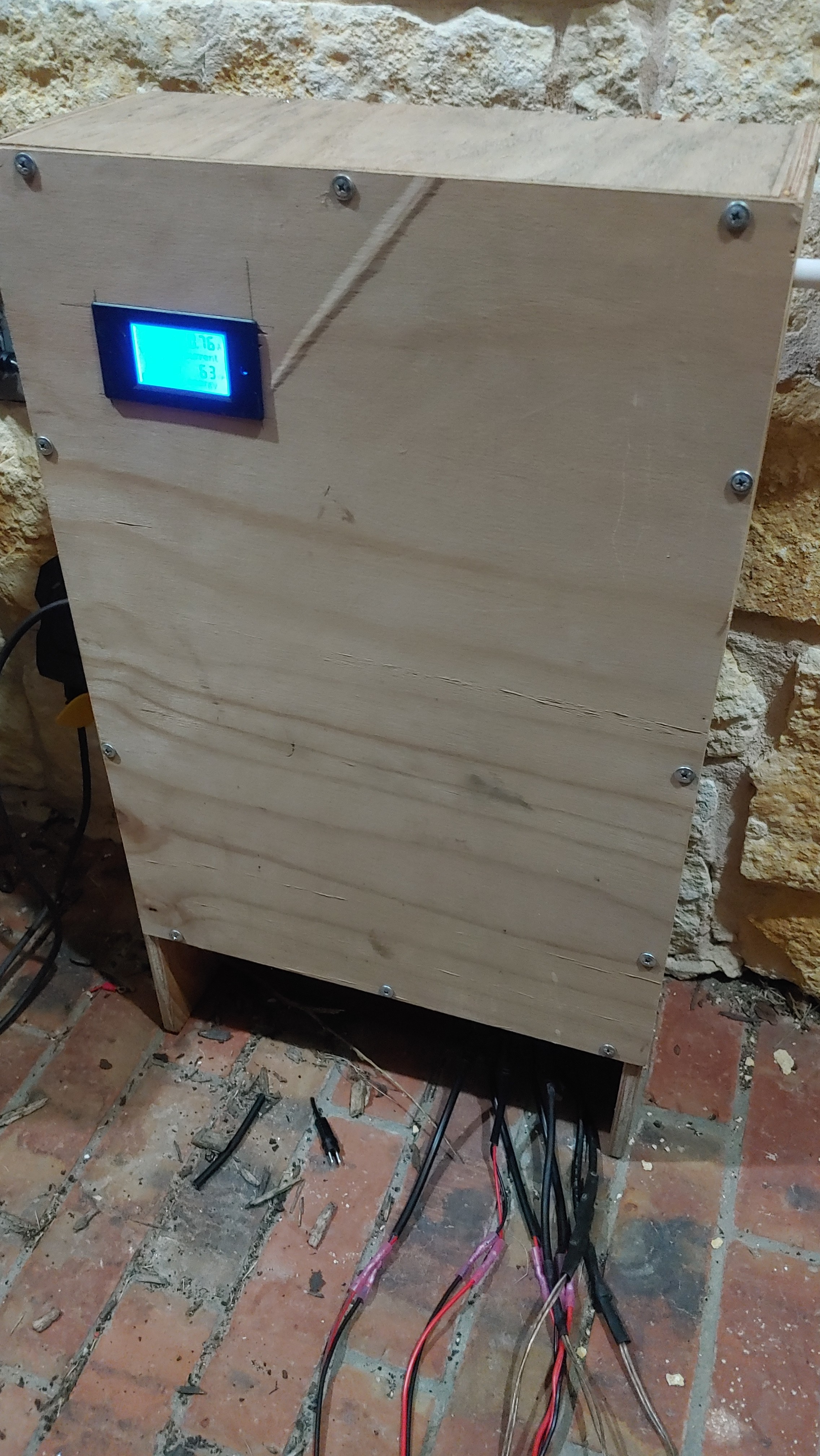

The entire power supply is only drawing .76a from the wall (60w), so it can’t be much.
I built this a few years ago. It used to have a pi zero in it that would turn relays on to turn all the lights on each night, but I removed all that when I started using home assistant.
