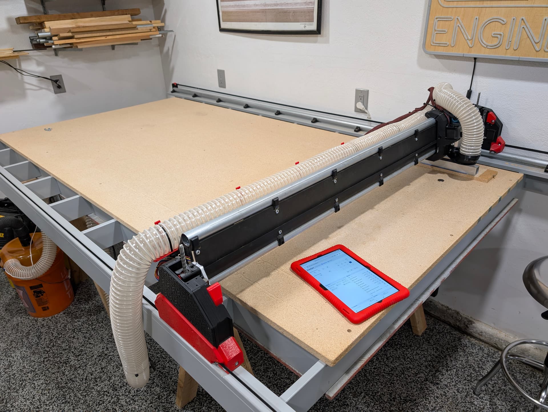

PCB on a full sheet LR

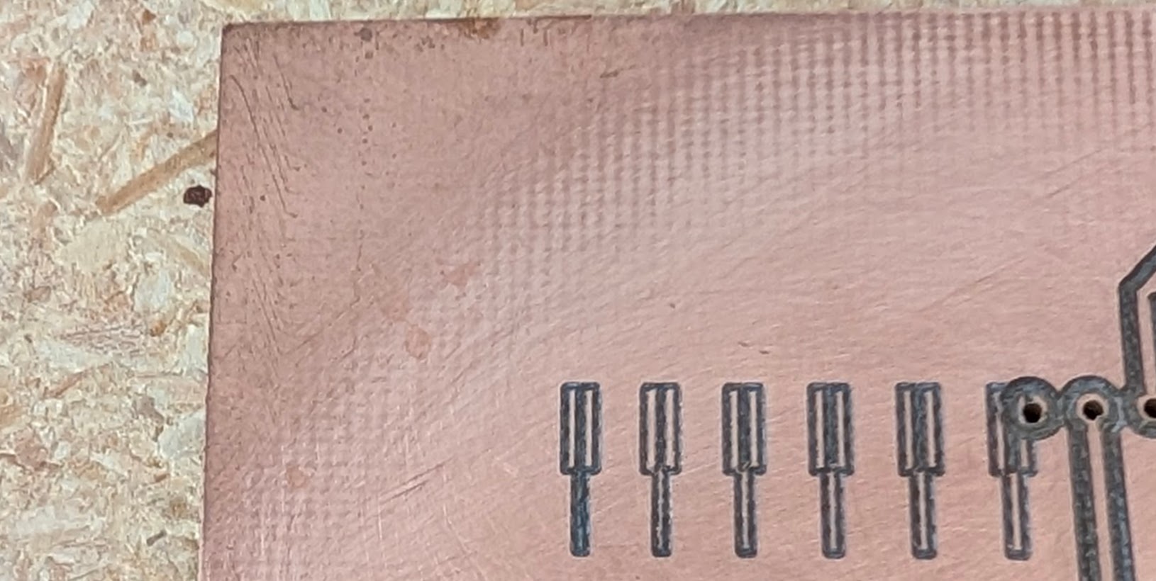

Okay I lied, not a full pcb yet…but getting there.
The left most trace is 0.01" Then up by 0.002" for each test ending at 0.02" (The Jackpot uses mostly 0.0254"). The funky wide trace on the right is from 7-8 years ago on a MPCNC.

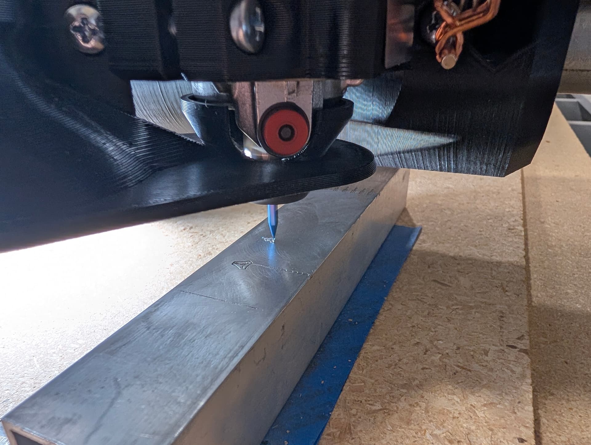

Using a giant CNC to make a tiny test is pretty fun. I learned a lot. I want to clean these up even better tomorrow. I still went too deep.
The trick is inputting the cutter diameter at the final cutting depth. Tool Width Calculator - HobbyCNC, I used a 30 degree v bit and the last test was at 0.08" deep it only needs to be about 0.045"-0.05"(1.27mm). I also surfaced the particle board and used the tape super glue holding method.
I am having a hard time converting the gerbers to a CAM usable file thought to try a jackpot 3 sample.
Current setting is 3mm/s feedrate and 2mm/s plunge. No idea how fast I can push it but that works, I will move faster when I get the depths right.
Wow, really interesting. Did you use a sender, or how did you ensure the LR and the PWB were flat, flat, flat? I’ve never had much success unless using a sender like bCNC that can probe the surface.
No I just surfaced the block I am working on. Maybe it would show more on a larger project.
Probed directly to the surface as well to eliminate any touch plate stack up error.

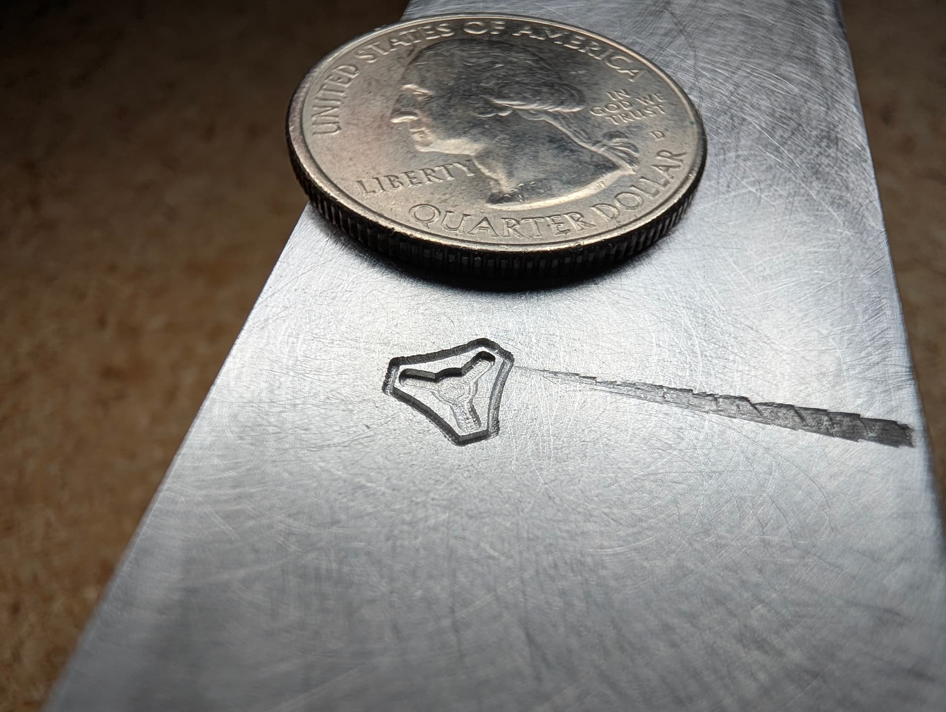

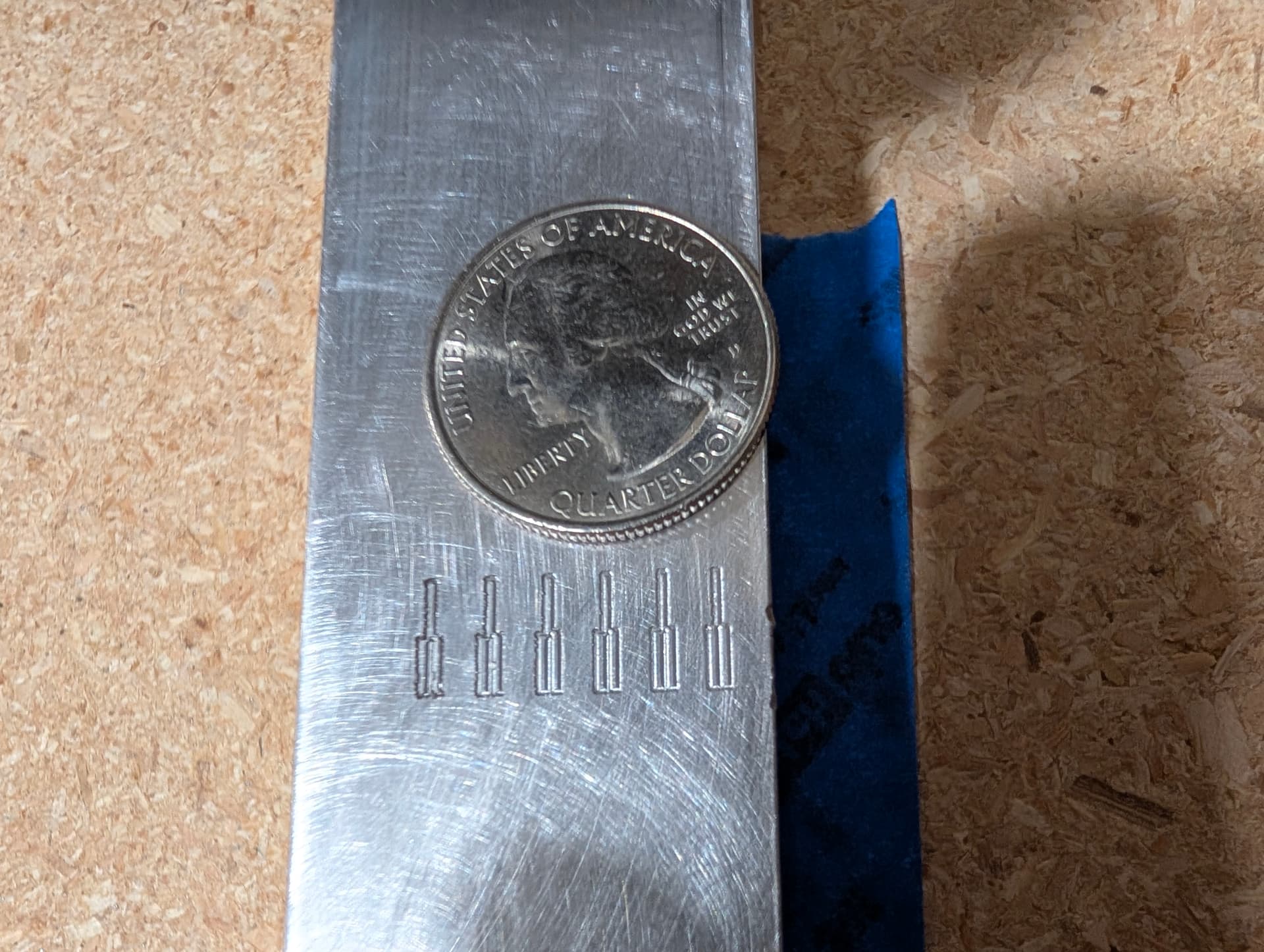

DUDE! 0.3 and 0.45mm deep, 5mm wide overall, in aluminum, on a 8’x4’ CNC. Hilarious!
and…
same file from before.
That will do nicely. DAMN!
There are so many variables with a Vbit, I want to do more test cuts. Mist? How deep and fast can I go? Maybe it is finally time for that belt buckle I have always wanted…

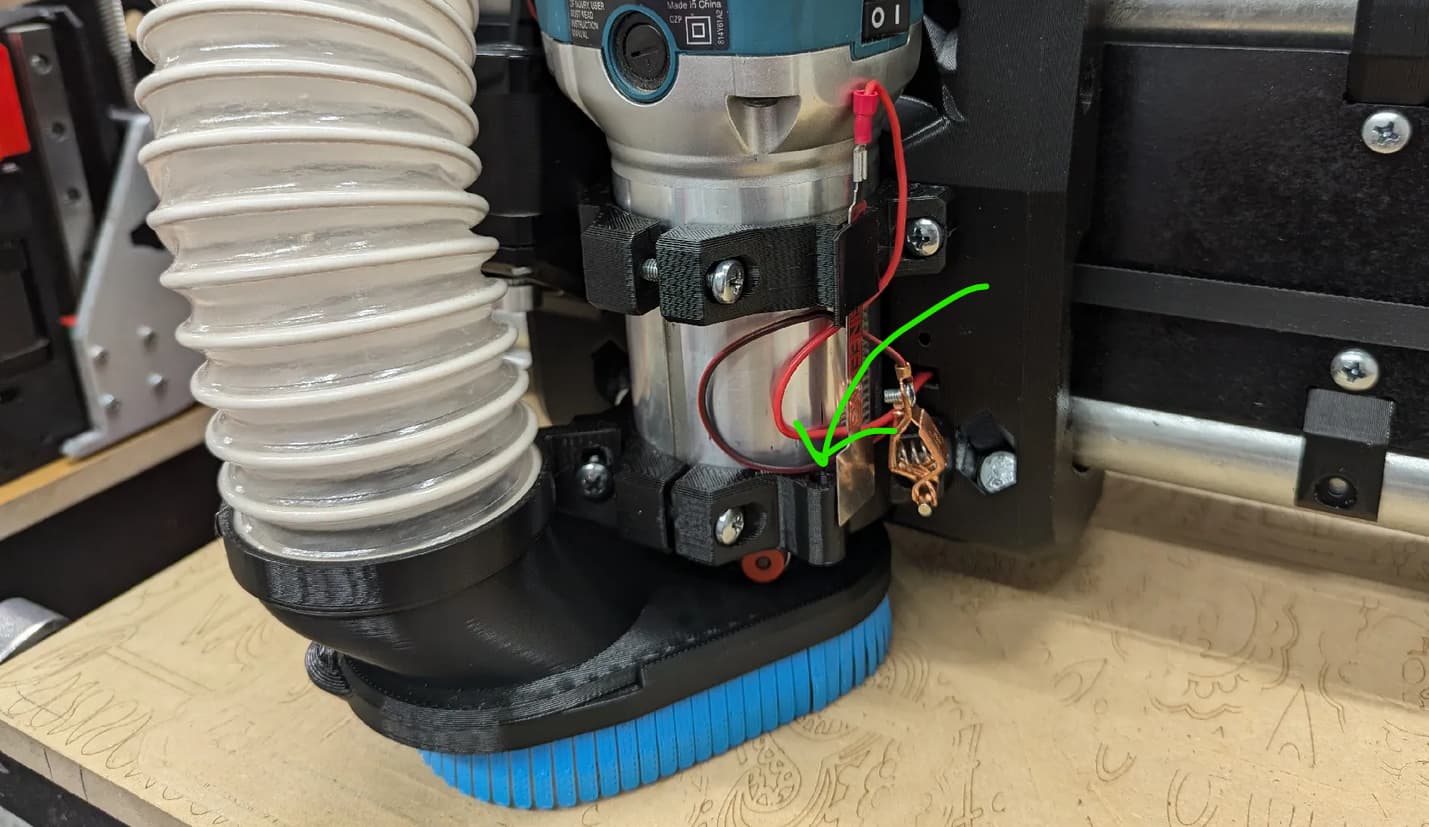

@vicious1 PLEASE make an easy way to attach something like this to the LR4 core. Easily removeable for when not needed would be a huge plus as well
@DougJoseph has already done that…
There is an air-mist attachment available from the original LR3 version.
That is what the extra hole is for on the tool mount.
I can make up a generic attachment and provide the CAD so adding specific tools are easier.
Yes I know. I had that on my LR3. But I would really like to see what Ryan comes up with since he puts little things on the machines with this in mind.

Look closely and you’ll see I snuck a mister on the back left side of the router…
No additional parts, just modded Dust shoe and 2 releasable zip ties. Only made for Kobalt though…
