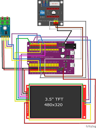

Start by trying to get everything placed in a way that makes sense. You’ll see the lines indicating which pins connect to what, spend time trying to make those make as much sense as possible. You don’t want to have 10 wires going to one thing have to cross 10 wires going to something else if they can help it. Put the effort in at this stage to move pins around, change the positions of components, rotate stuff so it makes sense, etc. Examples would be that the LCD can be rotated 180 degrees while keeping the same orientation, plugs that go off to wires can be pretty much anywhere on the edge of the board but buttons will need to be in a relatively logical location for your UI/UX consideration. Use the flexibility of things that can be flexible, for instance.

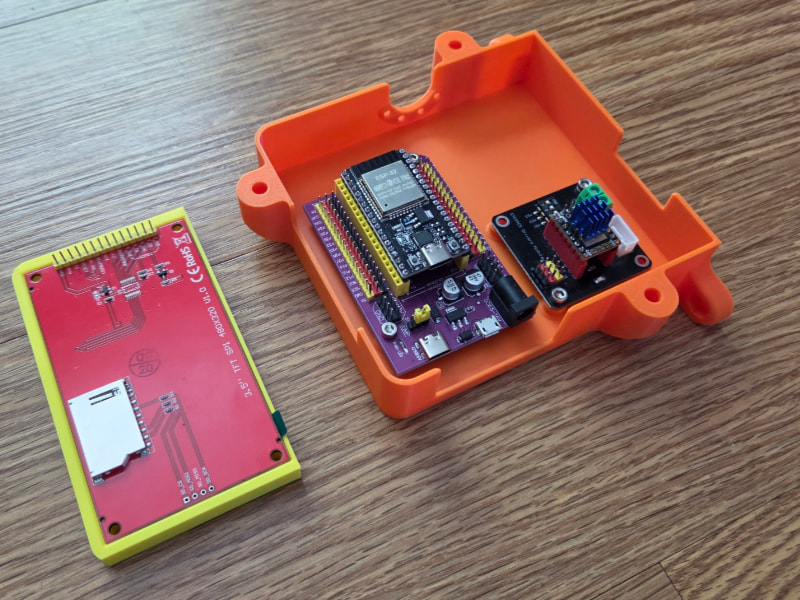

More pins is good, but I’d also say that it pays huge dividends to try to avoid feature creep as much as possible. It may feel good to try make a board that can do everything you’ll ever want to do, but you’ll pay for that in design time, complexity, troubleshooting effort and wasted money if you have to have it remade. Instead, I prefer to just make sure I can connect to any spare pins in some relatively easy way, so I can add some hand wired sections if I need to. In your case with an ESP devkit, you can easily tack wires to the solder joints for the pin headers or even add another interposer board in between yours and the ESP32, so I would be confident you can easily add stuff later without needing to design it in now.
