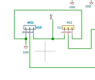

I made my 1st mistake with this project although I kind of expected this. For the breakout board on the genuine ESP32 I bought the pins do not fit. Mine is 25.4mm total width, but distance between pins is 22.86mm. I did print out the circuit board with the part I added from snapeda and that does match the footprint of my board, so not really a big deal. I do have my 38 pin esp32 prototype to play with which has enough pins for what I am currently using it for.
I also decided to simplify this design a little more and use through-hole connections and use a socket BTT standalone TMC2209 driver which I already have several of. What started this change was it seemed like the TMC2226 surface mount component wiring was starting to get too complicated for my 1st board. I was originally wanting to use the TMC2226 because it created less heat and therefore give more clearance for putting the TFT display directly on the board, but then I realized I was not going to place that directly on the board anyway because I was going to use jumper wires from it so I did not really need the low profile.
I found a couple of useful links for helping with the wiring for the TMC2209. I want to be able to set the micro stepping with jumpers for the MS1 and MS2, and this design gave me a good method for that. https://oshwlab.com/aikopras/tmc2209-driver-board and this one helped with the TMC2209 wiring. GitHub - m47812/Custom-3D-Printer-Controller: A fully custom 3D Printer controller board based on an stm32f7 controller with TMC2209 stepper drivers · GitHub I am pretty close to getting the schematic done and have been updating the PCB as I add different components but have not routed any wire on it yet because I have not really placed components very well. I have the size of the board at 120mmx80mm and probably can make it smaller.
Yeah, that’s a common one, and why I recommend printing out the design and literally placing the component on it. With some extremely complex footprints and extremely expensive PCBs I’ve done almost an entire assembly into the paper PCB sitting on top of a piece of styrofoam or cardboard before. Things like this bastard:

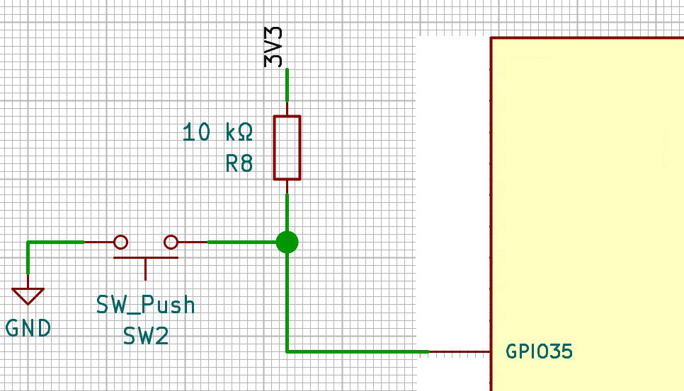

Button 1 35
Button 2 36

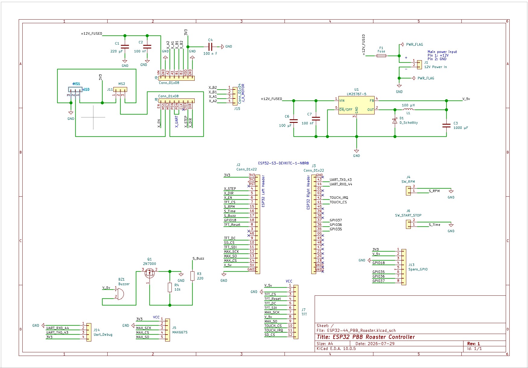

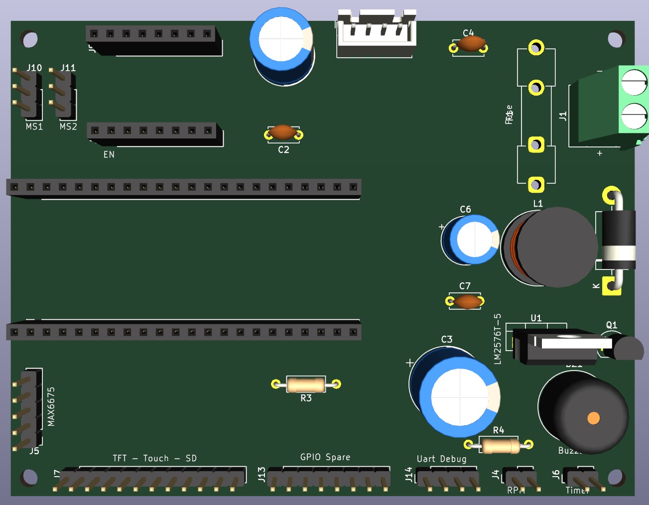

This is where I am so far. I might just stay with the 44 pins as it does give me some more flexibility of extra pins if I want to test something I have not thought of yet. I might add the reverse polarity and 12/24v but have not decided that yet. I have the board size down to 105mm x 80mm. I left space at end of ESP32 as it hangs over the pins about 10mm and space behind the buck convertor in case I need to add a heat sink.

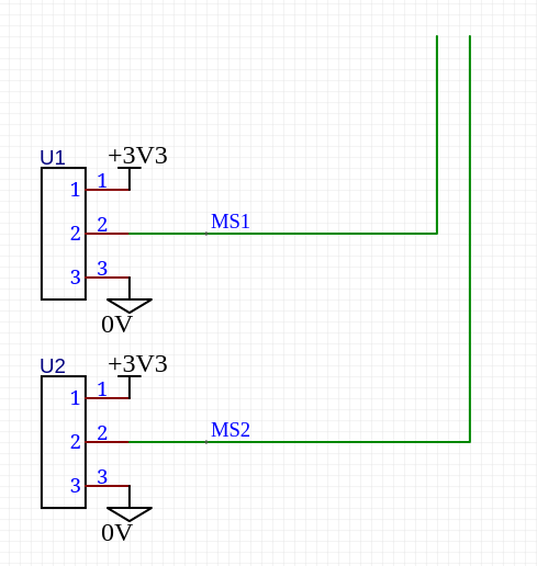

If you’re supplying it from something like a 12V/2A power supply, you won’t be able to actually blow that fuse so it might be a bit unnecessary. If you’re using a battery, it’s a good idea, though.

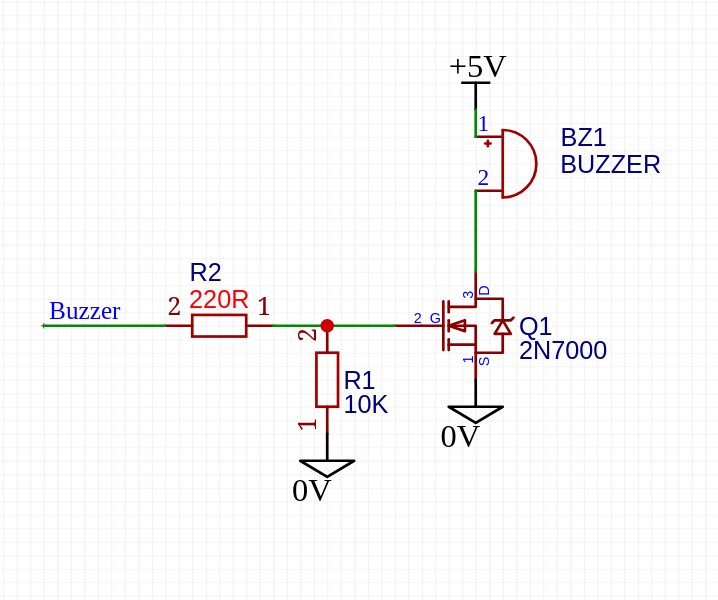

For that bit, I’d just use a 3V3 and GND net name for each pin like this:
That gets the idea across while keeping extra lines off the schematic. It also aligns things a bit better and avoids going ‘up and around’ that connector, which makes it simpler to trace with your eyes. I’d also use what EasyEDA called the NetFlag up in the wiring tools instead of a netlabel.
Adding netlabels for all the nets also helps to make it more obvious what you’re actually routing on the PCB. I try to have every net labelled unless it’s just a short stub between two components or something like that. Every net that actually heads out from a connector would be labelled, for instance.
If you’re doing it all through-hole, are you going to assemble it? If that’s the case, I wouldn’t worry too much about adding extra resistors. Normally I’d have them everywhere, like in those MS1 and MS2 lines just because it helps avoid something like the wiring being wrong from blowing stuff up, resistors in the step/dir lines help slow down edges and reduce EMI, etc. I guess the thing is, adding ~30 resistors in a SMT design that someone else is assembling is easy. Adding 30 resistors in a through-hole design that you’re doing by hand is a pain in the ass, so maybe not.
I’d rearrange the Q1 section, too, to look a little more like this:
It makes the arrangement a little more obvious. The ‘logic’ of the circuit is flowing left to right. The FET is in a ‘normal’ orientation, the pins are in roughly the right places relative to their voltages (lowest voltage at the bottom, highest towards the top etc.). The pull-down resistor is obviously a pull-down, that kinda thing. A lot of stuff like this is just convention that takes a while to get used to, but it helps A LOT. We’re really good at pattern matching, so there’s a lot of mistakes that we can spot in seconds just by looking at something and going ‘that looks weird’, before we’ve even identified what the actual issue is. Drawing something in a non-standard way means you’ve gotta trace all the connections, I had to look super closely at the FET symbol to know which side was the source, I had to look specifically at R4 and go ‘ok, 0V on one side, gate on the other, so that’s the gate pull-down…’, etc.
For the circuit around the simple switcher, I’d typically use separate net flags for each component to make it a little cleaner, but that’s just my preference. I also typically try to avoid 4-way ties like the one on the 0V connection of U1, just because that’s another of those things that make spotting errors easier. If wires cross and never connect, an accidental connection immediately jumps out as wrong, and there are definitely times when you’ll need to cross wires.

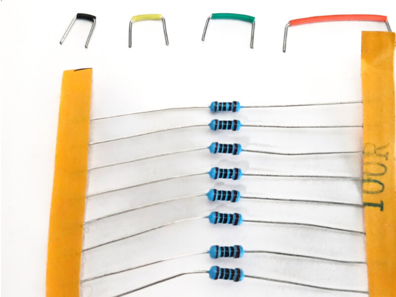

Both 0R resistors and wire links are a common technique when using single sided board but shouldn’t be needed for most basic double sided designs, given you can go to the bottom layer to get around/under things.
Those breadboard holes will be on 2.54mm/0.1" pitch centers, so the jumpers will presumably be multiples of that.

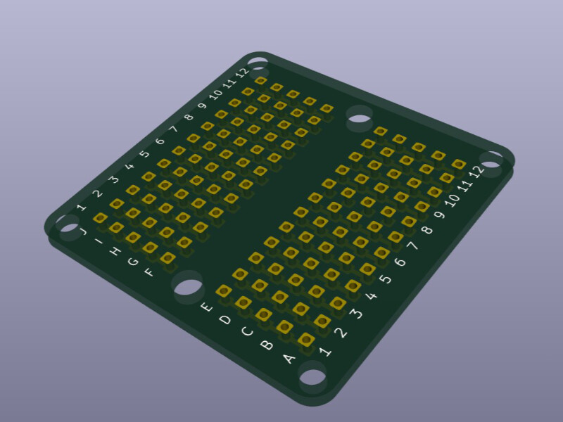

I thought these Mini PCB Prototype Boards might be useful, so I bought some and decided to play with KiCad Footprint editor and created a smaller 12 row board. I was able to create the whole board in the footprint editor. This one is 38.1x38.1mm in size. Thought I was going to use one of these boards to bring all the jumper wires from the top of the case to a central spot before jumping them to the ESP32 board but probably would be better off making a custom cable with an 8-pin DuPont connector on one end and the individual DuPont ends on the other. I need to practice my crimping skills. I do have crimp tool for these but have had limited success in the past. Here is the Amazon link for the Mini PCB board I bought. Amazon.com: ElectroCookie Mini PCB Prototype Board Solderable Breadboard for DIY Electronics, Compatible for Mini Arduino Soldering Projects, Gold-Plated (6 Pack, Multicolor) : Industrial & Scientific
Here is the one I designed and is a little smaller. It was kind of fun to design and simple. The rows of pins are tied together like breadboards.

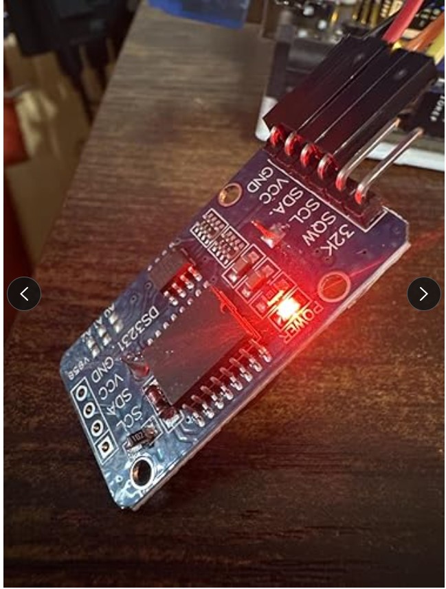

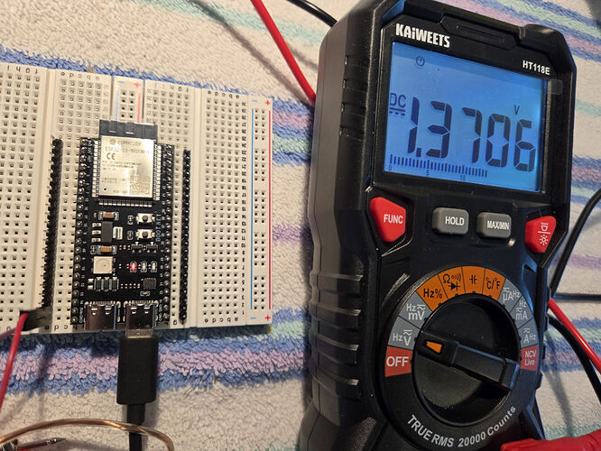

I am adding a real time clock to my prototype as I did not want to mess with Wi-Fi for Date/time. I was out of pins on this 38-pin board, and I needed 2 GPIO pins for the RTC, so I had to move the 2 buttons to read only pins. I wired a pull up 10k resistor for each button like this and it does work. For the buttons I am using GPIO34 and GPIO35. My newer board that the custom PCB is designed around does not seem to have any read only pins, so I won’t need this pull-up resistor on the custom board.
I used this YouTube video as verification to how to wire this up as I did not trust ChatGPT.
This DS3231I bought from: Amazon.com: 2PCS DS3231 AT24C32 IIC RTC Module Clock Timer Memory Module Beats Replace DS1307 I2C RTC Board with Male to Female Jumper Wire Cable : Industrial & Scientific also seems to have a charging circuit, but since it has a non-chargeable CR2032 battery looks like I need to disable that by pulling up the resistor as shown by one of the reviewers of that part in attached photo. Does this look correct?
The schematic posted doesn’t match the board so it’s tough to tell. There shouldn’t be anything connected from Vcc to the battery. From looking carefully at the pic that person posted, it does appear that there’s a trace going from Vcc to the 1K resistor, to a diode and then to the + terminal of the battery, which is quite the fire hazard…
In a ‘proper’ DS3231, it should draw basically nothing from the battery while it’s supplied via Vcc and cannot back-feed into the battery as a safety consideration.
There’s zero chance this is a proper DS3231, though, and who knows what’s going on. Maybe there’s a ton of leakage on that pin so they’ve added the external resistor to supply that, or maybe the chip doesn’t do Vcc supply properly so they’re doing this as a hack way of supplying from both.
That board design is also utter garbage, but oh well.
I’d lift it or just clip it off the board with pliers, personally.

The schematic was a screen clip from the ESP32 that I am using on the custom board which does not match the board I am using with the Read only button which is probably what you meant by not matching the board. I should have just had GPIO35 listed and not part of the outline.
I tried to just raise one end of the resistor but ended up just pulling the whole resistor off and it went flying in the shed somewhere. That is the 1st time for me desoldering a surface mount component and did accomplish the same thing. After desoldering, I put the battery back in and reset the time. I will check the time on it in the morning to see if it is still correct.
The schematic from the Amazon link.
Yeah, it’s not really a good idea to try to lever the resistors up like that. You really need to have both joints flowing to remove a component. My preferred approach as a simpler option is to put a bit of extra solder on both ends and then use a larger iron tip to try heat both at the same time. Alternatively, you can try to wick all the solder off one side and lever it up a little, but any kind of mechanical stress on the component can end up ripping off pads and damaging the board. In this case if you know it doesn’t need to get put back then it’s not like board damage is an issue…

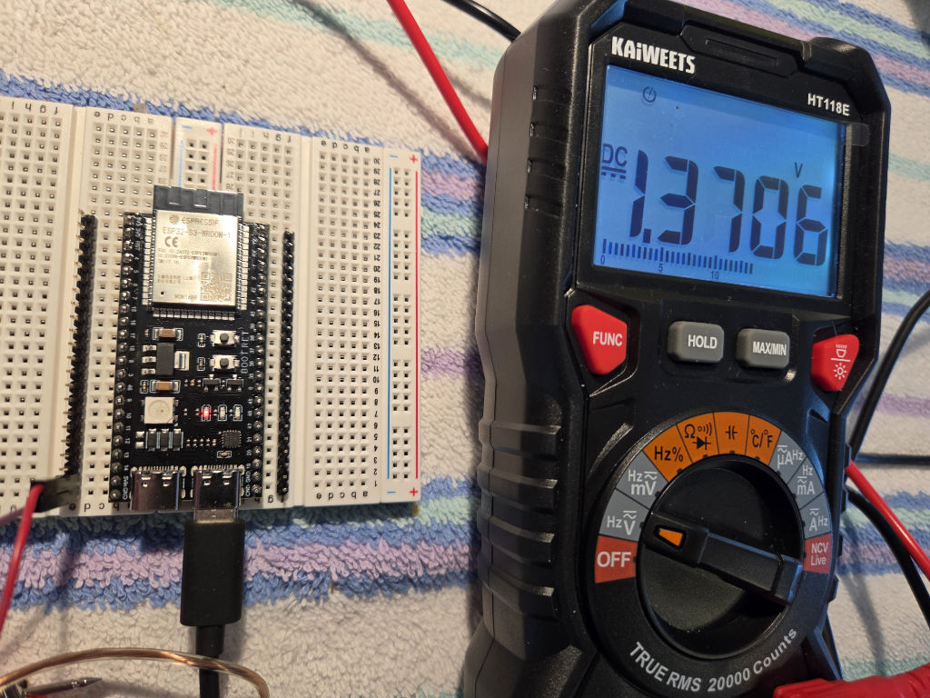

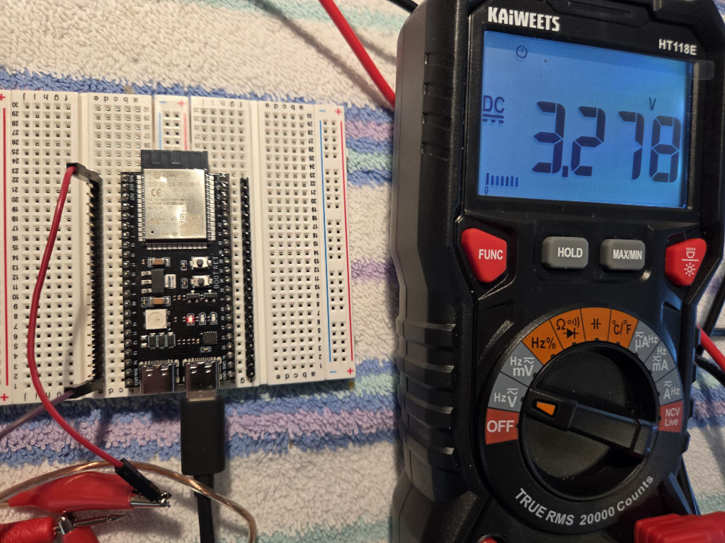

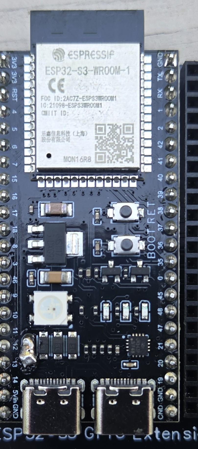

I got the 44 pin ESP-S3 clone with breakout board. I got the clone with it since I suspected my real ESP32 board would not fit and I was correct. The big problem I had with this new clone board was it measured 1.37v on the 5v line and 3.3v on the 4 pins on the breakout board that are supposed to be 5v. After contacting seller, he said those boards don’t support 5v output. He said I had to bridge 2 solder joints to get 5v. Now why didn’t they just do that to begin with since it is clearly marked as 5v on that pin. My soldering on that small a spot is not pretty but it did work and I now read 4.7v on all the pins labeled 5v. I also got the same voltage no matter which USB port on the chip I used.
The shield apparently got dented in shipping but does seem to work ok.
And here is my ugly soldering bridge work. Think I have a smaller soldering iron tip, but could not find it today.
