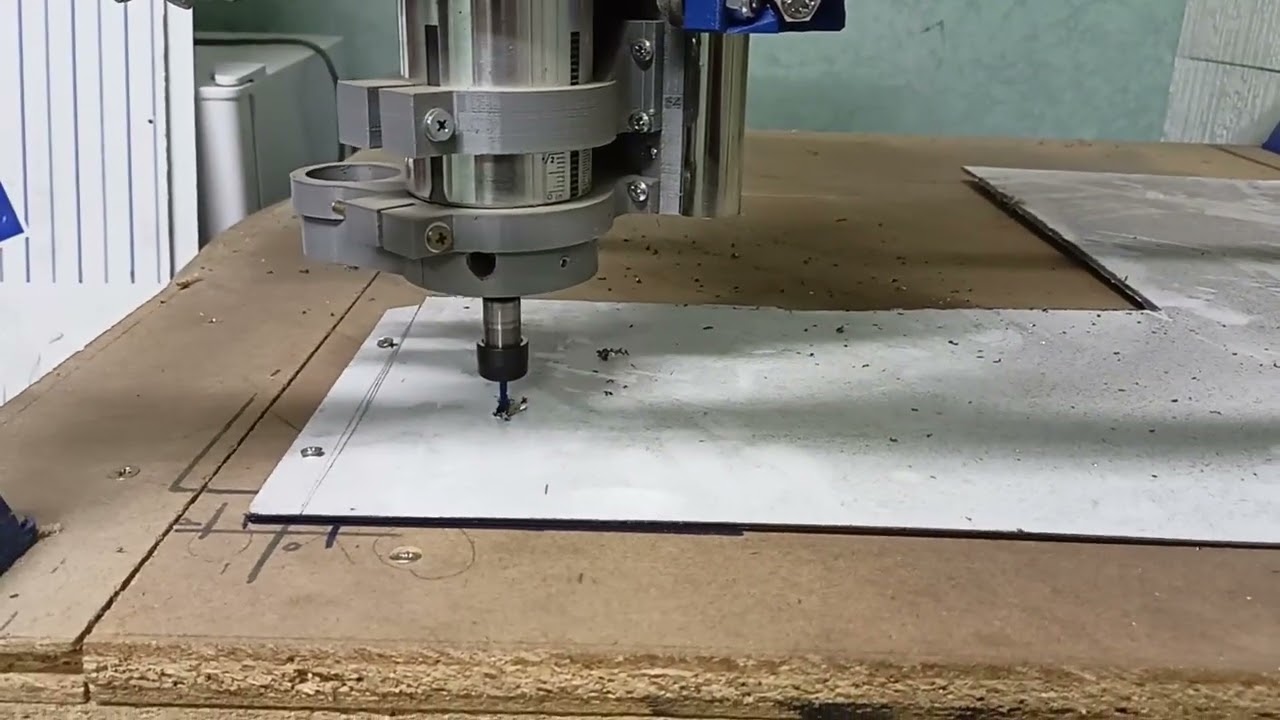

Today I wanted to cut 3mm dibond (aluminum composite) and it was a disaster…
I used a 1 tooth flute at very low speeds (I tested between 150mm/min and 700mm/min)
I also tested in a single pass of 3mm depth and in several passes of 0.5mm
The MPCNC cuts well but the dimensions are not good at all…
For a 100mm wide part I get 96mm which is very imprecise
What do you think?

I won’t be able to check the machine until tomorrow in the meantime I have uploaded the videos I made if that helps you
I use repetier and estlcam
But when she cut the wood the dimensions were good, it’s only when I cut composite aluminum that it’s strong (we see it in the video)
I will check the pulleys etc.
wood:
Aluminum composite:

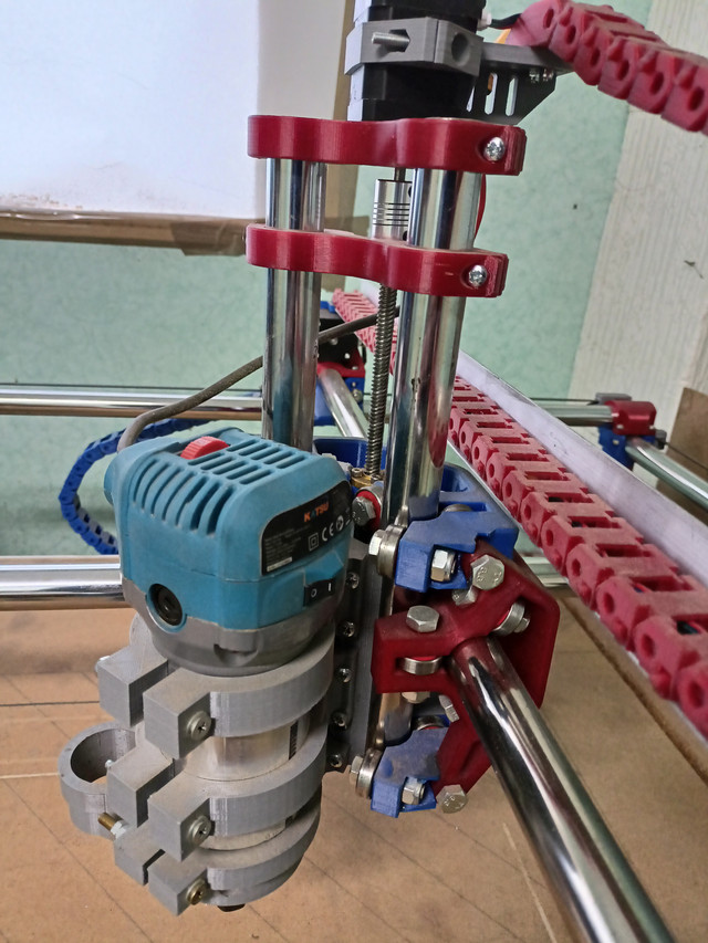

Okay so today I went to look at the mpcnc I checked all the pulleys and bearings and everything looked good…
But by looking I understood the problem I think…
I built the machine quite high and above all the center of the machine is very high and therefore when the machine cut the wood without force the dimensions were good but when I tried to cut the aluminum composite it had to be forced and with the The leverage effect created my wrong dimensions (96mm instead of 100mm)
I think the best thing is to reprint the machine in its new version by making it lower especially in the middle
In addition the new version looks more rigid on base
It’s only a problem if the feet are very high. The Z-axis does not mind being long as long as it does not go down too much beneath the core.
Yes you are right, what maximum height in z would you advise me?
And do you think I should build the new version that came out afterwards?
Is it much more rigid?
Because otherwise I can only cut the feet
I’d start with cutting the feet, no need to build a new one.
