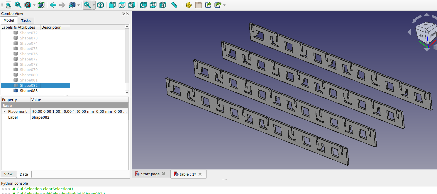

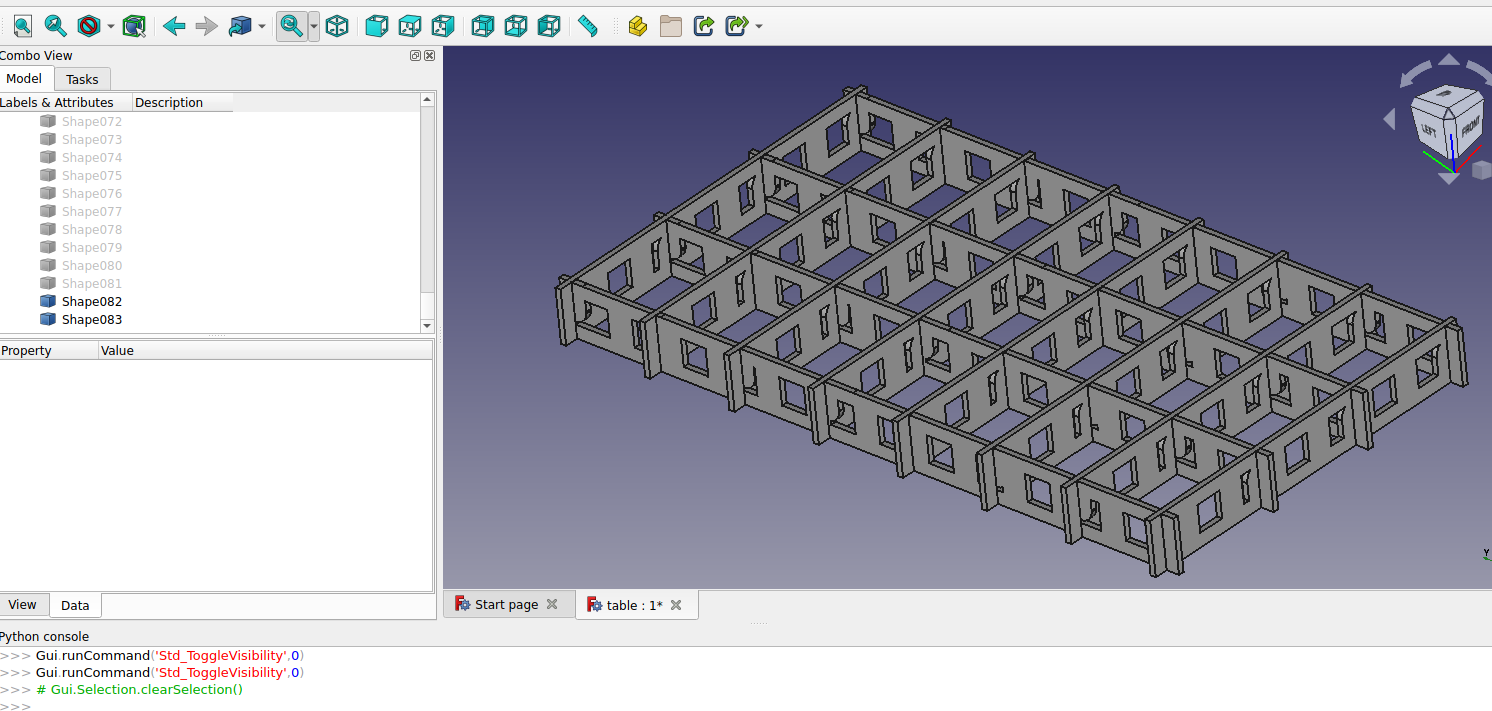

Parametrized lowrider table
Hi all
I’m making a python script in FreeCAD which would prepare gcode of struts aimed at a light table.
The notch don’t match the stiffener for now because it’s taken from a more complex surfboard slicer, but that can be easily changed.
Shitty or useful ? I’d be keen to hear from wiser people before investing more time
I like the idea! What I always contemplate is whether it would be possible to make pieces you can fit together to make the table smaller or larger on the fly.

I’m also looking for an idea for the final table of my LR3 which for now is installed on a temporary solution.
If I may allow myself some suggestions, I would say that:
  • to shorten the milling times I would only make 1 hole between two joints, maybe even oval instead of rectangular.
  • on the two sides Y I would like to have a double support to reinforce the two lateral tracks (on the principle of Ryan’s table I did some learning today, tramming - #42 by vicious1)
    With this solution it is also possible to level the supports before applying the work surface, thus avoiding tramming of the entire spoilboard
    But this is just my thought.
    Thanks for sharing
Allright thanks for your valuable feedbacks! let me see what I can come up with…
