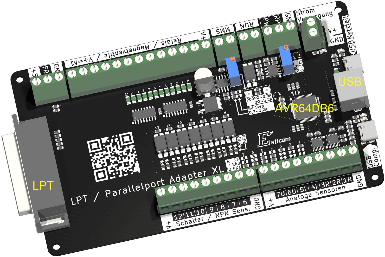

I recently picked up a Windows 11 pc that miraculously has a parallel port card. I have a couple of parallel port breakout boards from older systems, intended for use with Mach3 and similar setups.
Is it possible to use Estlcam with the parallel port breakout boards, or does there need to be some processing capability between Estlcam CNC software and the breakout board? Does Estlcam CNC send only g-code to the GRBL and XL boards, or can it be configured to send step/direction/spindle signals on specified parallel port pins?

EstlCAM (the controller part) runs on embedded hardware, not on the PC. The EstlCAM CAM app can talk to the embedded controller, but the motion control part isn’t running inside the PC.
The parallel port adapters you see for EstlCAM controller setups, as I understand it, adapt the embedded hardware such that it can drive stepper setups that were originally designed to work with a PC. (e.g. if you have electronics that used to connect to a Mach 3 PC, you could instead connect that electronics stack to through the adapter to the EstlCAM embedded electronics. ) EstlCAM the CAM and gcode sender, would still have to talk to the embedded hardware.
All of which is to say: My understanding is that having a PC with a parallel port isn’t of any help running EstlCAM.
Now, if your existing parallel port breakout boards have the electronics on them to drive a stepper chain, you could plug them into an EstlCAM controller using an EstlCAM parallel port adapter and potentially make use of them that way. But again, that wouldn’t in any way hook up to the parallel port card in your PC.

Yes. The USB cable you normally use only streams the gcode to the board. That’s it basically.
Using Estlcam for motion control only works with the Estlcam PC controller interface/sender > USB > Estlcam controller firmware on ATmega328/2650 (e.g. Arduino) or AVR64DB64 (new Estlcam boards) microcontrollers.

But, as Maker Jim said, PC Estlcam > USB > Estlcam firmware > parallel > machine is an option, e.g. w/ an Estlcam LPT Adapter.
