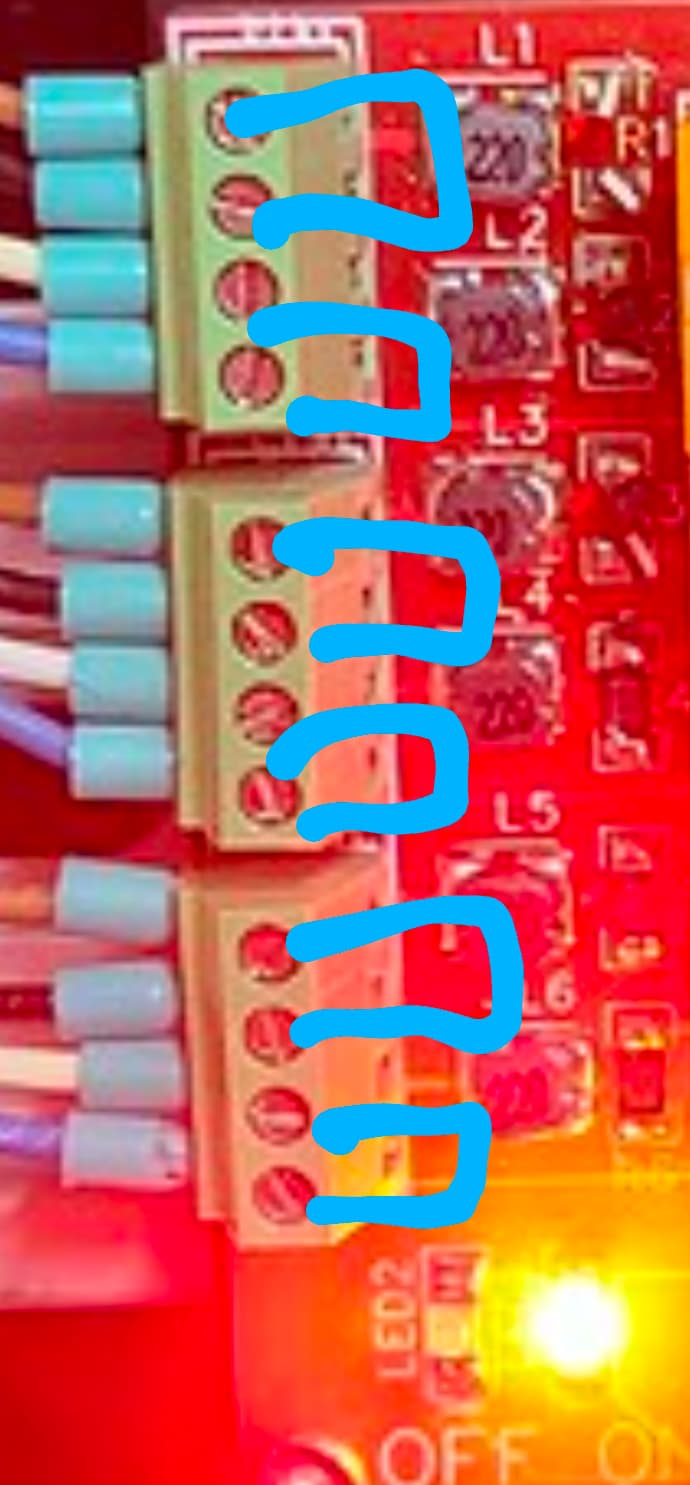

Orob's Z-brakes board for the belted z bed

So I cleaned out the broken parts and put jumpers in across the terminals. Now I have 2 that ā€œsort of brakeā€ and one that doesn’t. I am wondering if my bed is too heavy for it to stop once it starts.
Don’t worry about the resistors, I am going to order another board. Having some other issues now. Will be way easier in the long run!
Verify each channel actually shorts without power by ohming where the blue marks are:
Maybe replace all the resistors with shorts and make sure the jumpers are shorted for max resistance.
Im perplexed how those would break and stand on end like that in the photo. The resistor value was chosen to mock a motor coil resistance. The prototype I’m using on my lr4 z axis has a straight short and i had to creatively sequence the power up so it doesn’t fault and alarm.

New board came today. Checked it and it looked great so I installed it. Works exactly like it should!
Pulled the other board and checked the terminals like you showed above. Some show shorts some don’t. poking around a little more I feel like you had a bad solder day that day! Not a problem on my end. It might be a reason for me to invest in a reflow workstation so I can do SMD in the future.
