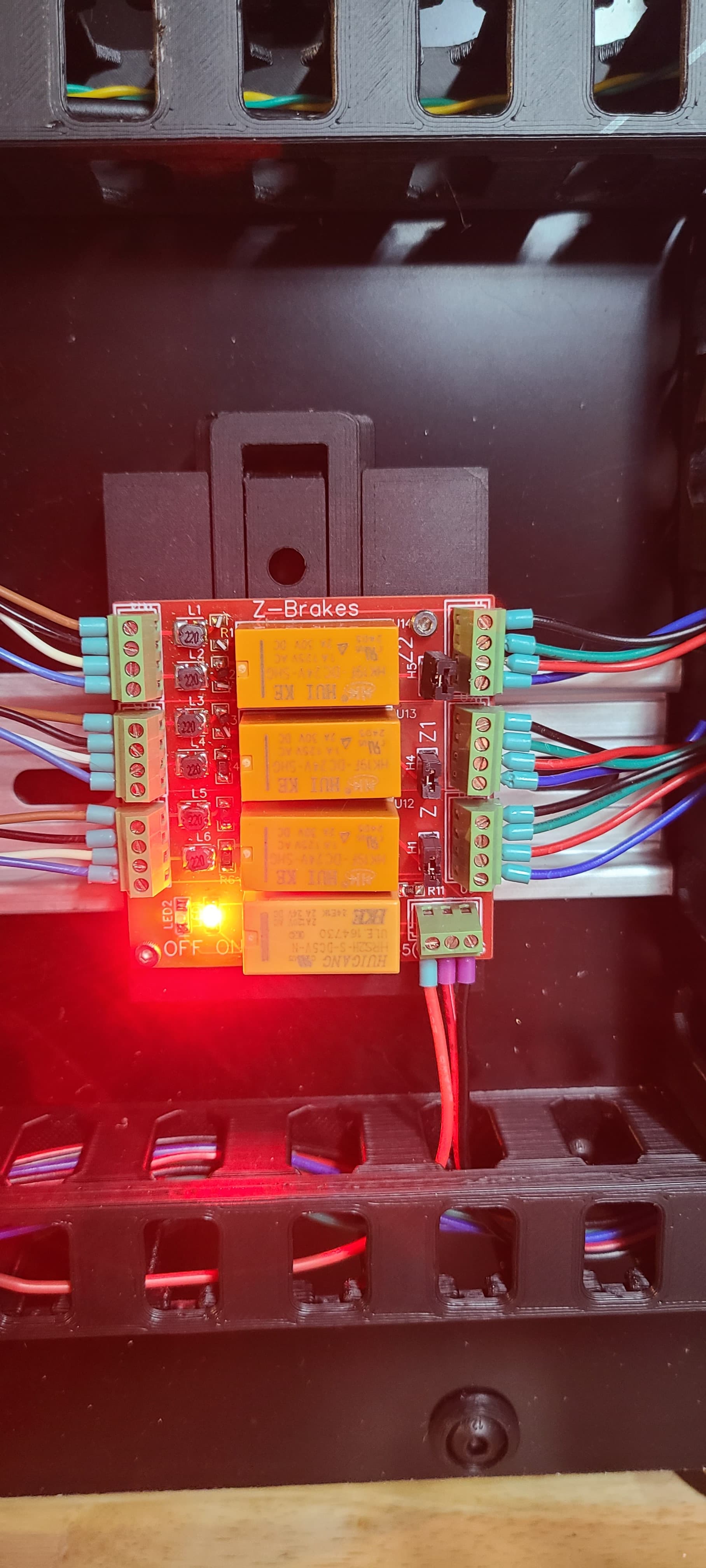

I can not seem to get my Z brakes working correctly.
I have power to the board. When I first hooked up the motor wires before I hooked up the wires to the M8P it seemed to be working. After I connected every thing it stopped.
I have a red light saying they are on bout there is no change in how the motors move by hand. before they were quite stiff.

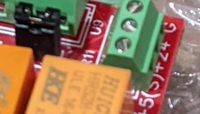

The board is powered by a 24v nd 5v power with a shared ground. The labeling threw one person off and it cooked the 5v relay coil. Lets verify power input first.
that 3 pin connector is +5V (S) is for board switching signal, +24V and then GND. the font on the silk screen didn’t fit right. the relays will normally be closed and will short the motor coils until powered.

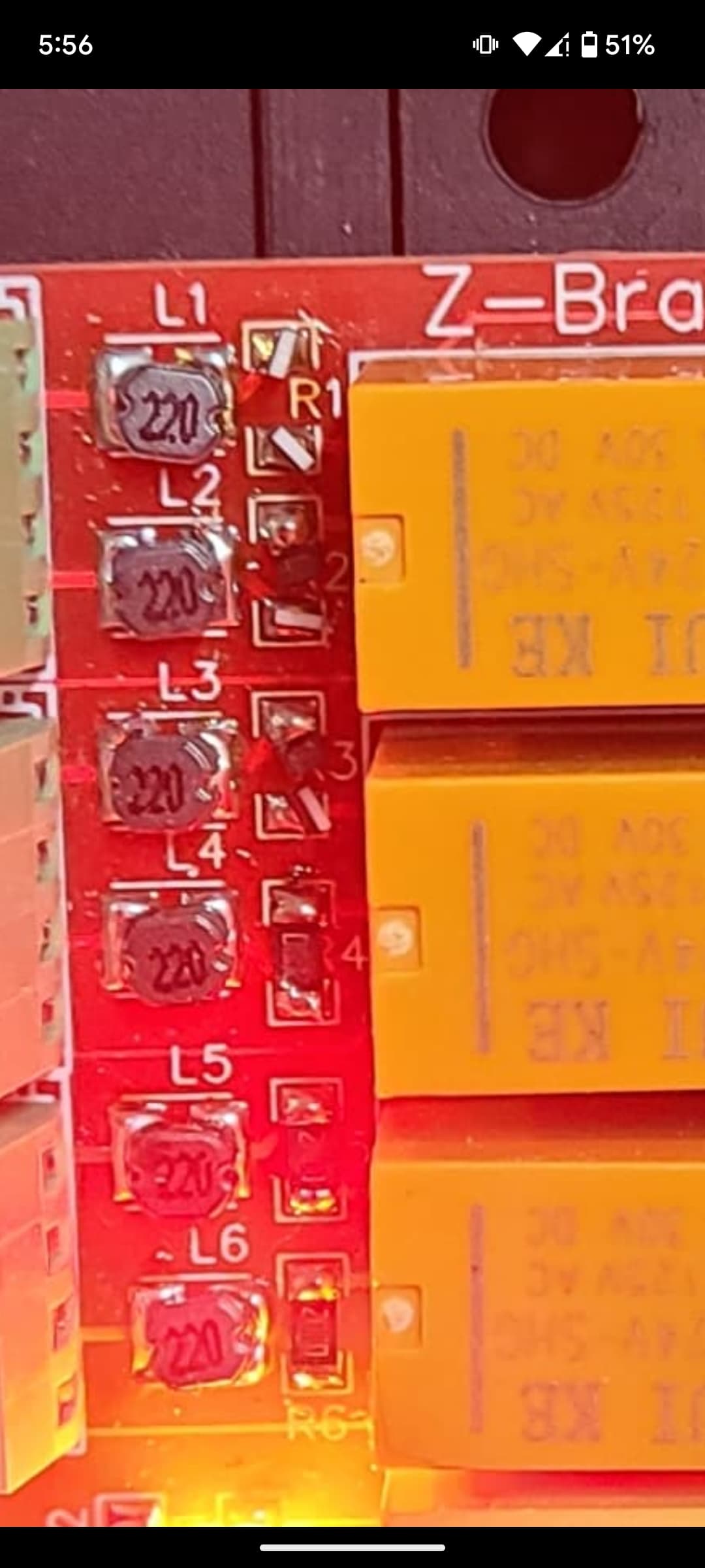

I am mostly concerned that the issue is in my wiring. I have it wired to pass straight through in order. I believe I asked somewhere and was told the board was bidirectional so it should not matter which side the motors are connected on? When the red light is on my motors still move freely. Matter of fact it will home this way also.
The standard colored wires go to the board and the others go to the motor.
ETA: I disconnected the power and signal wires to the brake board and the printer moves as normal. My understanding is that it should not do that correct?

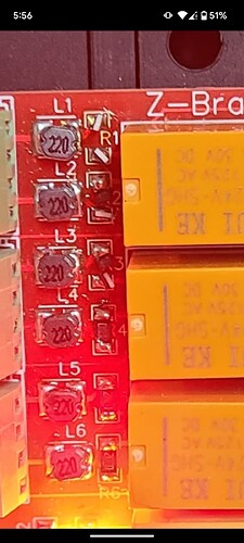

ETA2: If I short the windings with a jumper on the screw terminals the motor locks up. I have a feeling there is something wrong with the relays or the board itself.
The short has a resistor and an inductor in series to trick the 2209 if it tries to power while shorted.
Looks like r1 and r2 are broken and missing on your board… Left of the relay… Those parts were hand placed and individually soldered by me. Looks like R1 tombstoned on both ends and the center resistor section is missing. Should cover the R1 silk screen. If you bridge those with a shunt wire. It will work. I can send you some resistors to replace those if you want.
@vicious1 can you send a picture of a new board showing the resistors next to the relays?
Also. Relay avtivation pins should NOT have ! In front.
