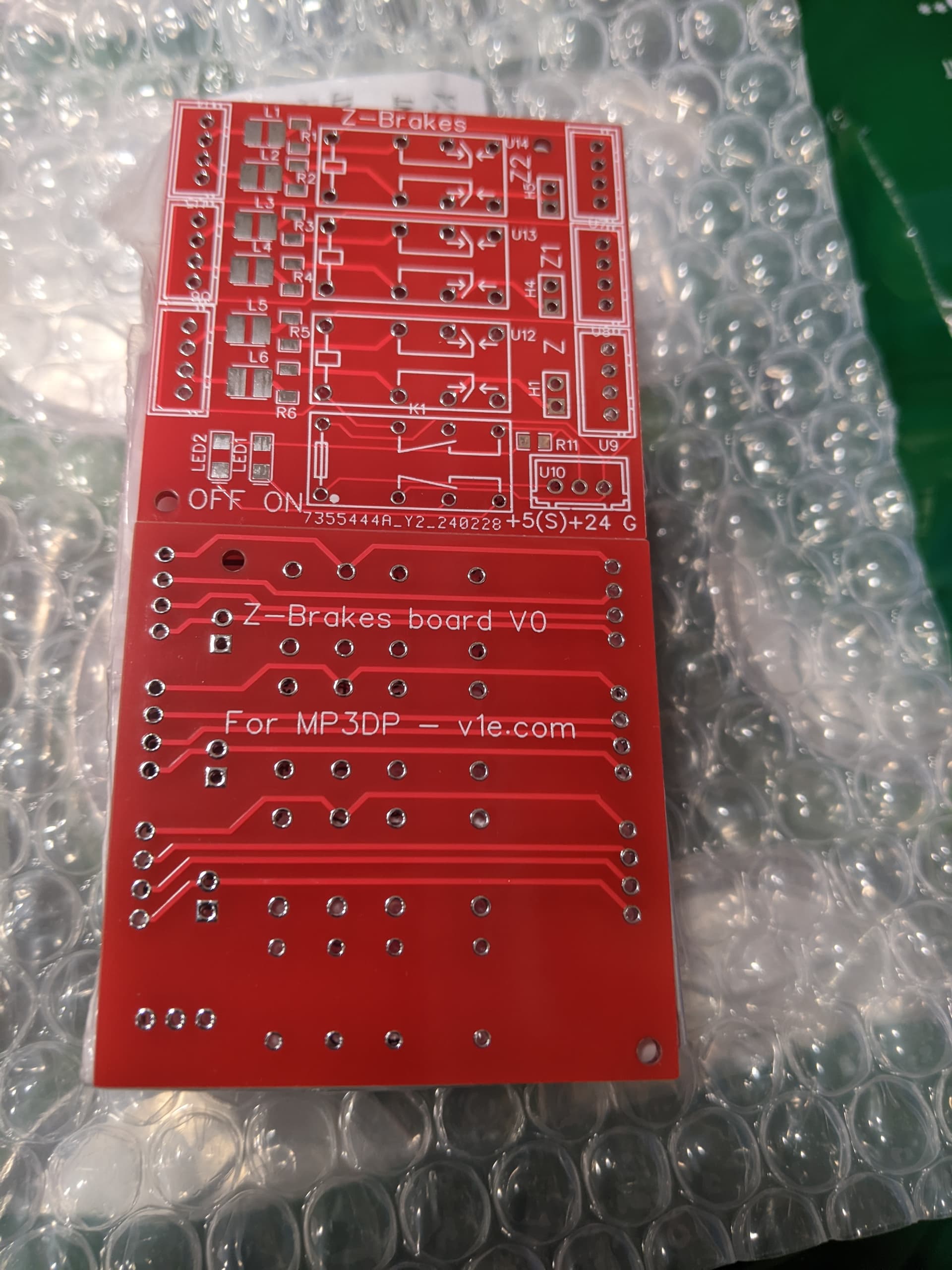

Great questions. I can provide a response here for most that we arrived at thanks to input from several other users and some of my testing:
  1. Function: A brake can be applied to a stepper by shorting a motor coil to itself. Each stepper (nema17 that we use) has 2 coils. By shorting one coil, it increases the resistance to freewheeling. A single motor short will be a rougher movement and produce a louder response and vibration when the motor moves compared with shorting both coils to themselves. A brake short does not lock movement, it merely slows movement and isolates the coils so a flying heated bed wont blow your controller on descent.
  2. Basic setup: brakes wired with relays positioned normally closed so the coils are normally shorted will default to brake ON when not powered. In klipper i custom selected pin state on boot in the firmware and used a uart tx pin that did not have a pullup resistor on it to ensure the desired state is retained for all states of the controller.
  3. Two major challenges were 1. activating when the drivers activate. This was solved by the suggestion to use multipin in klipper so it flips the relay pin when the tmc is activated for the z axis. 2. if the z motors are powered immediately then sometimes the driver would fail for a short. So a resistor similar to a motor coil and an inductor were added to the short wire to “approximate” a motor coil and the driver didnt complain.

I know the theory behind it, I was mostly curious on the exact operation of the board, lets say our 2 coils are A1 and A2 for one coil and B1 and B2 for the other, does the board short A1 to A2 and then B1 to B2 (without shorting A and B) or does it short A1 to A2, B1 and B2?

So the pcb disconnects the drivers from the steppers as well?
I might need a little more insight on what it exactly does though, from my understanding, if no power is provided to the board, the stepper phases are shorted.
But since we have only 3 relays from the looks of it, that means we short both phases together instead of shorting each individually right?
All the produced circuit board does is relay switch a two-layer set of relays to short motor coils and provide fake coil circuits for when the driver might error if it is a direct short.
The first relay layer the 5v relay triggered by the board pin. That first relay switches the second layer of relays that run off of 24 volt power that also feeds your motors. The 24v power then goes to the relay coils that switch the motor shorts. Your 36v power would require different relays for the second step.
If your motor power drops or your board logic power drops then brakes are activated.
Power out condition defaults to brakes are on.

The brake circuit board can optionally short both coils (a2->a2, and b1->b2) or just one with DPDT relays. Where the single channel relay boards only do one (SPDT) so there is one for each motor, but the double brakes would need 2 more relays…
The board.
Thanks for the in-depth explanation, just to make sure: ORob's Stepper Brakes – V1 Engineering Inc would short a1-a2 and b1-b2 with no connection between a and b.
as for the 36V: is the 36V only relevant for the 24V input or also for the 4 pin stepper pass through (I have a dual PSU setup, so my motion system runs on 36V while the rest is 24V, so supplying 24V to the board itself is not an issue[well depending on how much it draws as my 24V psu is rather close to its limit])
Thanks for posting the image btw, that helped a ton with understanding the circuitry

The brake board only works if the coils are shorted to themselves and in that configuration the short protects against back emf on the descent.
I suppose if all the wires were shorted together the motor would function in braking mode, but no idea on if the driver could handle that.

You could make one with all 5v relays…
It can handle 125v on the stepper wires. It is the relay power switch coil that is limited to 24v.

Since I cant really seem to figure out the datasheet of those relays too well, how much amps can they handle on the stepper wires?
https://a.co/d/g1cf3vT
1 amp it appears…
