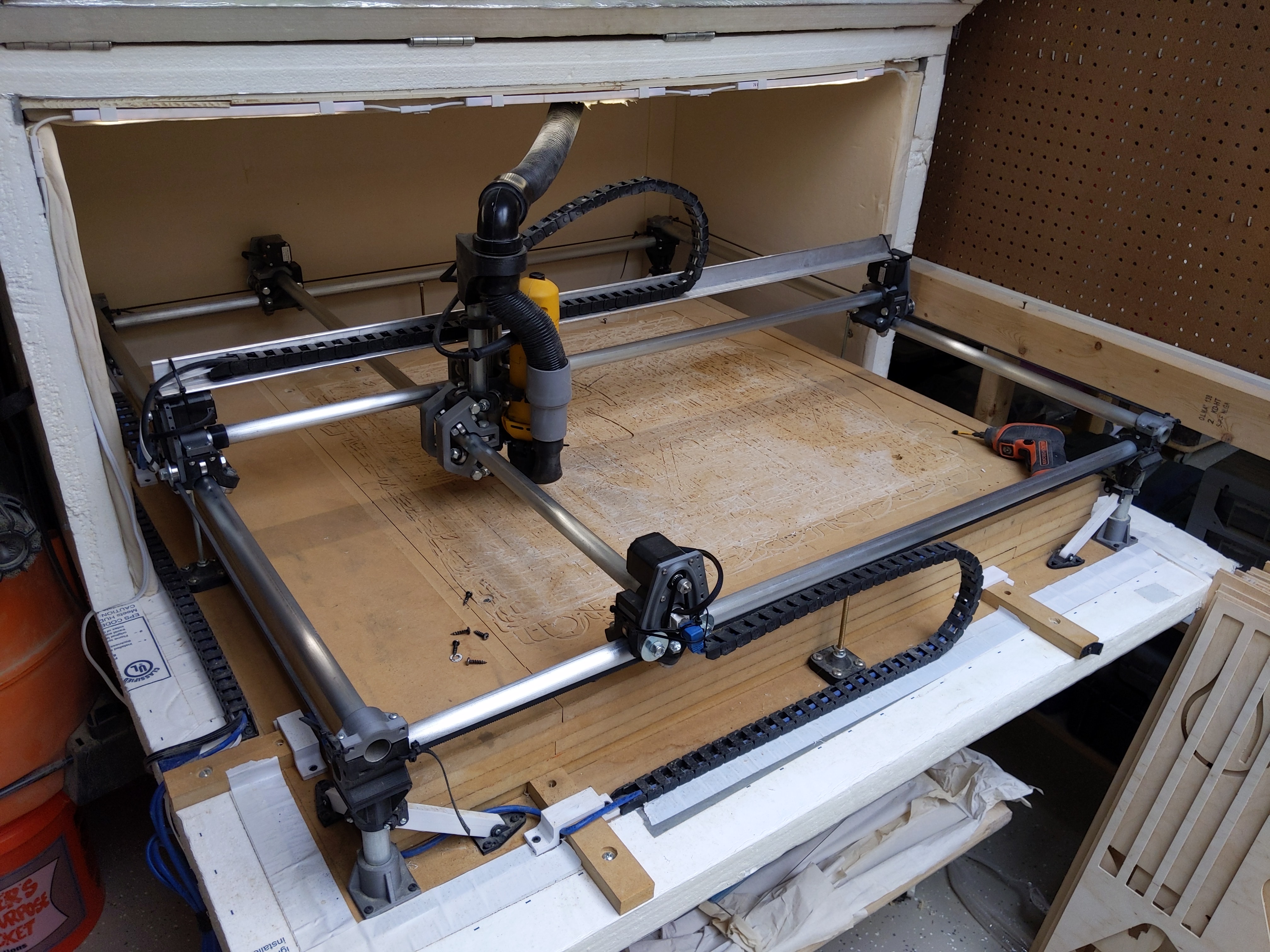

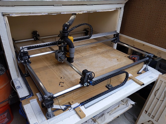

I’ve been using this MPCNC build regularly for years with great success (Ramps w/ RC7 firmware). Here are some pics of my build:

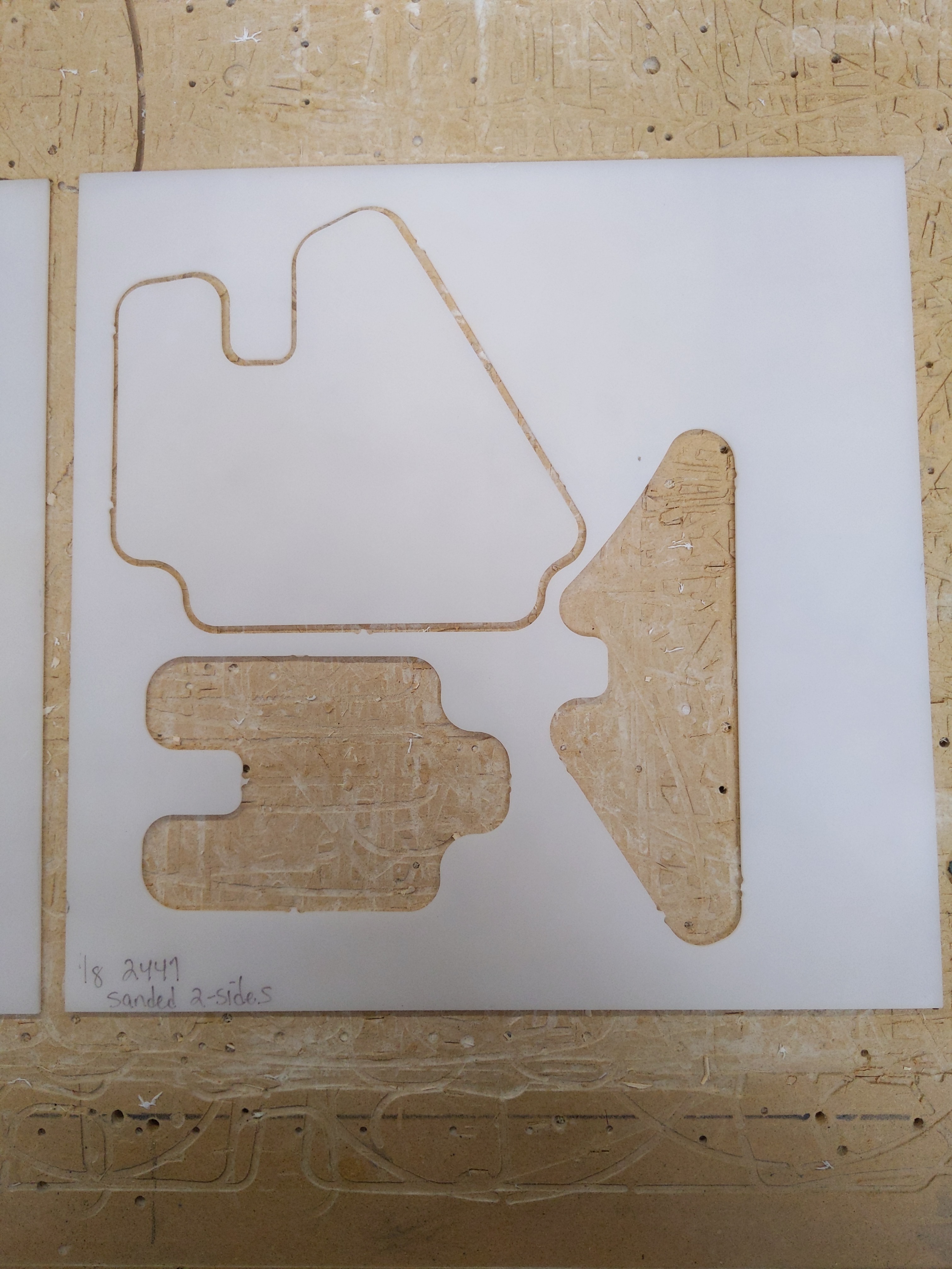

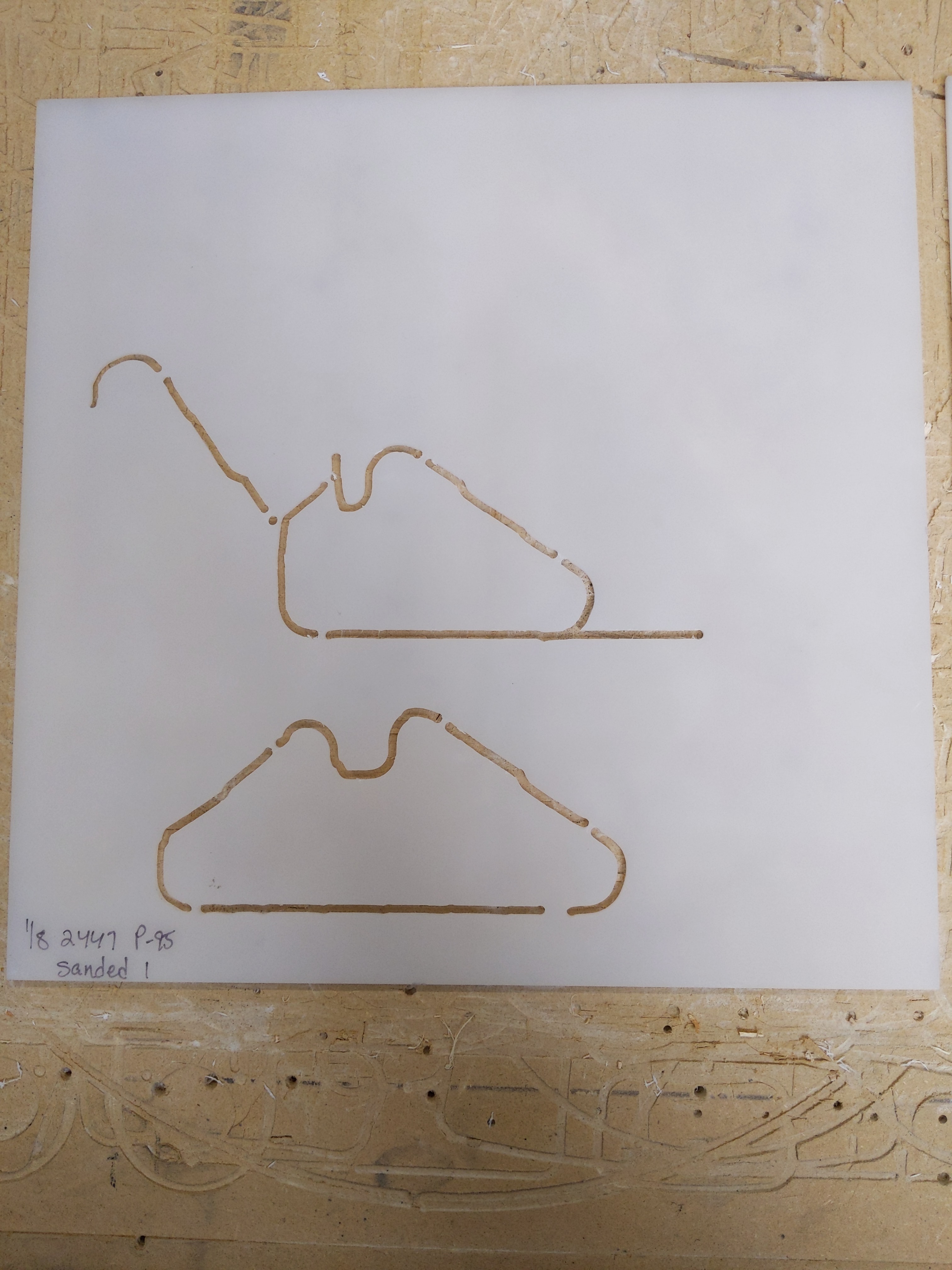

I just tried re-cutting a file from ESTLCam (via Repetier) that cut great a few days ago - the result was a poor quality cut with (I think) missed steps and inaccurate curves. First, here’s a proper cut from a few days ago:
I’m cutting 1/8" acrylic using a single flute 1/8" carbide bit at 10mm/sec with a single pass at 4.25mm deep at full speed w/ a Dewalt 660. These are tried and true settings that I’ve used for years. Here’s the screwed up recut:
Watching the cut, I noticed the router wasn’t moving smoothly, it appeared to be skipping steps and jerking at moments. I tried going back to 1/8" ply since that’s the most forgiving material I have:

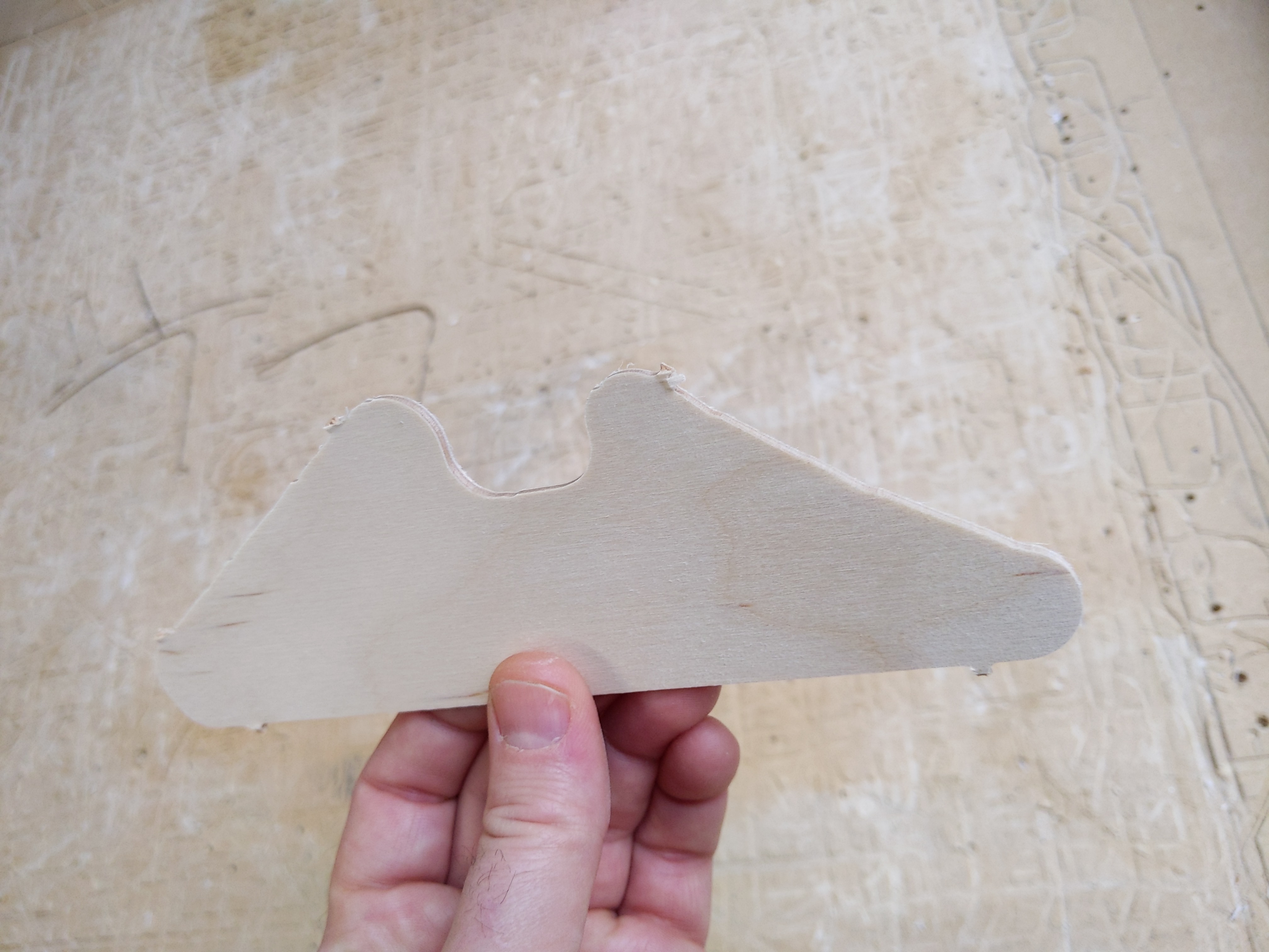

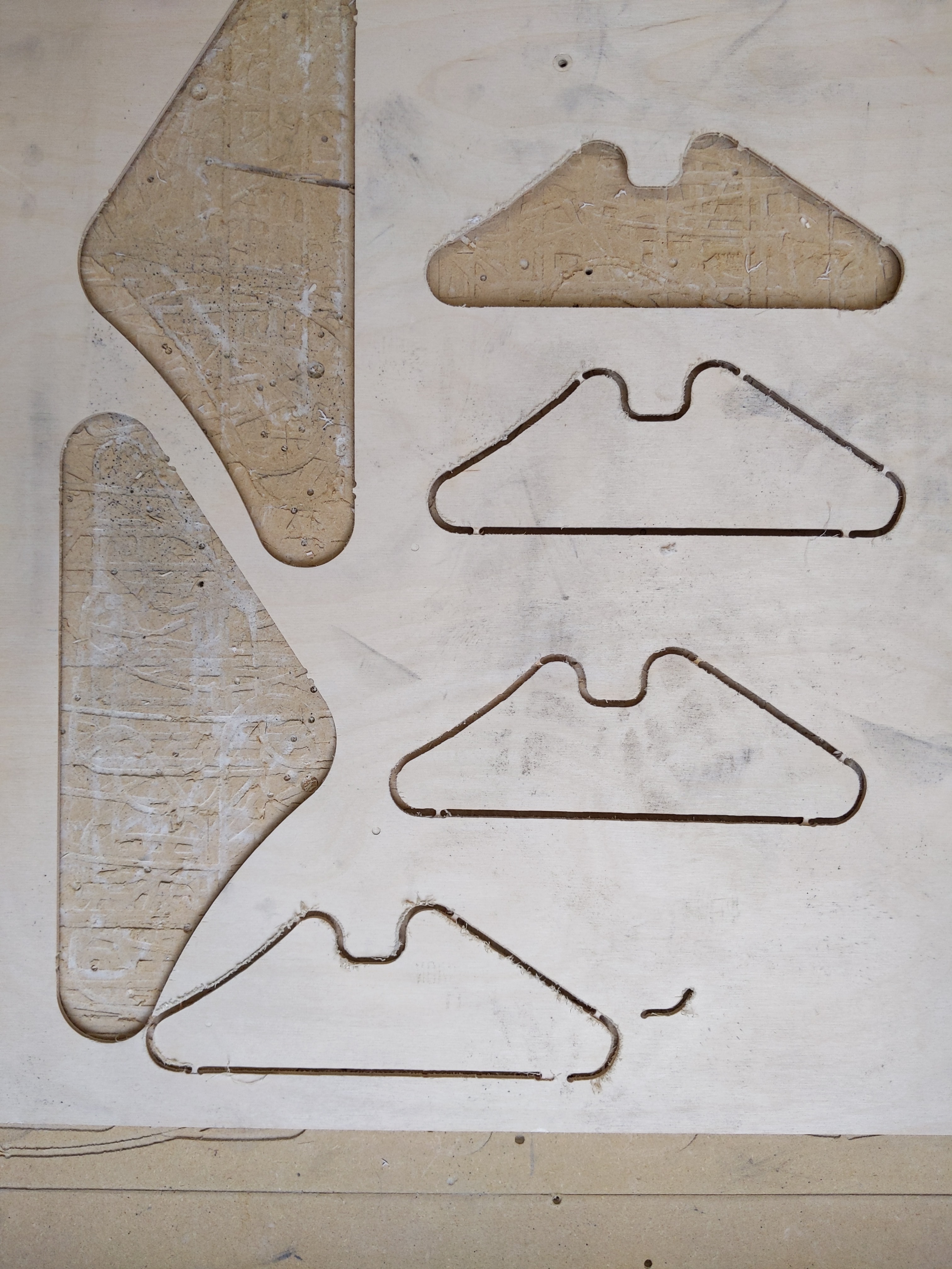

I looked up similar posts on the forum and made adjustments the the machine while recutting the same file. From bottom to top are a series of cuts as I made the following adjustments:
  • tightened bit in the collet
  • replaced bit with new unused bit
  • cleaned bearings + conduit w/ scotch pad
  • cleaned electronics of dust
  • checked for loose wiring
  • tightened DW660 in the mount
  • tightened all grub screws on stepper shafts
  • reflashed firmware
Here you can see the most recent cut (after all the above efforts) where the edges show jerky movement where it should be a smooth curve.

Well you have had that OG MPCNC a very long time. So awesome to see such an early version still going strong!.
At this point it could be any number of things. Bad stepper connection, broken part, or belt inner strands broke (hard to spot).

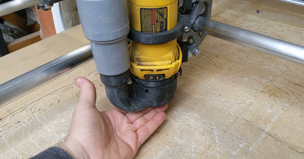

Does the router wobble now?
Primo time?
Oh man - I just finishing building the LR2 a few weeks ago. I’d rather get some more mileage about of this one if possible. I don’t mind rewiring the steppers if it comes to that - at least the wires prior to the RJ45 connections - I believe those are solid. Is there a way to test the wiring/steppers? Just want to make sure I’m not missing something before going down that hole
My belts are tight but yeah i dunno if the inner strands broke. I think the spindle is pretty stable:

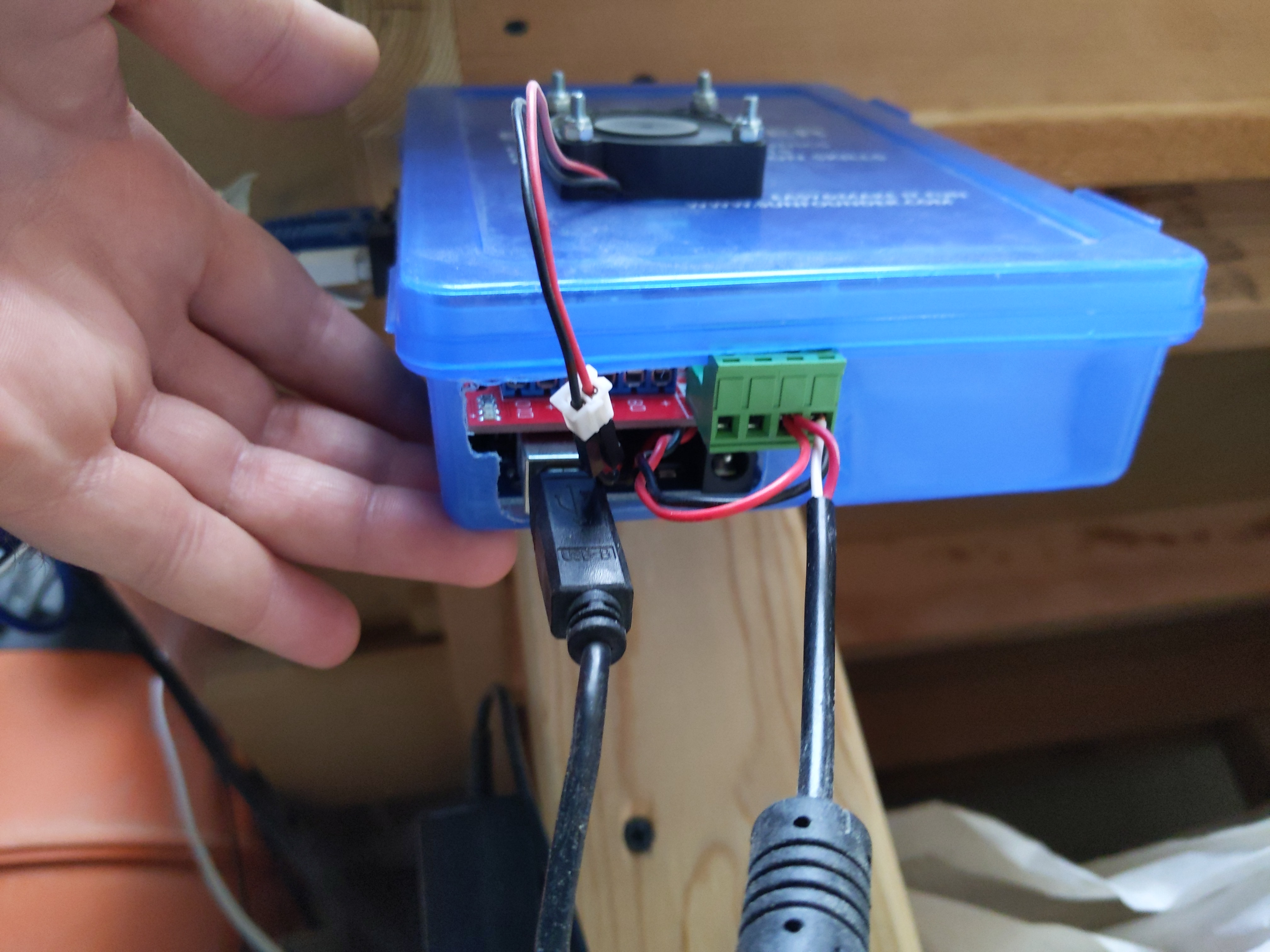

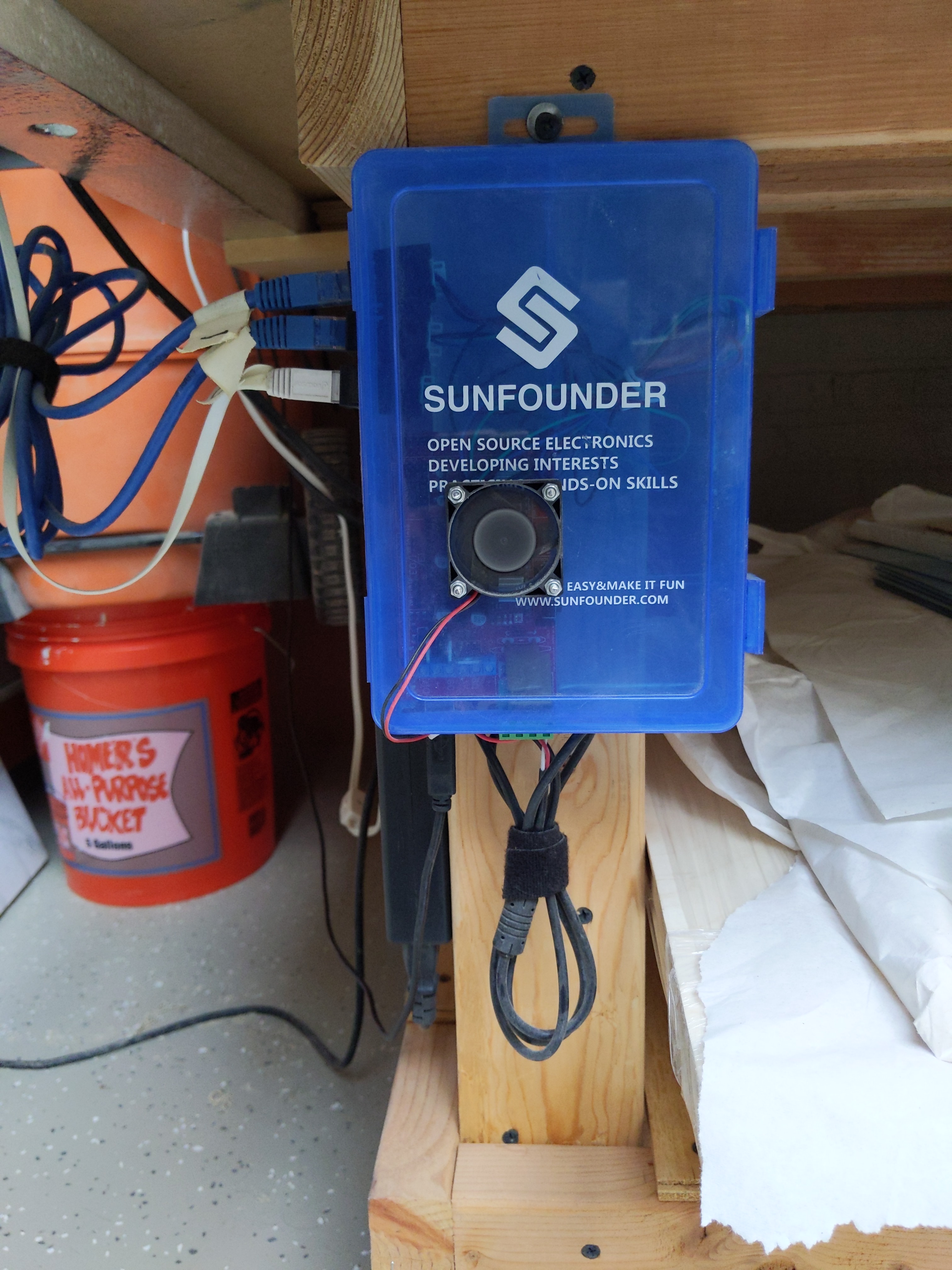

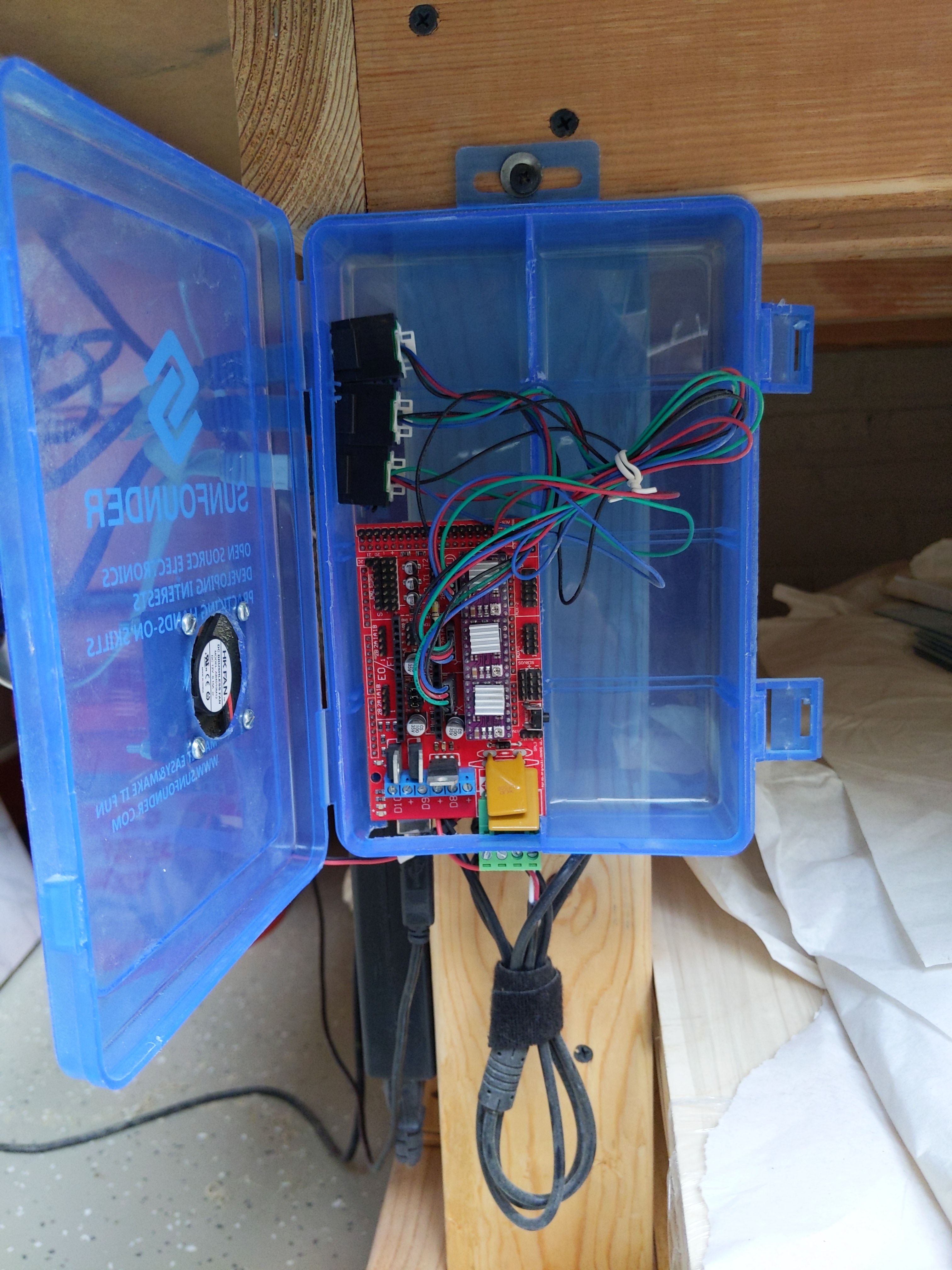

I have seen jerky stepper behavior when the drivers were just on the edge of overheating. Does your fan blow “in” on the drivers or pull air “out” past them? Is there enough space in your enclosure to bring in/exhaust the same volume of air the fan is trying to move? Have you checked the vRef on the motor drivers to be sure it’s not too high?

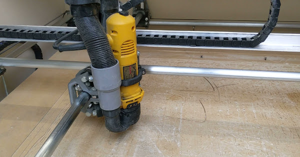

Any chance the vacuum hose or drag chains are dragging more than they used to?
Cool - I’d rather leave the software alone if there’s not a huge benefit from updating it.
That’s my project for today - with more experience it’s prob not a bad idea for me to just rewire the steppers.
@ttraband A bunch of good ideas there - I have the fan blowing out - and there’s a pretty good sized hole (about the same area as the fan hole) located past the mosfets so cool air can be pulled in from the lowest point, past them, then the drivers and then out of the case:
I have the belts off now and the machine moves very easily - no extra tension from the vac hose/drag chains that hasn’t been there the whole time.
I just checked the vref for each driver and here are the values:
Z = .697v
Y = .677v
X = .707v

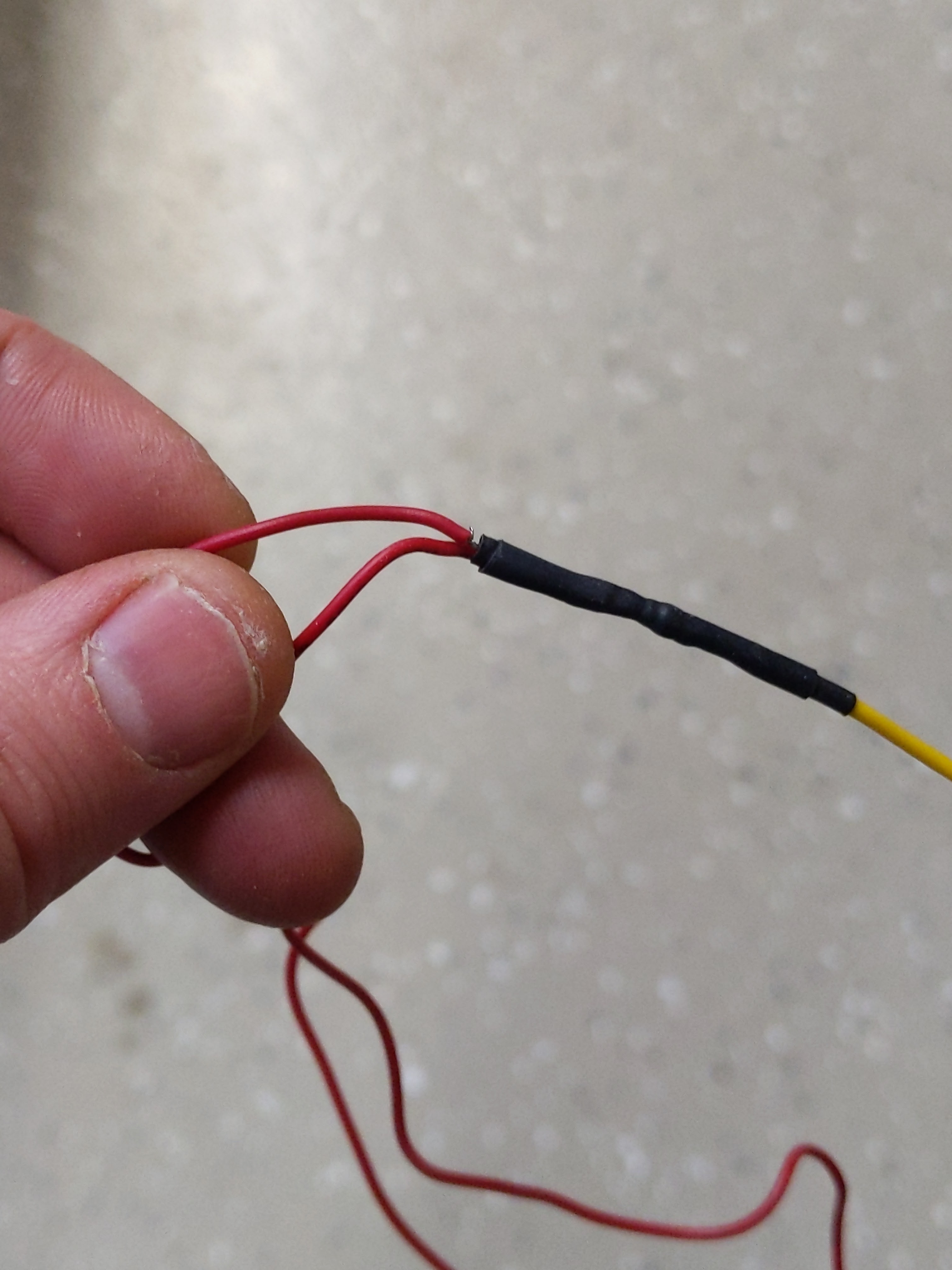

Alright - all the X and Y series connections are now rewired - there was one questionable connection on the X:
Now everything’s tightened up with these heat activated connectors. They’re one of my fave time savers and have def upped my reliability game when it comes to wiring.

That looks like parallel wiring, not serial wiring:
https://docs.v1engineering.com/electronics/steppers/#series-do-it-this-way-
We used to use parallel wiring, and we would crank the current way up (to basically double). But Ryan (or somebody) found out series wiring requires less current and we had more power and less problems with the stepper.
Maybe this explains it. You have been running your rig with the double current for years and then switch to a new controller with the current set for one motor?
Ahhhh - thanks Jeff, you’re right - it’s wired in parallel right now. That guide is new to me. Thanks for sending the link. I can change it to series wiring - it sounds like that’s the recommended method now. I haven’t switched controllers - everything’s been setup like this since I built the machine 5 yrs ago. Are my voltages setup for series or parallel?
