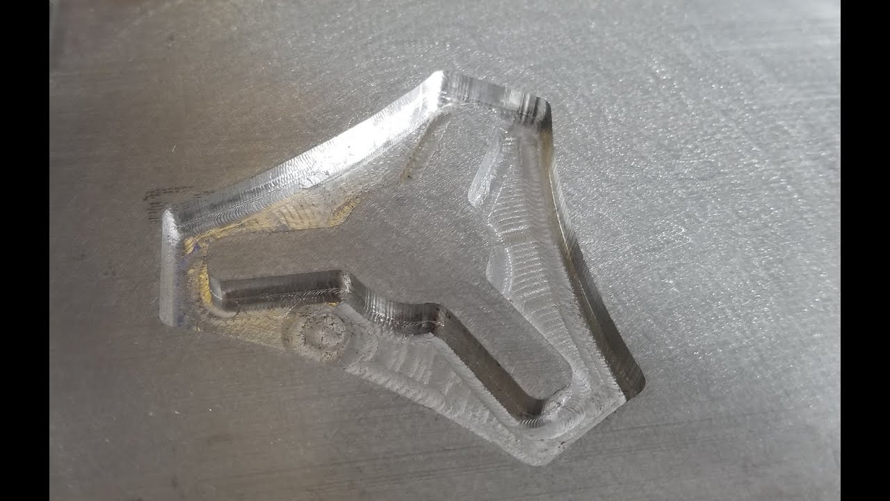

I am going to change the title of this thread so newcomers do not fall into this rabbit hole and have serious doubts about the capabilities. Just to be clear, milling Aluminum is fairly easy, steel can be done with an appropriate sided build.

You say these are necessary, yet I cut aluminum on my MPCNC with none of these. NEMA 17, no gearbox, single flute, and even series wired. These speeds/depths seem reasonable to me.

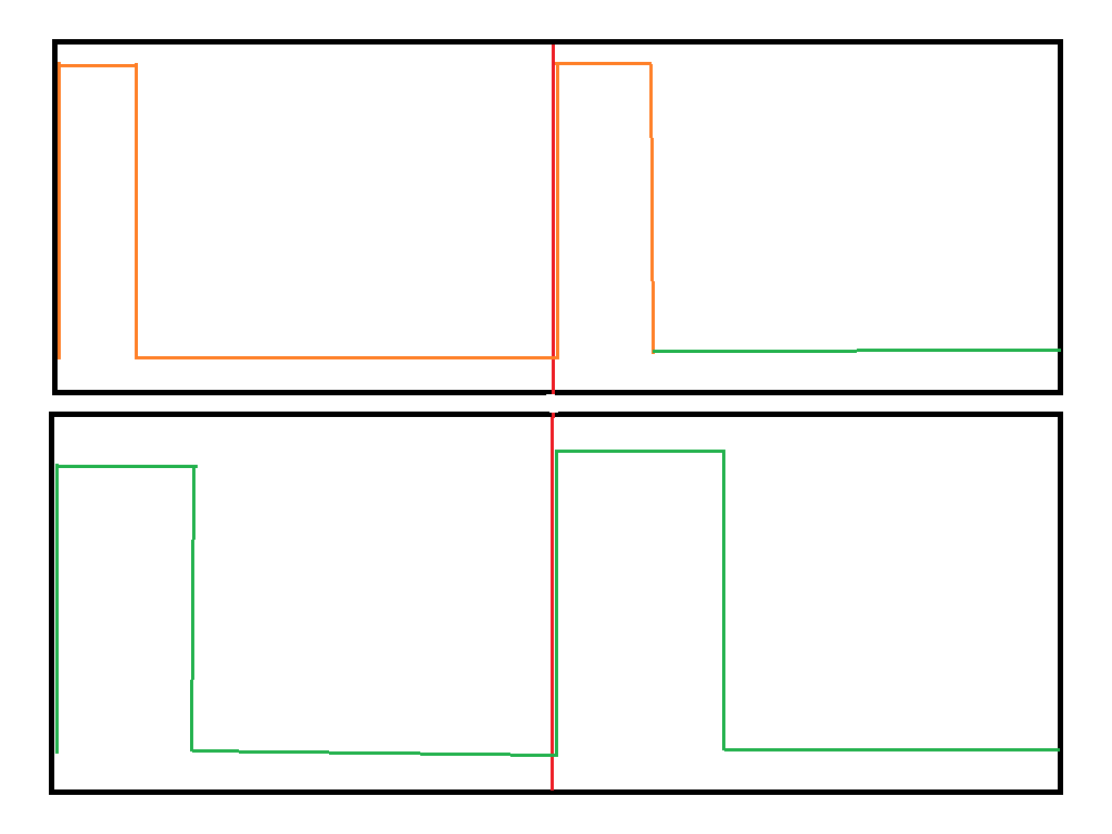

Yeah. How that actually works is that if there was a lot of loss on the wire. Enough that 3-4V would be insufficient, then 12.5% duty cycle would also be insufficient, and the drivers know that, and increase the percentage. They don’t care what percentage of on time they have. They only try to make sure that the average current going through the wire is the same as the Imax.
The drivers don’t send 3-4V, 100% of the time. They send 12/24V, some fraction of the time. There are some things that benefit being modeled as a full source, and some things that are more intuitive thinking of the voltage as an analog signal.

This (from your excerpt) is exactly what I was saying. The inductive loading means that you get the driven current. for speeds that the voltage is sufficient for. At those speeds or below, higher voltage does not impart higher torque. Since the drivers switch the DC waveform based on current loads, you get a higher frequency on the pulsed circuit with higher voltage. This is necessary to keep the higher voltage from running over the current limits.(12.5% duty cycle versus 25% duty cycle)
I never once said or implied that higher voltage does not increase your speed limit. I said that higher voltage does not give you more motor power at a speed at which the lower voltage is sufficient.
So for those of us who never exceed 4000mm/min, there is very little reason to go to 24V, since 12V is fully capable of providing near rated torque at those speeds, and is certainly capable of hitting the driver current limits that we typically use in order to keep motor temperatures acceptable for mounting to printed plastic parts.
I don’t think so either. The current waveform that is graphed is one where the rising slope only meets the peak current, and does not exceed it. This is the case for full stepping where the voltage is controlled to be sufficient to get to and not exceed peak current (Note that in the first graph, (A) current never rises above I(max)) With the frequency being in this case commanded steps/time unit. This is NOT the same as the case for the pulse-width of the driver pushing V(mot). I think that I read the switching frequency of the TMC2209s at 12.5MHz, at which speed, we can pretty much ignore the ripple that we’ll get at I(max) This switching speed is what allows the 256X interpolated microstepping.
In terms of voltage switching, we get a higher frequency with the lower duty cycle (higher voltage) with the inductance acting to smooth the ripples. This is the only thing that will allow the flat parts at the top of graph A, where the voltage is limited to only what will supply I(max) and no higher.
Agreed, except that PWM frequency does not need to change with input voltage. A proportional decrease in duty cycle is sufficient.
There is a small change.The PWM frequency itself does not, but the narrower pulse width has higher harmonics.
So in this graph, if the X axis is time, both PWM cycles are the same period, but the on time for the top line is operating at a higher harmonic frequency. The inductive load will still react on the harmonic, and even with a proportional increase in rise rate, the shorter timer interval will give the same average current over the 80ns of the PWM frequency.
You are of course right that the PWM frequency does not change, I was in error not specifying the harmonics.
