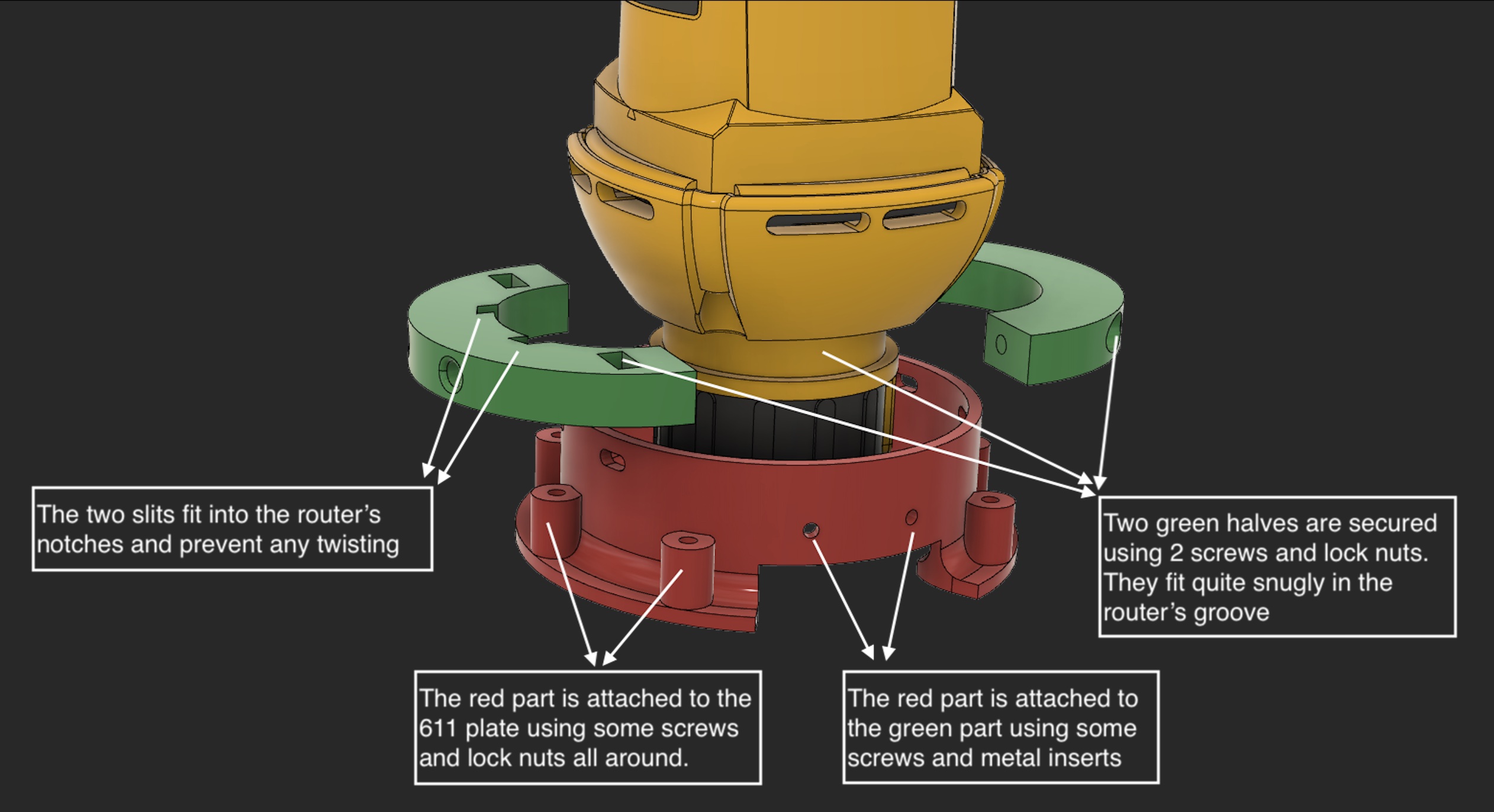

If something is loose, like maybe the 660 mount, then the bit can jump and take a huge bite, which will increase the load dramatically. If that happens, you will skip steps, so watch it carefully to see if that happens first before it skips steps. A good warning sign of that is the bit will wobble sometimes and make wider holes, but not skip steps.

It is possible. I will keep an eye. I certainly need to get some more mileage on it before I am confident. BTW, here is a diagram of what the mount assembly looks like:
Do you have any bracing higher up on the spindle?
My original design did but then I thought of just giving it a shot without that. From what I have observed so far, there is not a whole lot of deflection while cutting and the quality of cuts have come out ok. The disclaimer is that I have not done a whole lot of cutting yet. I will know more in the coming days/weeks. I have a feeling that adding a brace might help more in terms of the durability than the accuracy itself.
The heavier your depth of cut, and the faster you try to move through the cut, the greater the deflective forces will get. The tool mount on the MPCNC Burly that I use has a band up high on the motor housing to help keep things rigid. As I understand it, the LowRider was initially designed to hold a router, which has a wider ring around the bottom, which would be much more rigid. It might be interesting to hear from others using similar tools on the LowRider and learn from their experience on tool deflection.
I trust that you are the expert in this brace (since you are the only one that has touched it, and you designed it). But here is my $0.02:
The router has a long moment arm. If you had just a little brace at the top holding it there, the bit would be much more rigid. I would think about the bottom brace as stopping translation (movement in X, Y and Z) and the top brace stopping rotation.
@ttraband @jeffeb3 Thanks for your feedback. I agree that adding a brace at the top should help with the rigidity. I will go ahead and add it.
