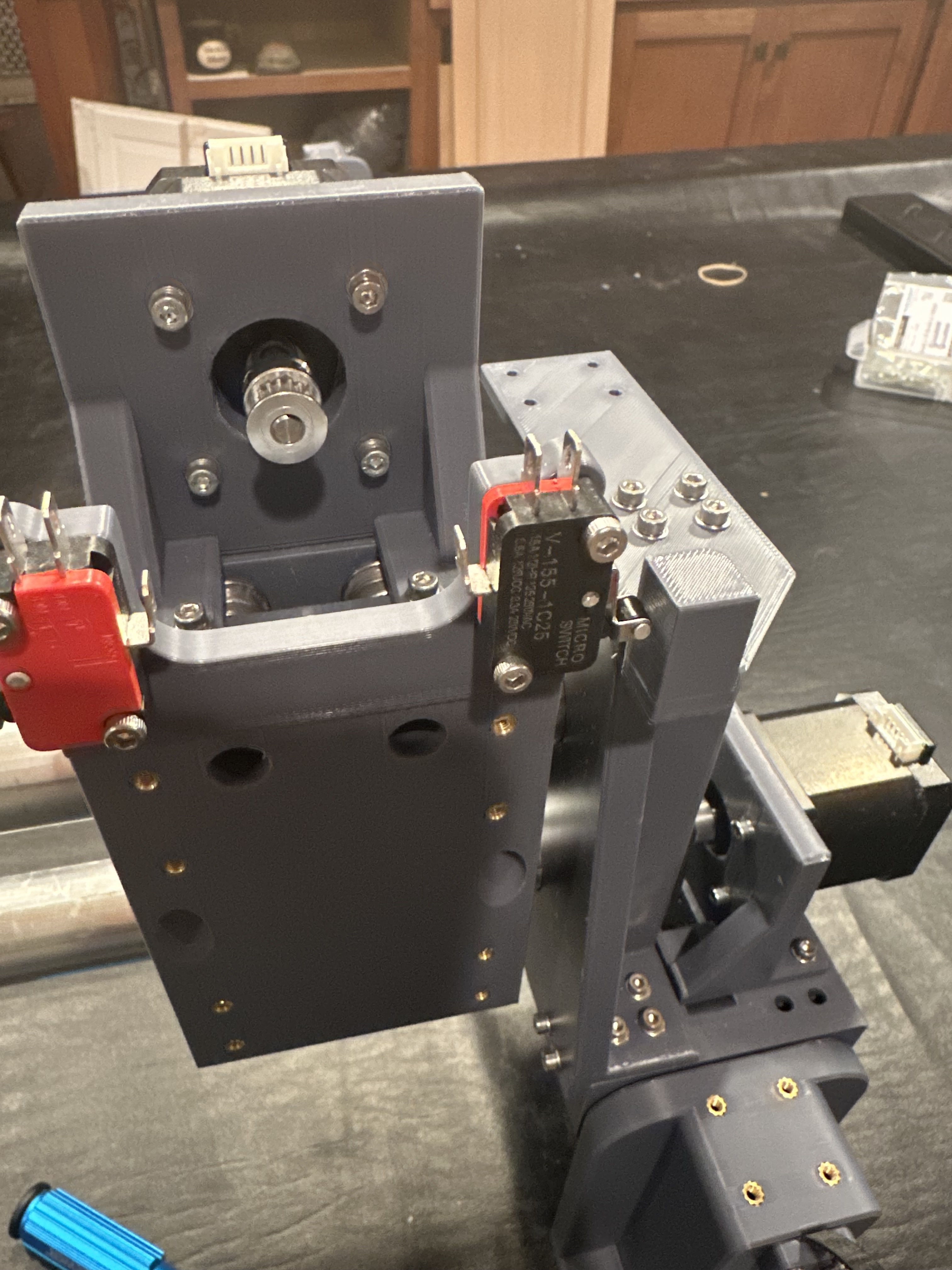

I went with the mechanical limit switches for now, shown here on the X-axis carriage. Wiring to the Jackpot controller begins this week. :crossed_fingers:

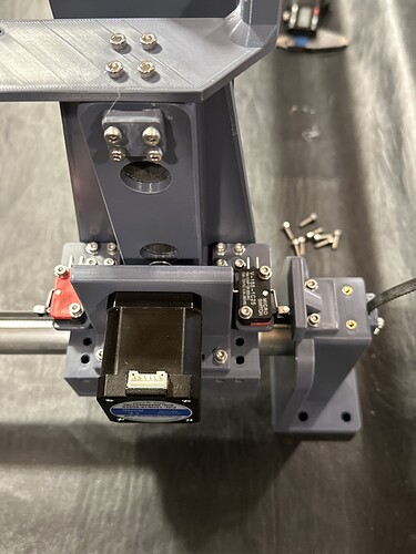

And one of the y-axis carriages
