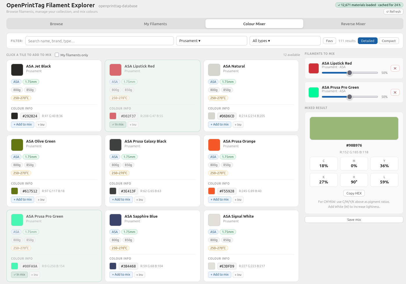

OpenPrintTag Explorer - Colour search and mixer for the OpenPrintTag Database
You all know that I generally don’t like AI, but this was a pretty neat usage for it I think: This tool was written by Claude. It cost me a bit of time nevertheless, because I had many ideas that I wanted to put in. It’s not perfect, but good enough for me, here it is:
openprinttag-explorer-v8.html.zip (24.0 KB)
/edit: New Version 8 with a lot of minor tweaks for usability, a hint about the deletion of the cache on moving the file etc.
It loads the filaments once every 24 hours, all the other settings (like favrourites) are written into the IndexedDB and are not getting refreshed/deleted. Besides refreshing the list the tool works completely offline. If you move the HTLM, your favourites etc. are gone, so make sure not to do that… :smiley: V7 now lets you backup and import your settings.
It gives you a list of all filamentes that are in the database that can be filtered by several criteria.
You can also add the filament to your personal collection (my Filaments, besides that the tab is boring).
You can also add a colour to the colour mixer so you can see what it looks like combined (really interesting for INDX):
The reverse colour mixer lets you choose a colour and it shows you if you can mix it with your own colours (if you selected “my inventory” only or “favourites only”) and gives you a link where you can buy an additional or single colour that comes closest to what you want.
If you have all the filaments enabled it tells you the closest combination.
If you have feedback, I’ll gladly feed it to Claude Free. :stuck_out_tongue:

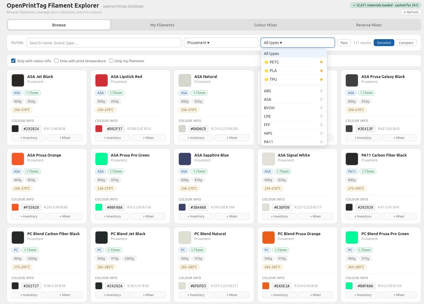

Tab: Browse
Displays all filaments in the database as tiles. Each tile shows:
  • Colour preview
  • Name and manufacturer
  • Filament type and available diameters
  • Available spool weights
  • Print temperature range (if available in the database)
  • Hex colour code with RGB values (if available) — clicking the hex code copies it to the clipboard
Each tile has two quick-action buttons at the bottom:
  • + Inventory — adds or removes the filament from your personal collection
  • + Mixer — adds the filament to the colour mixer. If the filament is already in the mix, the button shows ✓ In mix; clicking again removes it.
Clicking the tile itself opens the detail view inline on the same page, not as a popup. It shows:
  • Full colour codes (HEX, RGB, CMYK, HSL, transmission distance)
  • Print parameters (print, bed, chamber, and preheat temperature; density; Shore D hardness)
  • All available spool configurations
  • Product photo and link to the product page (if available in the database)
  • Star icons next to brand and type for quickly adding them to favourites
The Browse tab also contains additional filters:
  • Only with colour info — hides all materials without colour data
  • Only with print temperature — hides all materials without temperature data; temperature range checkboxes appear below for further narrowing
  • Only my filaments — shows only materials from your personal collection

Tab: Colour Mixer
Lets you virtually mix 2 to 4 filaments and calculate the resulting colour.
How to use:
  1. The left panel shows all filaments matching the current global filter as tiles. Filaments already in the mix are highlighted in green and labelled “In mix”; clicking the same tile again removes it from the mix.
  2. The “My filaments only” checkbox restricts the selection to your personal collection.
  3. Click a tile to add or remove a filament from the mix (maximum 4).
  4. The right panel shows the added filaments with a slider for each mixing ratio. Percentages are normalised automatically.
  5. The mixed colour is shown immediately as a preview with HEX, RGB, CMYK, and HSL values.
  6. Only filaments of the same type (e.g. only PLA) can be mixed. An error message appears if different types are added.
  7. Use “Save mix” to save a mix with a custom name. Saved mixes appear below and can be reloaded or deleted at any time.
Note on CMYKW: The CMYK values in the result represent relative pigment ratios as used in CMYKW mixing systems. White (W) can be added to reduce the K component and increase brightness.

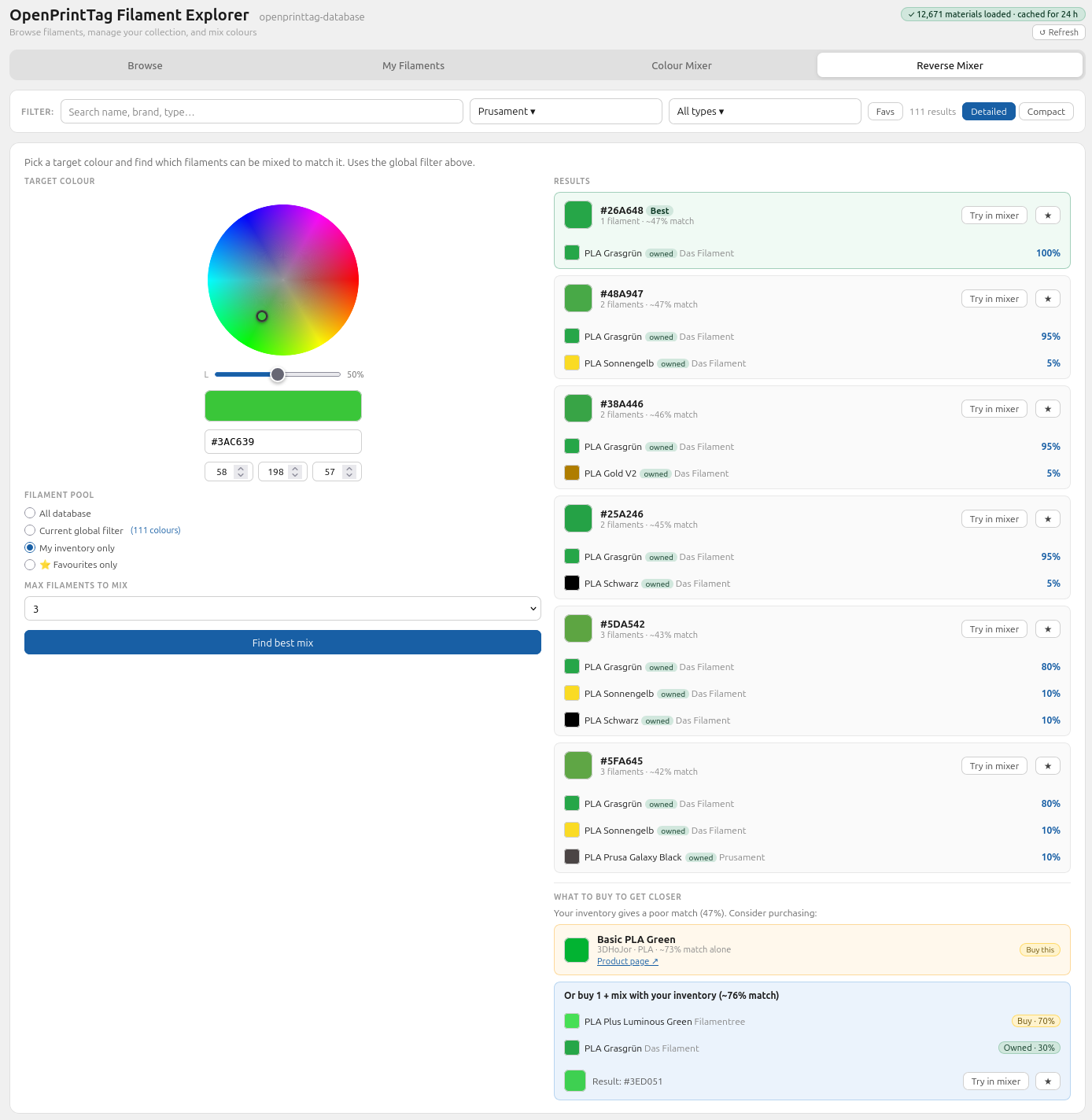

Tab: Reverse Mixer
Lets you enter a target colour and find out which filaments need to be mixed to achieve it.
Choosing a target colour:
  • The colour wheel displays hue and saturation. Drag the cursor on the wheel with a mouse or touch gesture.
  • The lightness slider below adjusts the overall brightness of the colour.
  • Alternatively, type a HEX value directly or enter individual RGB values. All inputs and the wheel stay in sync.
Choosing a pool:
  • All database — searches across the entire database
  • Current global filter — uses only filaments matching the current global filter; the number of available colours is shown
  • My inventory only — uses only filaments from your personal collection
  • Favourites only — uses only filaments from your starred brands and types
Search results:
Results are sorted by colour match (percentage based on perceptual Lab colour distance). The first result is always the closest match. Each result shows:
  • A preview of the mixed colour
  • All filaments involved, with their mixing ratios
  • Whether a filament is already in your collection (“owned” badge)
  • A “Try in mixer” button to load the result directly into the Mixer tab
  • A star button to save the result as a favourite
Purchase suggestions (in Inventory and Favourites mode):
When using “My inventory only” or “Favourites only”, a purchase suggestion section always appears below the results:
  • Single purchase — the one filament from the full catalogue that comes closest to the target colour on its own, with a direct link to the product page
  • Buy + mix — if combining a new filament with one you already own gives a better result than buying a single filament alone, this combination is shown with exact mixing ratios
Purchase suggestions always match the filament type: only filaments of the same type as those already in your collection are suggested.

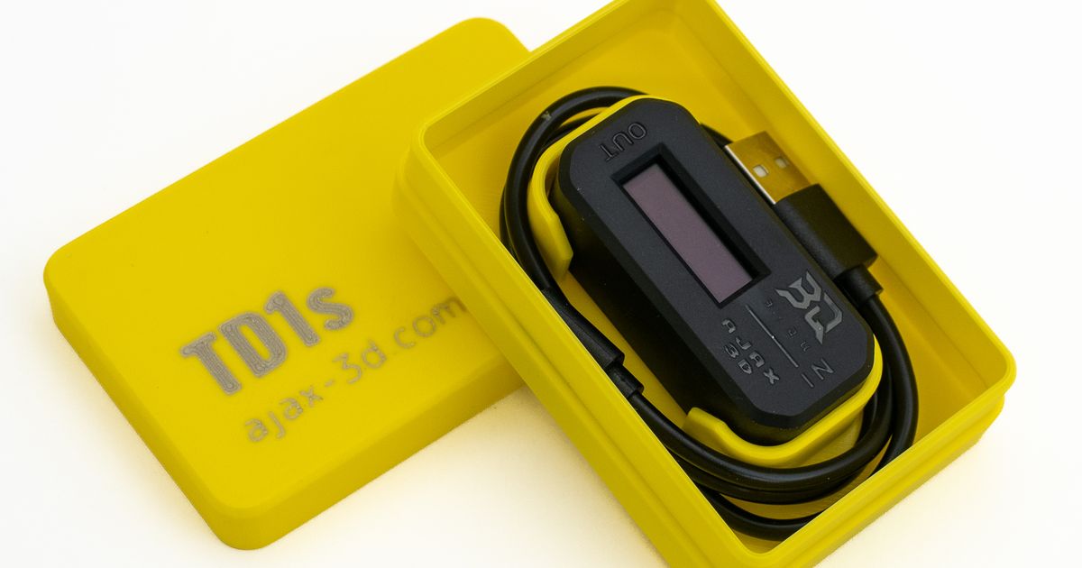

Transmission distance (TD) is a measure of opacity - ie how far light can travel through the filament. It’s super important when calculating Hue Forge type prints - many filament manufacturers supply the info and there are a couple of databases that exist, like HueForge TD Database — Filament Transmissivity Values | FilaScope
You can measure it by various means, the nicest is AJAX 3d’s nifty little gadget which feeds the info into HueForge and other software databases - more info here -
Oh and if you buy one because you are intrigued don’t forget there’s this guy on the internet who’s made a neat little box for it. :star_struck:
