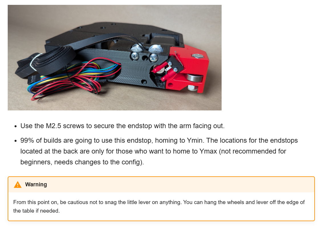

My kit and the website say 5 endstops, but there are spots for 6 (xmin, xmax, zmax (on each side), ymin/max (one for each side). Is only one endstop needed for the y axis? If so does it matter on which side to put it? Or did I miss something else?

Nothing implies both sides, the pictures only show one. For Y there was a note that says you don’t need it, I added it to X as well, thanks for the hint.

It’s actually mentioned here
Yeah, but that’s only for Y, not for X. I know because I added it. :stuck_out_tongue:
