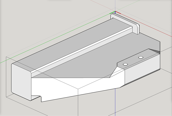

Here’s what I’m working on for “end caps” for my super strut metal rails, to hold the Y tensioners in position, without having to widen my table. The ones for the far side, where the Y rail is, will be similar but will need to jut out more. I’m printing a rough prototype now, of these (still modeling the far side). Open to input and suggestions.
Here’s my current modeling for the far side “end caps” (side with the Y rail) for my super strut metal rails, to hold the Y tensioners in position, without having to widen my table.

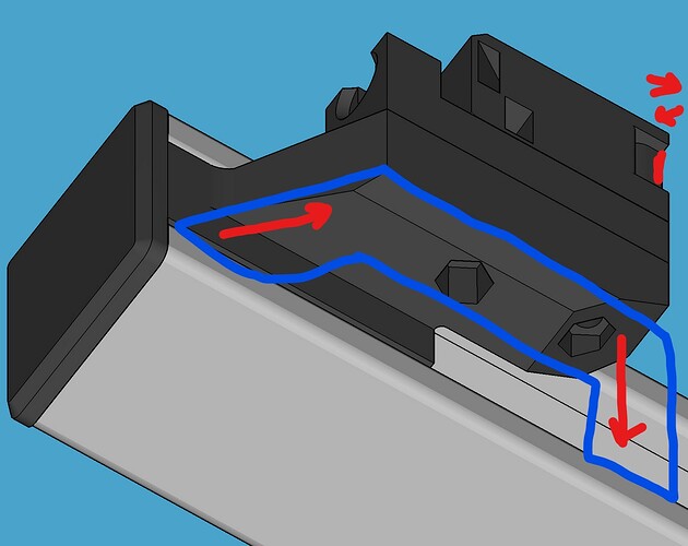

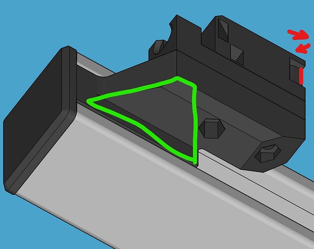

These are under the machine and have a pretty significant load on them. Make them as thick as possible and I would add a brace in the direction of compression since that is stronger that printed parts in tension.

These are thin wall prototypes only used temporarily for test fit. The actual final items will be thick and strong. I’m glad to say that my modeling fit on the first try.
The tension on the belt, and the load from cutting and acceleration. There is just no reason to have it floating when you can add a brace. Maybe it isn’t needed, maybe it is. You have the parts give them a shot.
Load is in red. You are creating a lever arm, I am proposing getting rid of that. You can even leave mine open to reduce print time.

Got it! I felt like I designed them pretty strong, but you know better than me what kind of forces this new LowRider3 will bring to bear. It is very kind of you to use your engineering expertise to guide us non-engineers. I will take this to heart in looking at the design again.

I can easily get rid of the lever by lengthening the inner core that runs inside the metal super strut. I could even do bridging with gaps to relocate the strength without increasing the print time or usage of plastic.
Adding a support arm structure outside it is doable but will require some careful measurements and pretty fine tolerances on print dimensions mentions, because it wouldn’t really serve as a brace if it was too far away from the super strut such that it didn’t make contact until the part broke. I’ve been able to get some pretty spot-on measurements and some pretty fine tolerances on the core inside the strut. It is literally touching the inside of the strut on all sides, and requires a little bit of pressure to slide it in. So I think I’m up for the task of designing a support arm that would span down on the outside as well.

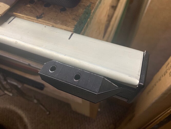

Before I got the helpful suggestions from Ryan, I already had a print job almost done on a thick-walled edition of the endcap/tensioner holders for the side with the Y rail. I’m going to go ahead and put them on, and see how they do, and if they break then I’ll have a good idea why. In the meantime I will probably work on improving the design, so that even if these do OK I can have an even better version for sharing.
Those are nice looking parts. The problem is probably less “breaking” and more flexing. Since the belt tension will be pulling on these, they may have a propensity to flex under acceleration loads, which will result in inaccuracy with your cut. Adding the bracing will then put a compressive load on the printed parts, which is considerably stronger and less prone to flexing.
I’m sure that you will get acceptable results with the parts as-is, but I think that you’ll be happier with even a very slight improvement in accuracy that a stronger part will bring.

Excellent explanation. Thanks. You all have convinced me.
