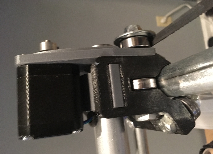

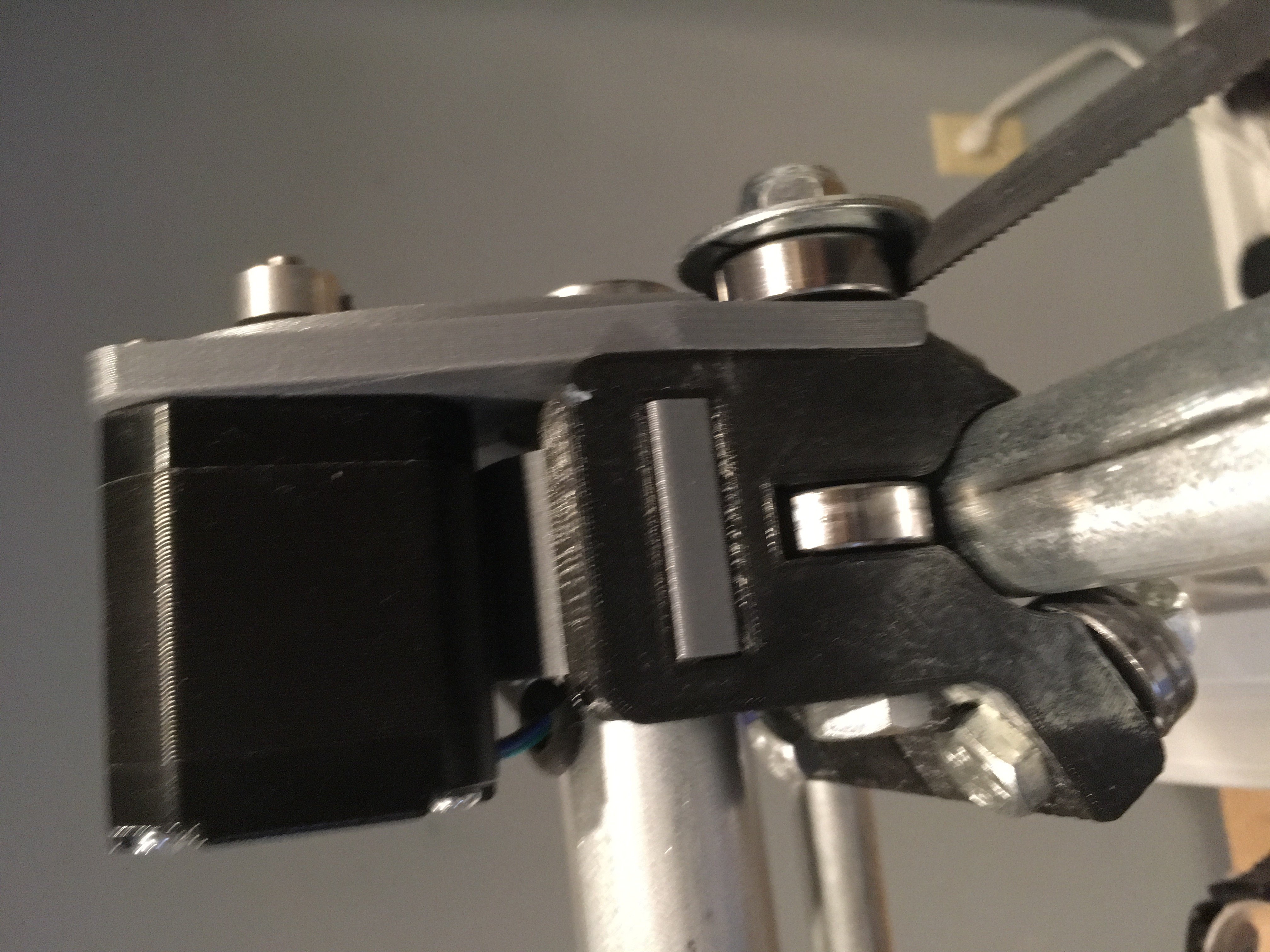

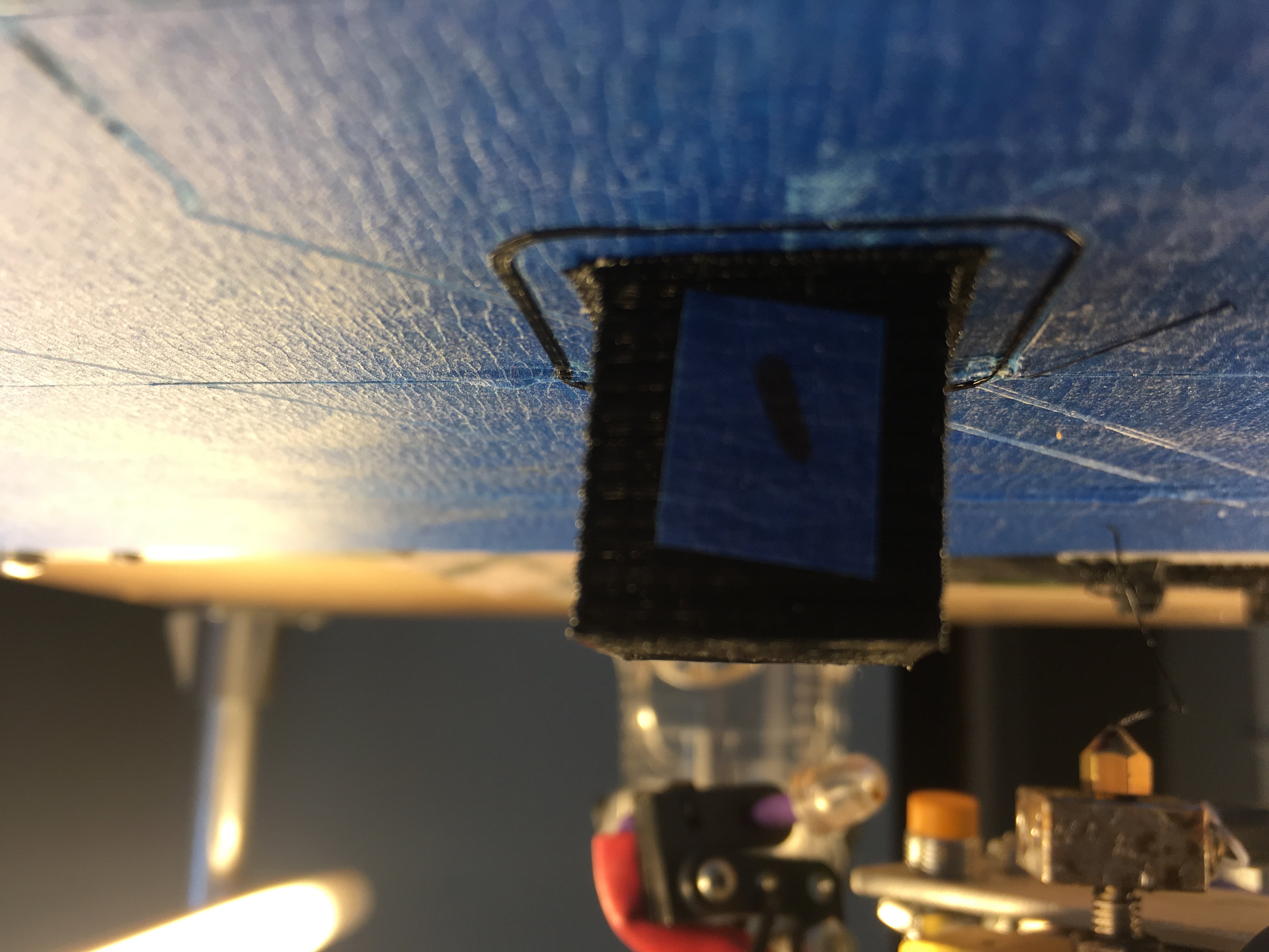

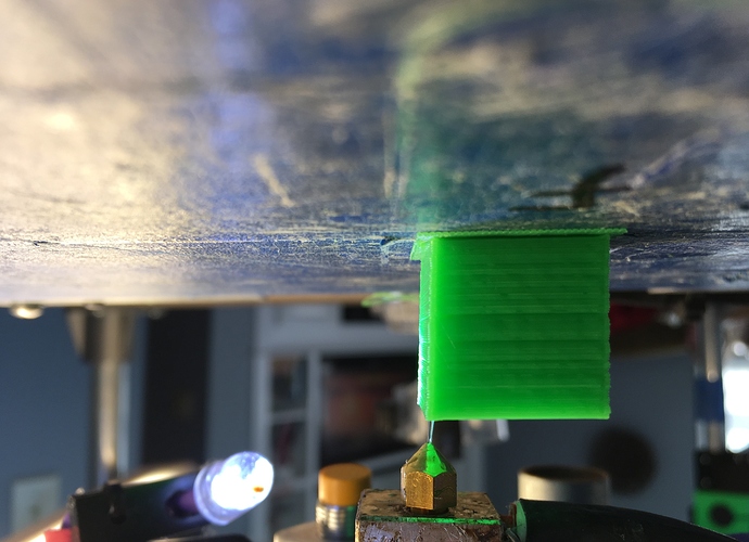

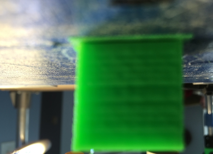

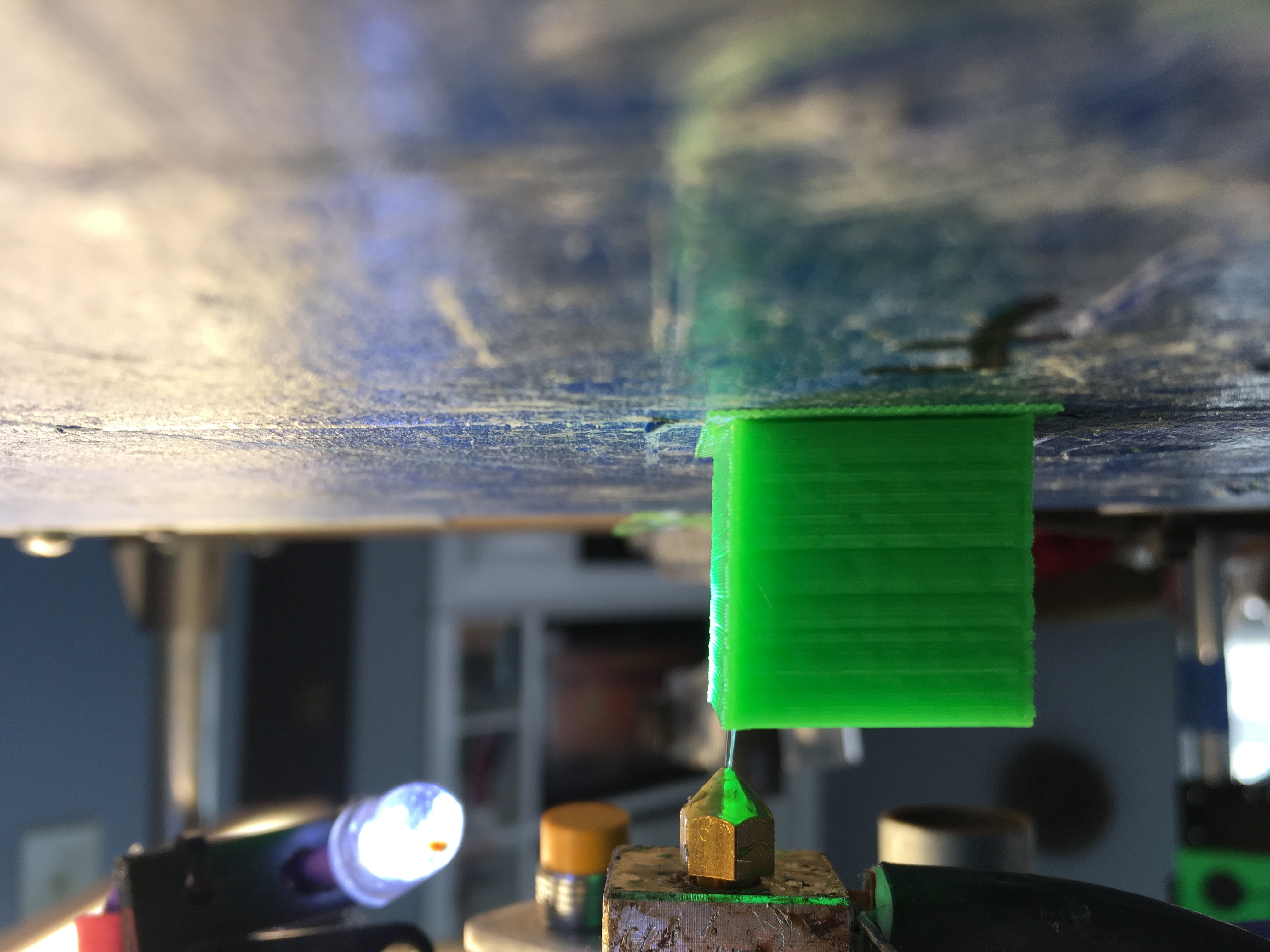

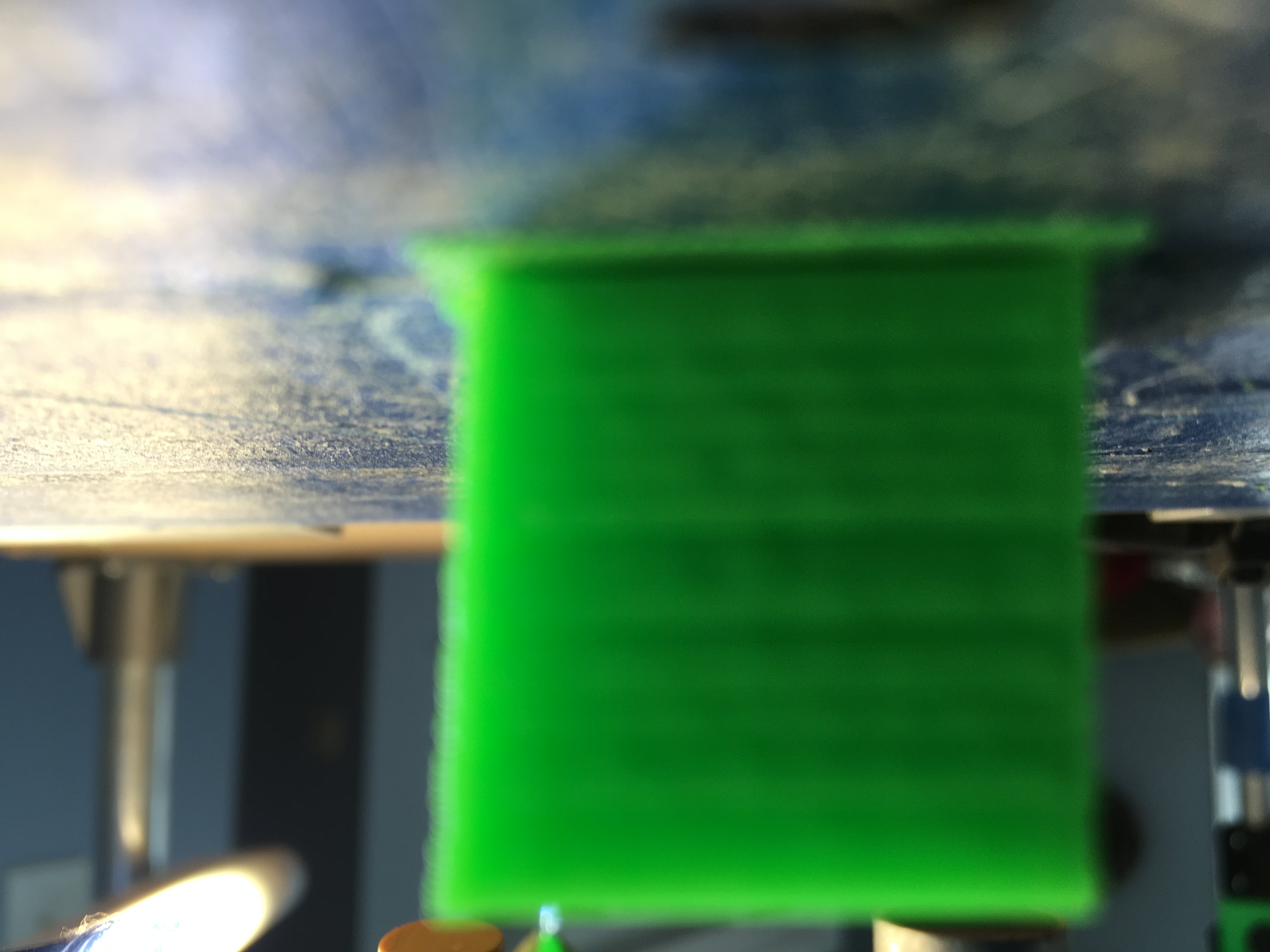

I have been printing 20mm test cubes to work on learning cause and effect of temp and flow settings. My finish has detoriated over the past weeks and don’t know where to start. The biggest problem I have recently is the test cube prints slanted left to right. I have checked for squareness and the Z axis. What’s odd is if I swap the X and Y stepper wires and run samples both ways I get the exact same slant. I would assume this rules out the software but I can’t find anything mechanical. What would a weak driver look like?
Other images
A bad stepper would cause very clear stair steps.
That seems like a non perpendicular z axis. Try a carpenter’s square or something on the table and rotate it around the z tubes as much as possible. I would guess it is tilted. Meaning a tension imbalance between the top and bottom mount bearings for that axis.
When you get that figured out I would test prints with something a bit bigger, small prints kind of have other issues that larger normal sized prints don’t.

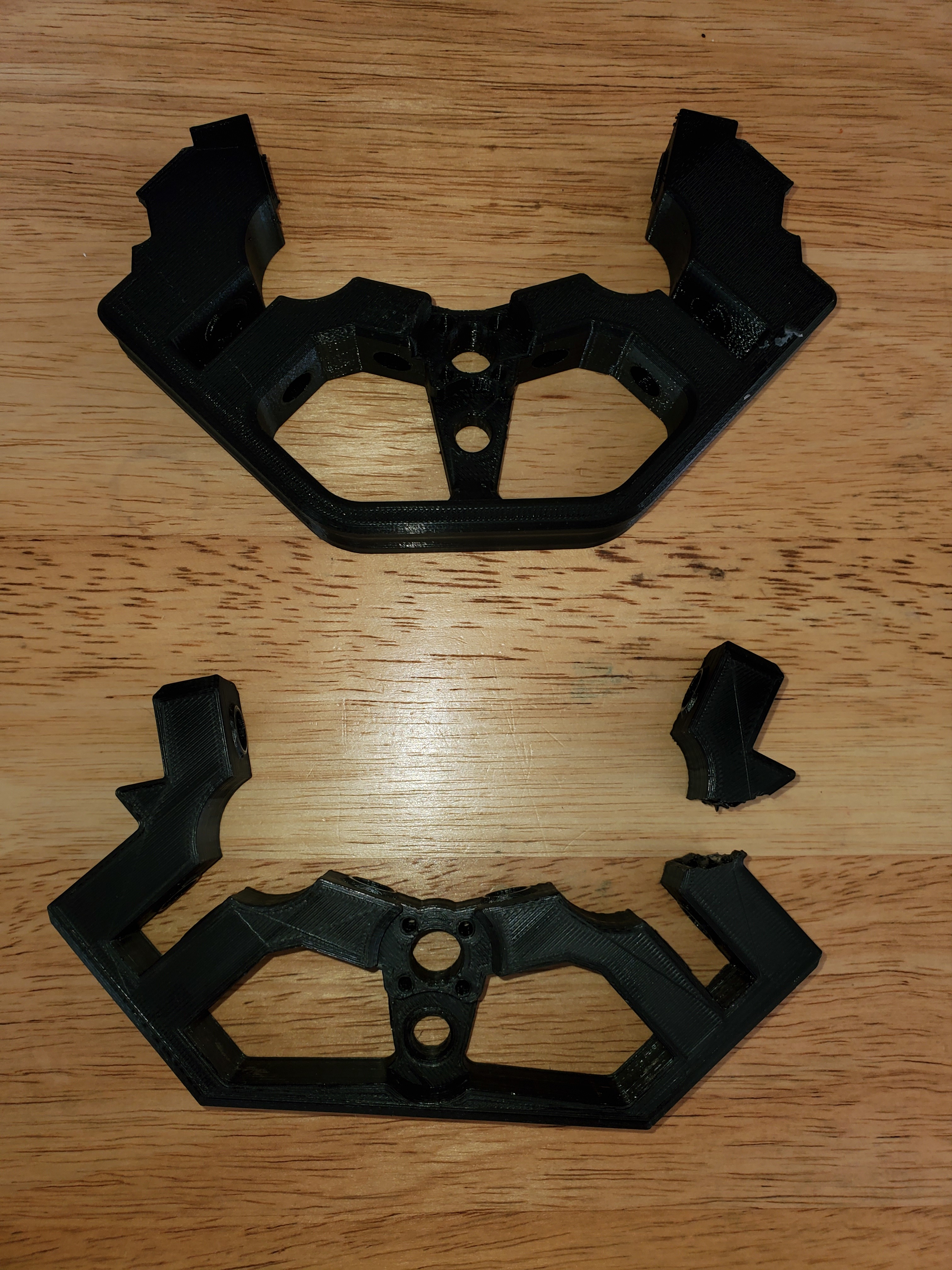

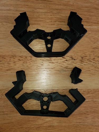

My son and I bought a MPCNC from someone who had already printed the files and put it all together a few years back. We couldn’t get the darn thing to work correctly so, yesterday we took it apart cleaned it and put it back together. While putting the Z carriage back together, last night I snapped the edge off the xyz_c part… I thought no worries, I will just go grab the files and print a new one… Not knowing there were updated files. DOH on my part!
I am simply looking for the older XYZ_C_Burly.STL
Any help would be amazing. Thank you!
Can you share a picture of the machine? There have been several versions. The burly is the current one. 525 was the previous one.
Thanks for the quick reply! The top one is the current Burly. Bottom part is the old version. Let me know if you need more pictures.
I think this is it.C-XYZ.zip (94.8 KB)
