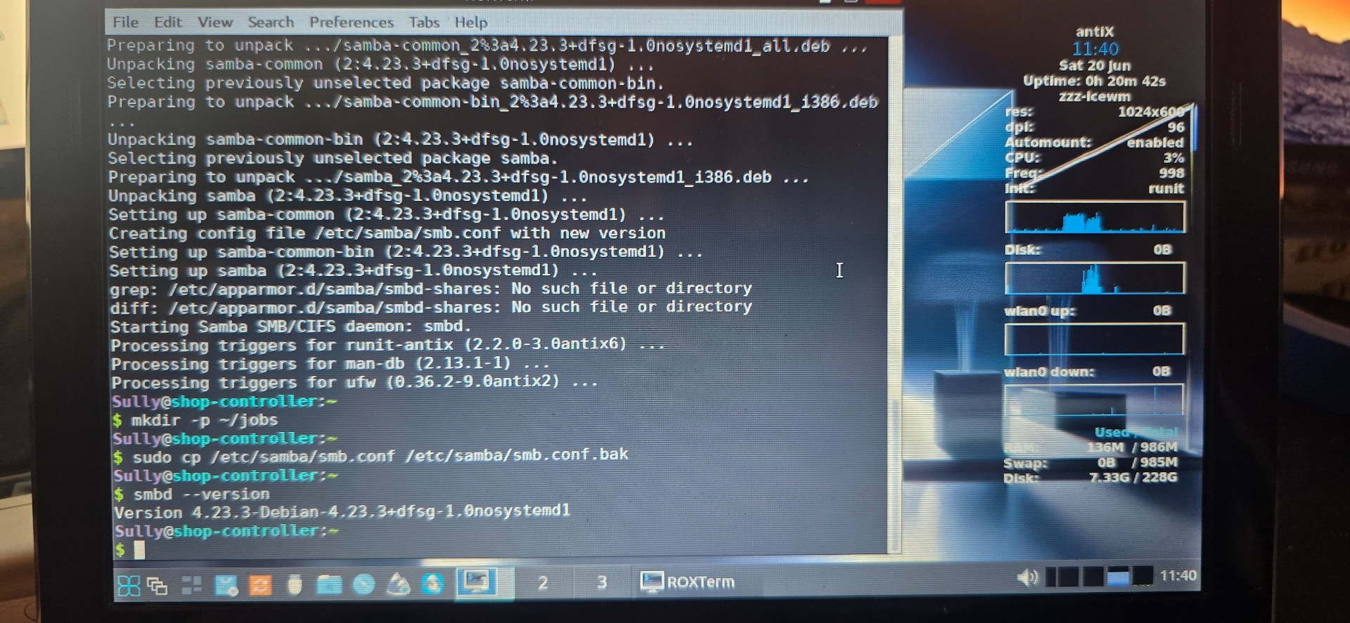

So I started with AntiX 26 and then ran a bunch of updates and such. Shut down any and all passwords because they are silly. Nobody is going to hack my 2011 laptop with nothing on it and no access to anything but a laser and a router.
next step was Samba so I can send files to it from my office. look at the cpu usage and ram being used. its less than my watch uses LOL

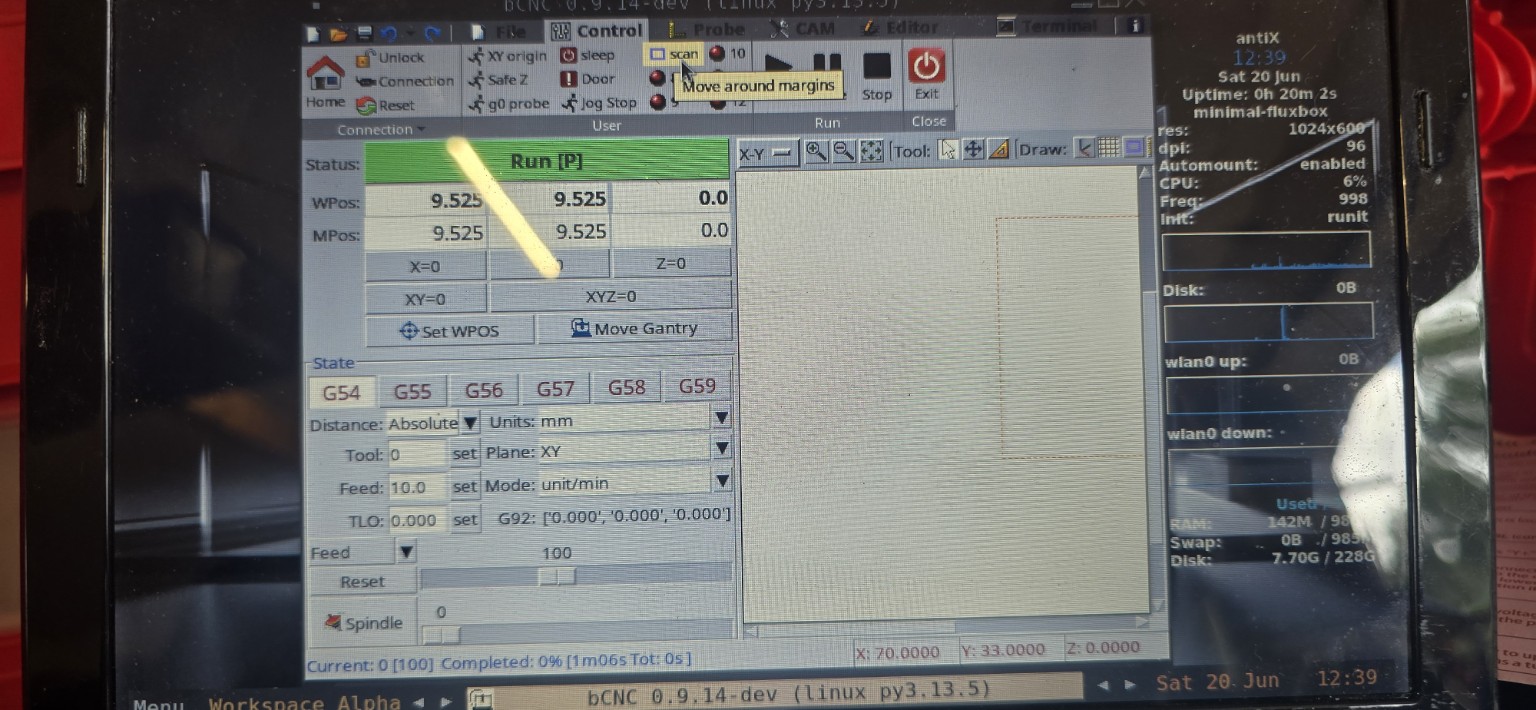

then a quick check in python to see if bCNC is was there already and it “kinda was”. It knew about it, but had to update and actually install. Then I plugged into my little TTS laser and tested. It homed the machine no issues, so I sent it a g-code. Running a gcode is the busiest this machine will ever be. Guess what? Only using 142M or ram and 6% of the cpu. Thats nuts!!!
Thats the end of the good news.

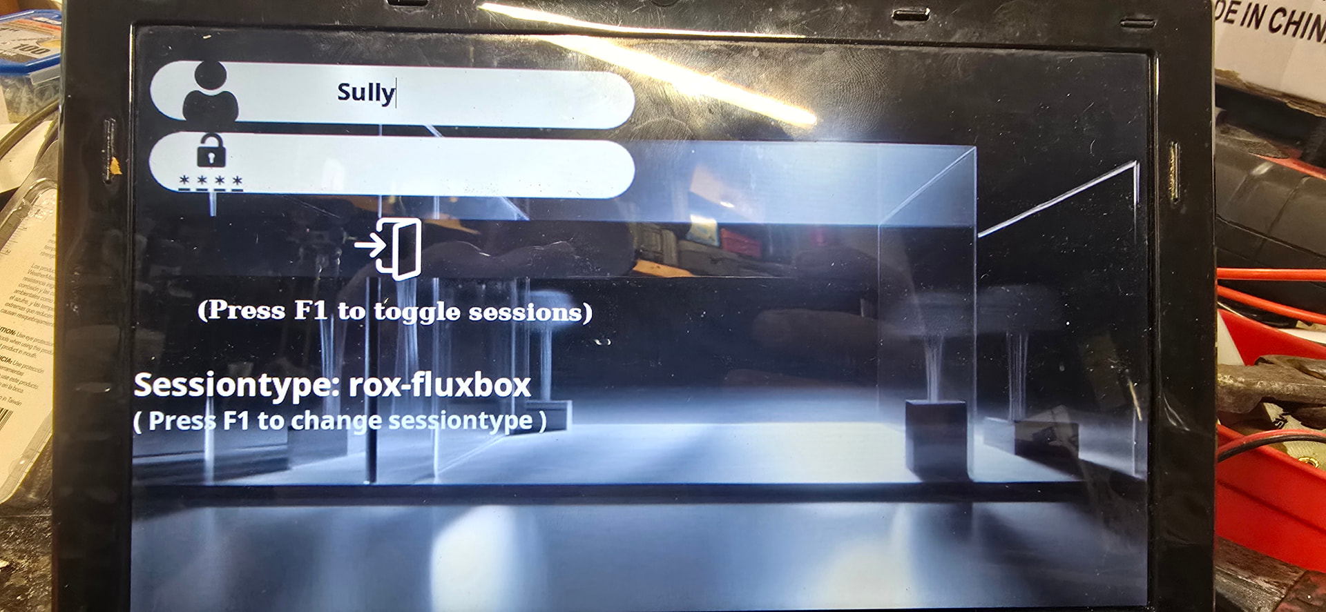

The next issue was a few days later when I tried to boot the laptop and get connected to the LR4. It was dropping out of active sessions and making me log back in. Now its just a big loop. I’m not sure if its that the battery on this thing is completely toast or if the spinning hard drive doestnt want to spin correctly.

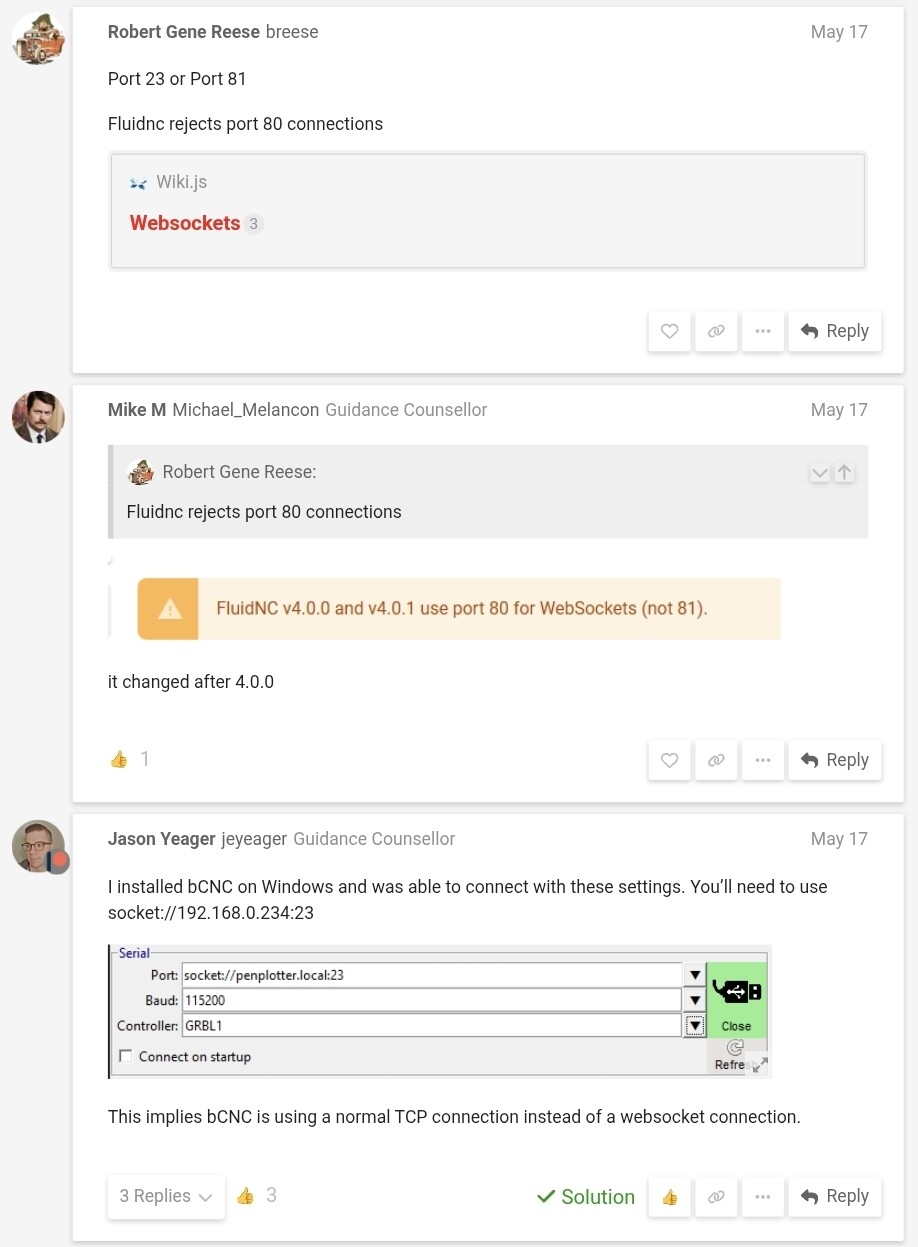

And then today, just digging through old threads I found that @jeyeager had solved the bCNC to FluidNC issue which means, I can run over usb to the LR4 without needing to play wifi games at all. That dude is a legend and we dont deserve him.
the answer is in this picture…. And it’s DUMB!
The session type was wrong. Not sure if corrupted or what, but switched to the session type I had been running and all my problems went away.
I need to move the laptop back to the workbench, but it’s running bCNC again and Firefox worked… so that’s basically everything lol.

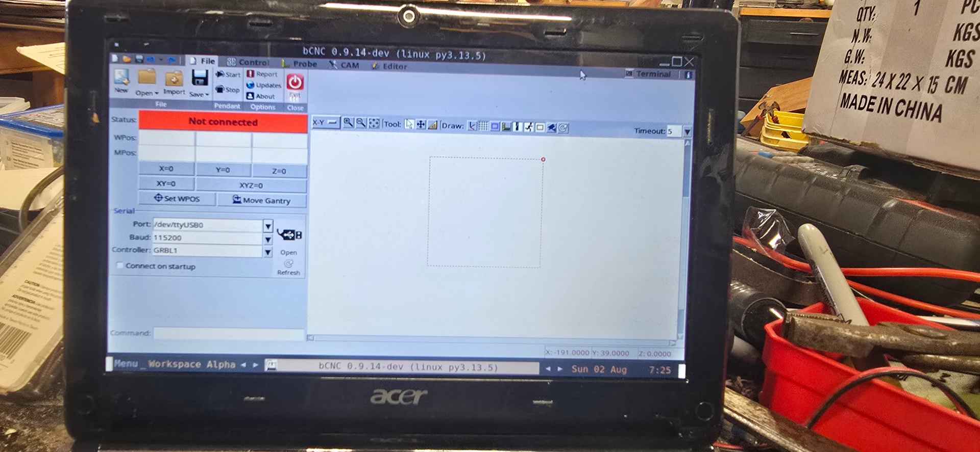

I tried to use the settings from @jeyeager but it didn’t work
I got the little acer that could hooked up to my lr4 and moving it with bCNC via usb. That’s fine for the TTS-20 but the LR4’s usb is on the gantry so that won’t work for actual use.
I tried
socket://192.168.0.1: (23,80 and 81)
socket://192.168.0.234:(all the same ports)
I tried local host as well… only the usb worked.
No dice.
I can control the lr4 using Firefox and the WebUI which might actually be better in most cases. But i can’t trick bCNC into using is wifi for serial connections
FluidNC 4.0.3
Telnet enabled port 23
Http enabled port 80
