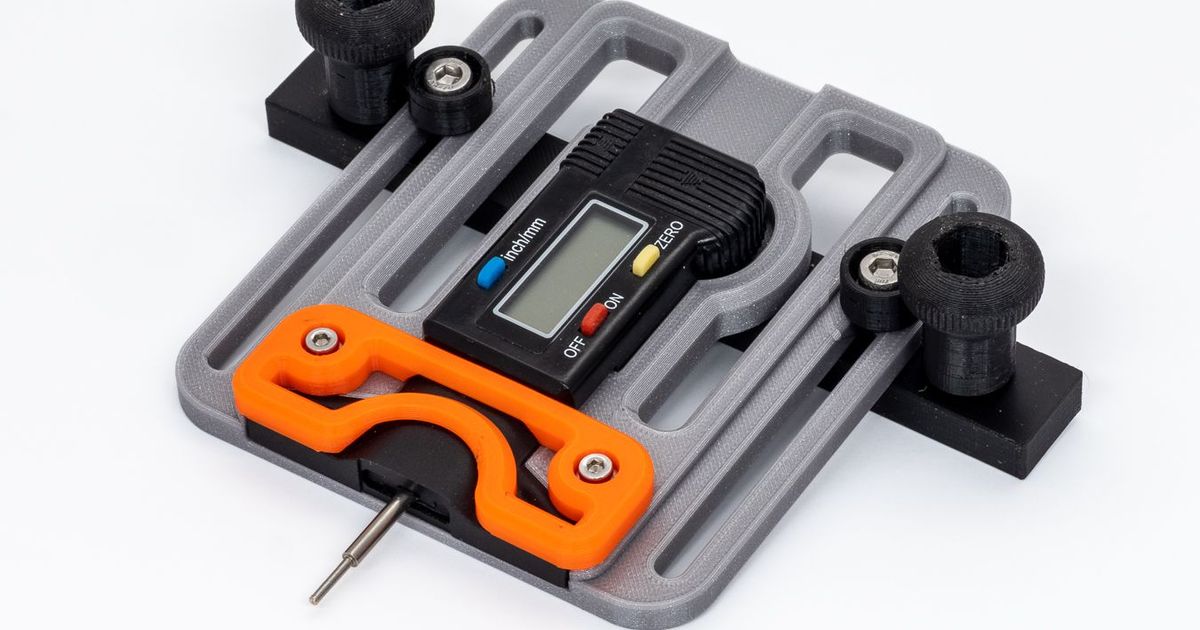

thanks for that! never seen this jig and it seems very useful!

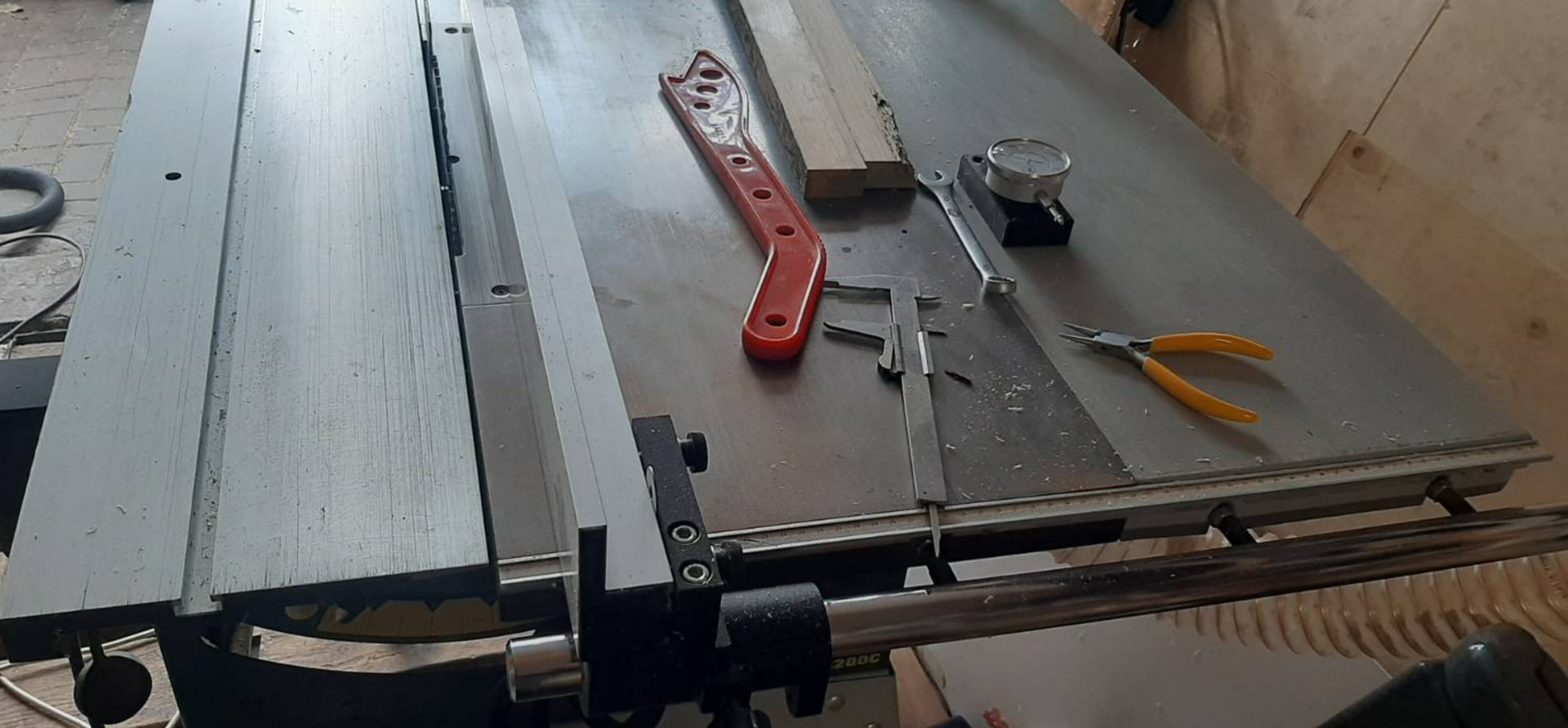

I do, however, have one of those:

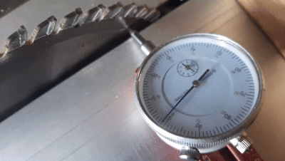

Also, as you can see on the photo above - I managed to make measuring jig out of a tool I have for router. Disassembled it and one part is working perfectly as a measuring tool :slight_smile:
measure

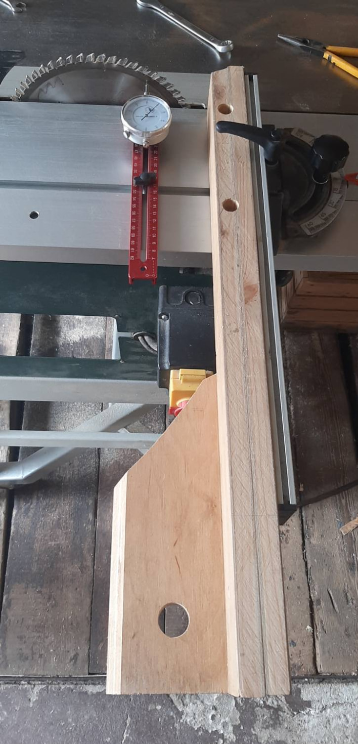

No, because you have the parallel fence with the correct distance but drawn back (so it can’t jam between blade and fence) you and can just push your workpieces against it.
You can see it here, first picture:
