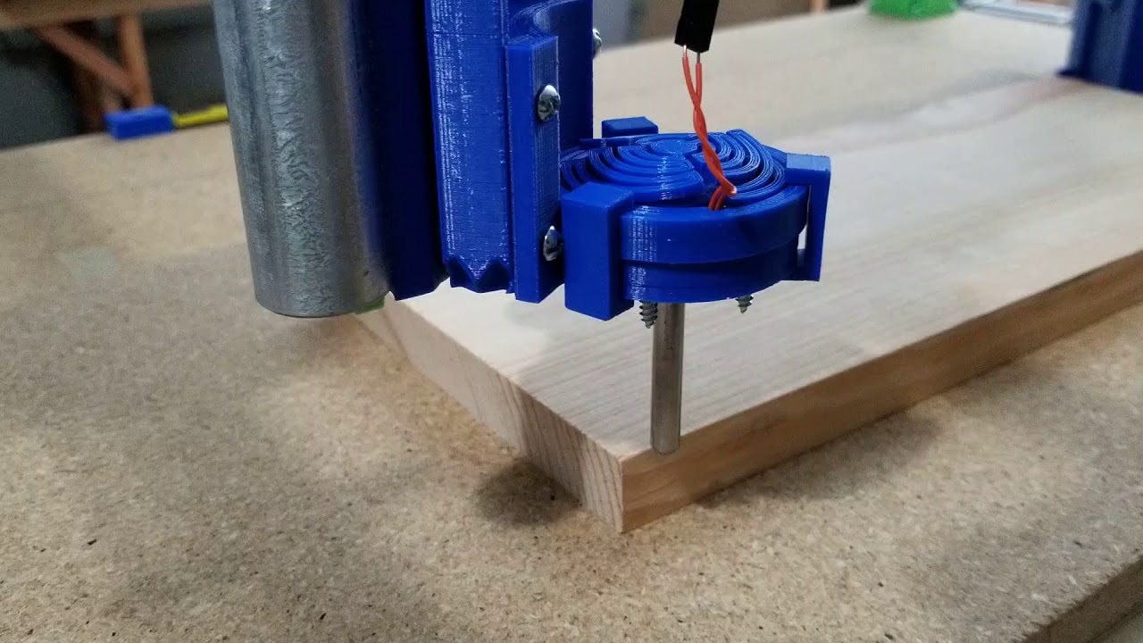

Looking to make some changes in Marlin to “offset” (if that’s what I should be doing) correctly and incorporate the a bit setter (Shared it in the FB group).
  1. I want to make sure Z is up as far as possible before homing to avoid destroying end mills, stock and the bit setter. While testing, I have seen the Z go up so far it jumps off the Z rod and then skip. I assume this is because I don’t have the height and or offsets set correctly but I was wondering if this could hurt anything. If it’s not possible to prevent the rod from coming off, and it won’t hurt anything for it to skip, I assume it could be okay to have the Z reattach to the rod with just the weight of the tool. If not, please let me know what I need to do for best case to make sure Z is not crashing.
  2. Here is a photo of the front right corner. the bit setter is placed at X/Y Zero so I would like Z to raise, X/Y to home, Z to probe and then for the starting point to move no less than 30 mm on X/Y (to avoid the bit setter) before starting any cutting.
  • I am hoping there is a way to set the firmware so I will not lose 30 mm across all of X and Y, but just the small square of the front/right corner (where the bit setter is.).
  • Should I be enabling a probe setting in Marlin to enable the bit setter? If so, I suspect there might be code there that will have consideration for what I would like to do regarding not starting the tool in this 30x30 space.

A few thoughts:
  • “Crashing” your machine into its limits is largely non-destructive. It makes an ugly noise, but that noise is the stepper losing steps, not any sort of physical damage. And I’ve never broken a bit in any situation where I’ve hit max or min of the machine. The worst thing I’ve done is break a stop block and had to 3D print a new one.
  • You can write custom g-code for the homing sequence. As far as I know, there is no specific “bit setter” solution in Marlin, so will need to write the g-code to make it work.
  • Homing up and probing (G38) down is the setup for the dual endstop LowRider, so you could take a look at that configuration.h and configuration_adv.h files for the V1’s Marlin version for that machine.
  • Workspaces (G54-G59.3) allows you to set an offset for your work while preserving the machine offset. Using workspaces will be required for your scenarios since setting a home position in the machine “workspace” results in the firmware losing any sense of home or the other machine limits. They will also be required if you want to use your bit setter in an automatic way.

If we assume a bitsetter is just a fixed probe spot that’s triggered by the tip of the bit, then the workflow is nice and easy. Suppose you want an easy tool change:
  1. Switch to machine coordinates (G53) if not already
  2. Home X and Y
  3. Move X/Y to the known location of the bitsetter
  4. Home Z
  5. Switch to your workspace coordinates with G54
  6. Jog to your workpiece
  7. Probe with G38.2 or use a piece of paper (or your favorite method) to set the bit to the workpiece
  8. Set workspace coordinates with G92 X0 Y0 Z0
  9. Perform operations with first tool
  10. Switch back to machine coordinates G53
  11. Move to a location handy for switching tools, high enough and near the front
  12. Switch to second tool
  13. Move X/Y to the known location of the bitsetter
  14. Home Z
  15. Switch to workspace coordinates with G54
  16. Continue job with second tool (should raise to clearance plane)
  17. Repeat from step 10 for as many tools as your job contains
By keeping G53 X/Y in machine coordinates, the location of the bitsetter is in a fixed, known location. The workpiece location can be arbitrary and G92 within the workspace offsets allows the job to operate relative to zero being the corner of the stock, which is more convenient than having to model the stock location within CAM.

To clarify, I am only looking to probe Z-Min to make sure the length of the bit is considered and precise. I am using a fixed position for where all stock will be placed so hopefully that decreases the complexity here. I am using the Guffy1234 post processor in Fusion360 but can add custom start Gcode in Octoprint.
In the meantime, I’ll try to wrap my head around everything discussed above.
Okay all, I think I originally added some confusion to my post by using incorrect terms such as offset.
Here is what I want to do…
Move Z to home (up out of the way first)
Home X and Y
Probe the bit setter (to prevent the bit from running into the spoil board)
Move Z to its highest position
Move X and Y to the workpieces zero
Lower Z to the workpieces zero
start the spindle (smartplug)
start the dust collector (smartplug)
Reset the coordinates to 0 / I think I need to do this Fusion360 to start properly.
So I believe I need this…
G28 Z X Y / Home
G38.2 Z0 / Probe Z-min
G0 Z81 / Move Z all the way up
G0 Xxx Yxx / Move X and Y to the starting point of the stock
G0 Zxx
M80 192.168.1.1 / start the spindle
M80 192.168.1.2 / start the dust collector
G92 X0 Y0 Z0
Any reason I am incorrect? Looks like “G38.2 Z0” will probe to the bit setter but I don’t see where in Marlin to set the height of the bit setter. Any reason I still need to change the coordinate system as previously discussed? I am not planning on doing tool changes till I can at least get some work started and even then don’t know I need to complicate that process beyond what I believe I may already have.
As always, thank you for your help but also sorry for the confusion.

As long as your Z homes upward, I think your approach will work, except that G38.2 Z0 just leaves the tool at the height that triggers the bit setter, and doesn’t set any coordinates, as you observed. I would suggest G92 after G38.2, to temporarily save the length of the bit, and then another G92 after you move to your stock.
So to start with:
G28 Z X Y / Home
G92 Z<bitsetter height>
After this, coordinates describe the location of the tip of the bit (where Z0 = spoil board).
Note that you can no longer move to Z = 81 because it will crash into the upper limit of your Z range.
So instead, it’s probably better to move just above your stock, assuming you know the thickness:
G0 Z<xx + 5>  ; Move 5mm above top of stock
G0 Xxx Yxx ; Move X and Y to the starting point of the stock
G92 X0 Y0 Z5
At this point the tip of the bit is 5mm above the corner of the stock and “G92 X0 Y0 Z5” tells the machine that the current location is 5mm above the corner of the zero coordinate.
Then run the rest of the job.

Thank you!
I think there are two questions here, why doesn’t it probe twice for higher accuracy and why doesn’t it save.
The G38.2 is more of an ‘elementary’ operation that can be used in combination with other operations for a more complete solution. For example probing three sides of a circle to identify the center and radius of a hole, or if you want to locate the top surface and you want to do it 5 mm away from the left edge, you can first find the left edge and then move (using relative movement) 5mm over to probe Z. In our case we’re doing something similar to homing but G38.2 is useful for more than that.
As for probing twice, there is an option to do that in the firmware. It’s called MULTIPLE_PROBING in Configuration.h and it is disabled by default.
Assuming your bit setter is using the Z min pin on your board, G28 will do what you want without firmware modifications, but there will be a difference between the trigger height and the height of the spoil board. And even if you somehow got the two to be equal, that would only last until you need to surface or replace your spoil board. So, you will want to do a G92 to compensate regardless of whether you use a G38 or a G28. Using either method to probe, the difference will be a fixed, known amount that you can put in your g-code.
