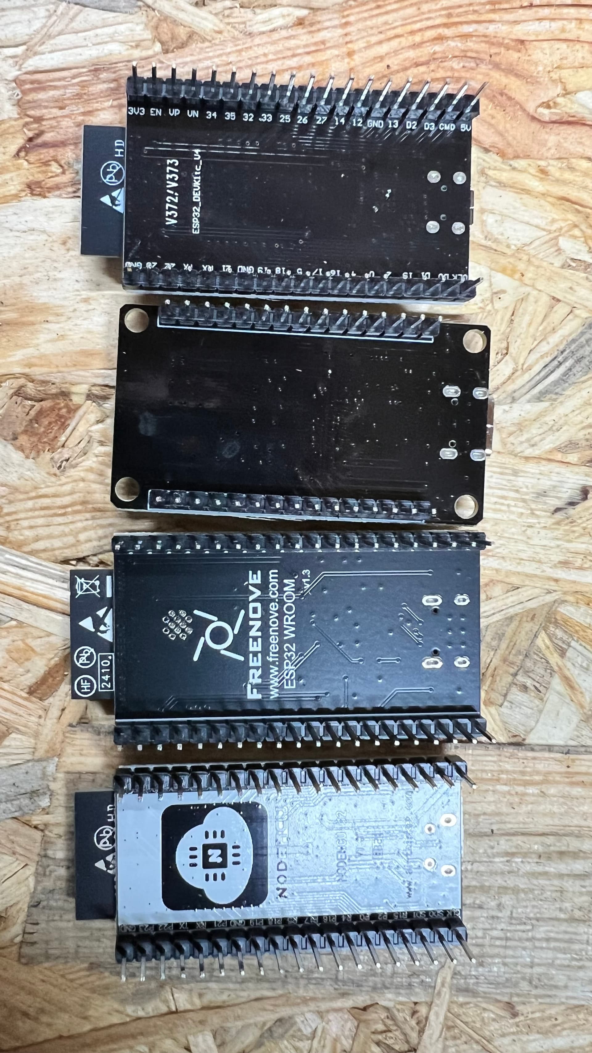

My first purchase from Amazon arrived (pack of 3, but cheap enough) but turned out to be only 30-pin. Then, after reading a topic “Which ESP32 is the right one”, the only version E I could find turned out to be 40-pin. I needed 38-pin, so try again. Ebay came up trumps (nothing to do with the recent election), a 38-pin version E which took a week to arrive. I immediately installed the firmware and went to place it into the Jackpot board, only to find out that the distance between the two rows of pins were too narrow, by about 3mm :face_with_symbols_over_mouth: :face_with_symbols_over_mouth:
I then read that there was not much difference between the version D and E. Version D’s are readily available, so I got one of those.
I have found, so far, that the only difference seems to be slower file transfer speed when setting it up.

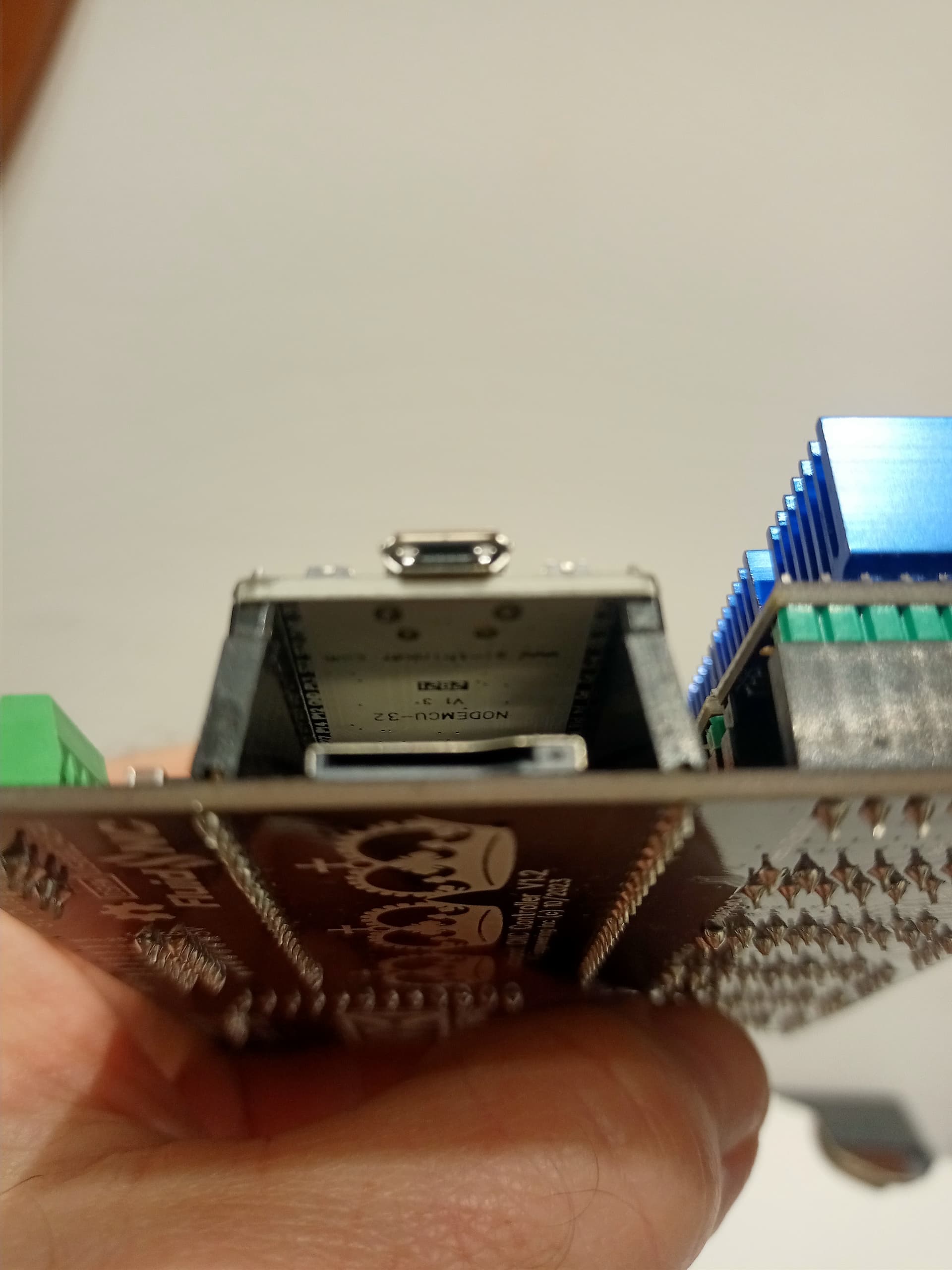

These will still work, just flex the headers in. I shipped 50 or so out this way when sourcing was slow.

Was going to message on this subject but found i am not the first :). I bent the socket and legs a bit.
