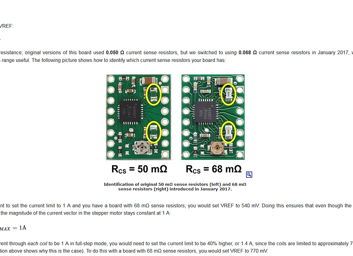

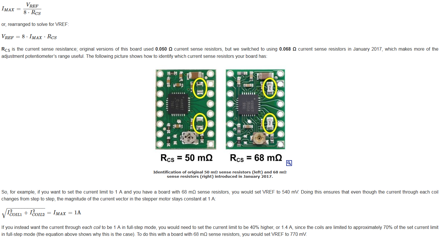

Are you sure that your voltage/current calculations are correct?
The A4988 drivers are sold with a wide range of current sensing resistors, between 0.05 ohm and 0.2 ohm.
So first double check that, on the pololu site you linked they show where to find these resistors on the driver:
[attachment file=“pololu a4988.PNG”]
If you got them directly from pololu they should be 0.068 ohm, but for example I got mine from china and they are 0.1 and 0.2 ohm…
If that is correct I would add a fan. Mine got pretty warm too, after adding a 80mm fan they feel completely cold to the touch.
