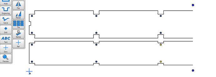

So, as it turns out, I had used my 1/4 hardboard for something else (it sucks getting old and the memory goes). Unfortunately, I was stuck at home, and I could not get more, so I thought I would spend the evening figuring out how to split a job.
After a couple of hours, I am stuck on how to split the job. Obviously, it has to be more than splitting the SVG file in half that the strut generator produces.

The way I did it using Estlcam was:
  1. Import the svg into cad (I use onshape)
  2. Add two reference pin holes to the svg and export it
  3. In Estlcam rotate the drawing to the correct orientation
  4. Set the left reference hole to zero
  5. Delete the sections of the drawings that hang off the front. Then use engrave instead of part.
  6. Set up the job and remember to put in holding tabs and set the depth for the two reference holes to cut deeper into your spoil board. (it’s a good idea to do some test cuts to make sure your dowels fit)
  7. Save job as struts_step1.gcode
  8. Back to step 4 but this time flip along the horizontal and don’t cut the reference holes save as step2.gcode
  9. Run step1
  10. flip the board use the reference holes and dowels to align it
  11. run step2
  12. In my experience find out they don’t fit and spend a bunch of time debugging speeds and feeds only to realize your bit is just dull so put a new bit in and do it again.

I added holes at the centerline in fusion. Should they be to one side of center instead?
Step 5 is the issue. is that an estlcam function or the external DFX editor (I just downloaded LiberCad. And apparently clicking on a line segment and deleting is not a thing (looking for ungroup)
You’re looking for Explode. It should be in the Modify menu.
If they’re on the center line they should be fine as long as they are symmetric around the flip axis. The way I did it and is shown in the video the holes are on the flip axis so you put the same hole on the same spot on the spoil board. If they’re somewhere else and are symmetric around the flip axis you can align one hole on the workpiece with the other hole on the spoil board etc.
I must be doing this wrong. I edited the strut plate, but estlcam throws an error if I use part and engrave looks wrong. this is how the drawing looks
With engrave it uses the line as a midpoint by default but you can choose one side or the other.
Doh! I should have looked for that.
