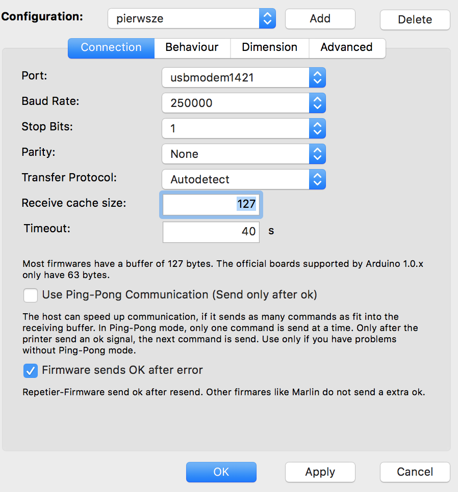

Now step motors start to move but I think there is a problem. Motors seems to could not find iddle possition after moving and gets noisy. For me it looks like some move parameters are wrong in the software or there is an issue with power input. Now I have no idea where to start , please advise. Below you can find screenshot from Repetier configuration.

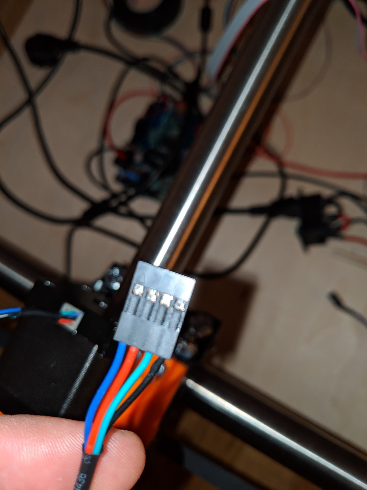

Hi
I disassembly motor and looks like on picture below and i wire it blue, red, green, black. From option which I tested I think this is the best but would like to confirm with someone more oriantated.
thanks
Michal
It looks like the connector should be wired blue/black/green/red. The easiest way to confirm is to either do a continuity check with a resistance meter or take two of the wires and hold the conductors together - if the motor is hard to turn then you know they are connected to the same coils and should be adjacent to one another on one side of the connector.
Thank you BT your tip was very helpful. I hold two pairs and check resistance on motor (motor hold shaft once it is correct). Pairs are black-green, blue-red. Now X-Y is working very smooth as expected. Now I have problem with Z axis. I changed the cables but Z motor is not working smooth (I tried all possible cable combination but this one was definitely fine). I remove motor leaving only screw and it is not working smooth but once I connected Z motor to X slot on board (single slot in mini Rambo) and everything work much much better (As expected). For Z access in miniRambo I have two slots I checked both in both same problem, should I wire it differently?
