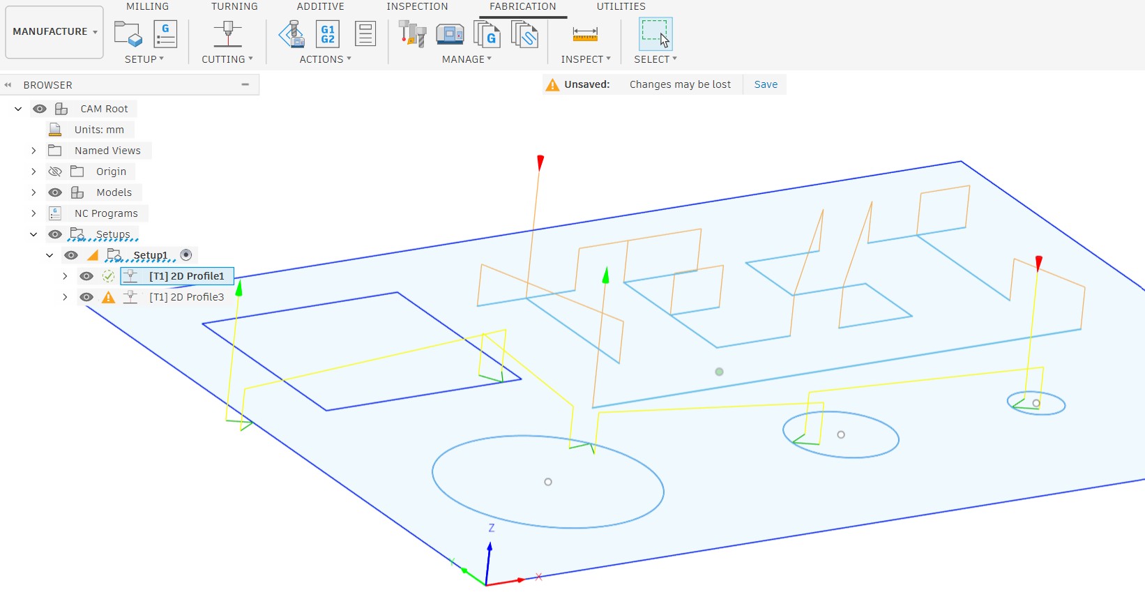

No Z moves
I have a LR2 with Jackpot3. When I post process from Fusion using MPCNCV3.0, set for GRBL, the exported g-code has no z moves. I didn’t use probe. Is there a parameter I missed?

Which version of the post processor were you using?
The most likely cause I can think of is that the tool was set to 0 or to a jet operation.
