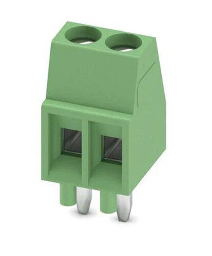

Hey just wanted to follow up. I just figured out what was wrong with your board.
The power connector, both positive and negative sides, had gotten overtightened and broke the solder joints.
The issue is bad connection with power. Touched them with a soldering iron and all is good.

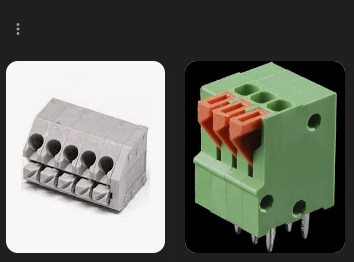

This is the second board to have this happen (out of more than 1200 at this point). The sockets themselves need very very little force, they get clamped in with a wedge. I will put a note in the instructions and will be looking for some sort of new connector, maybe the wago style. That I have seen, or the other spring loaded style.
I fixed one of mine that broke this way.
You should consider having the connector bonded with some epoxy glue around it or switch to a connector that mechanically retains the terminal block body without needing the through hole leads to do it.
I bet one of these is less expensive, and probably easier for the user.
I can swap out the other ports as well to get rid of the need for a tiny screwdriver.
Wow. I don’t think I was very aggressive with those little screws but my fine turning might not be as fine as needed. That would explain the intermittent nature, I’m guessing between just moving around a bit and a little bit of heat was killing the connection.
I like the push/snap connections better. It would become more or less tool-less install with those.
I prefer the super solid screw terminals myself, but if we swap to push terminals I will need to emphasize people securing the wires more. You would not believe how many people have issues with plugs coming loose because they did not secure any of the wires near the board.
I am pretty sure this will be a good change.
Considered fewer connectors that terminate more pins, so harder to over torque. Also, using larger 3.08mm instead of 2.54mm for screw terminal connectors (harder to strip, but easier to torque, maybe that’s bad)?
Nice pics and instructions on how important strain relief is seems like good idea.
I’m on the fence about this. I really like spring compression terminal blocks but understand why other folks like screw compression.
For applications like the one on the Jackpot, I’ve used this style in the past- note the anti-spin studs in the design. You put through holes in the PCB that accomodate these, and then you can’t break the solder joints while torquing the screws.
