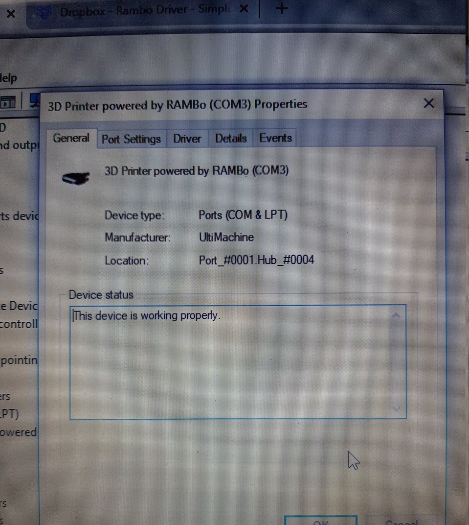

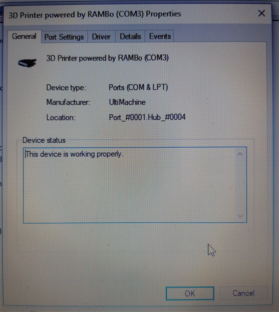

hi there, im running on
windows 10,
rambo mini board from V1
drivers for rambo installed , bit and baud rate the same. board has power and shows up in my device manager on windows.
but when trying to connect on repetier host i get the message,
so start signal detected - forcing start
What program are you trying to connect with, what rates are the same as what, is it plugged in?
im using Repetier Host to connect to the Rambo.
the rates are 115200 (250000 is not an option in my port settings)
com3 is the port. both are the same in RH and device manager.
i have tried other rates too but the same outcome.
i have tried to connect with local host on and off also.
