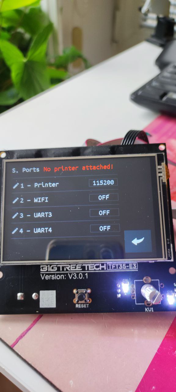

No printer attached SKR PRO V1.2 & TFT35 E3 V3.0
i have bought on Aliexpress the couple:
BIGTREETECH SKR PRO V1.2 32bit MotherBoard 3D Printer Parts TMC2209 SPI MKS GEN L RAMPS 1.4 SKR V1.4 Skr2 Kossel
BIGTREETECH TFT35 E3 V3.0 Touch Screen 12864 LCD Display WIFI Module For SKR MINI E3 V3.0 Octopus Pro Ender3 CR10 3D Printer

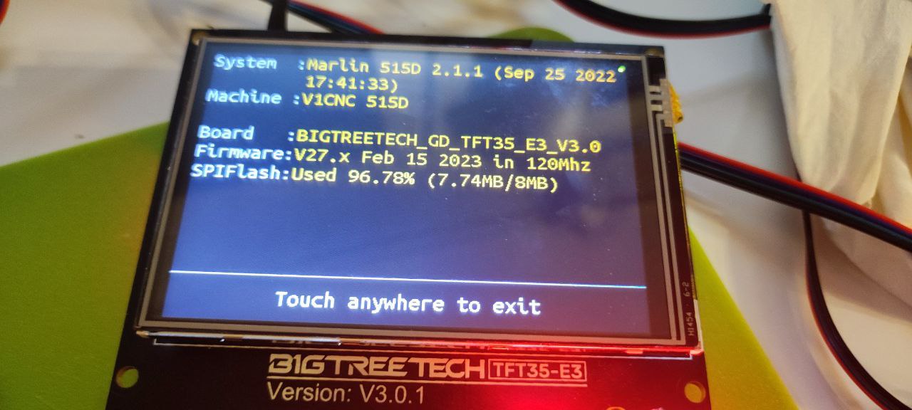

upgraded the software to:
V1CNC_SkrPro_2209-2.1.1
BIGTREE_GD_TFT35_V3.0_E3.27.x.bin

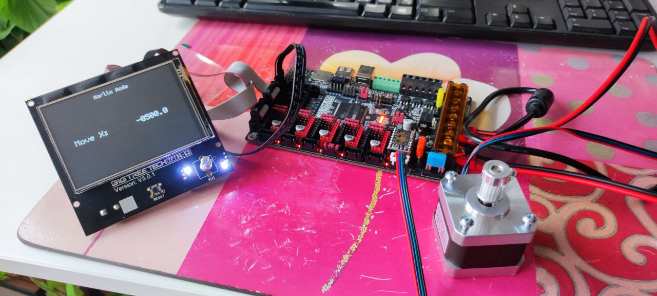

I have connected control and TFT boards as :
TFT - RS232
EXP1 - EXP1
EXP2 - EXP2
connected 1 motor for X coord to test.
the RS232 baud rate is 115200

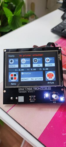

In touchscreen mode I have a status No printer attached

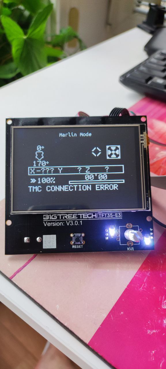

in Marlin mode i have a status THE CONNECTION ERROR , but can rotate the motor in Motion - Move Axis - Move X menu.
video5235605059840003898
it is most likely because y ou have only one stepper driver inserted.
try to insert all stepper drivers and test again
(found this advice on internet)
@Frits thanks a lot!
I have got a good status in Marlin mode and still have a bad on on Touchscreen mode(( Dont you have any good advise in this case?)

Edit: from your post above, the Marlin Mode is showing you have.a TMC error, because only one stepper is installed.
The advice below is correct:

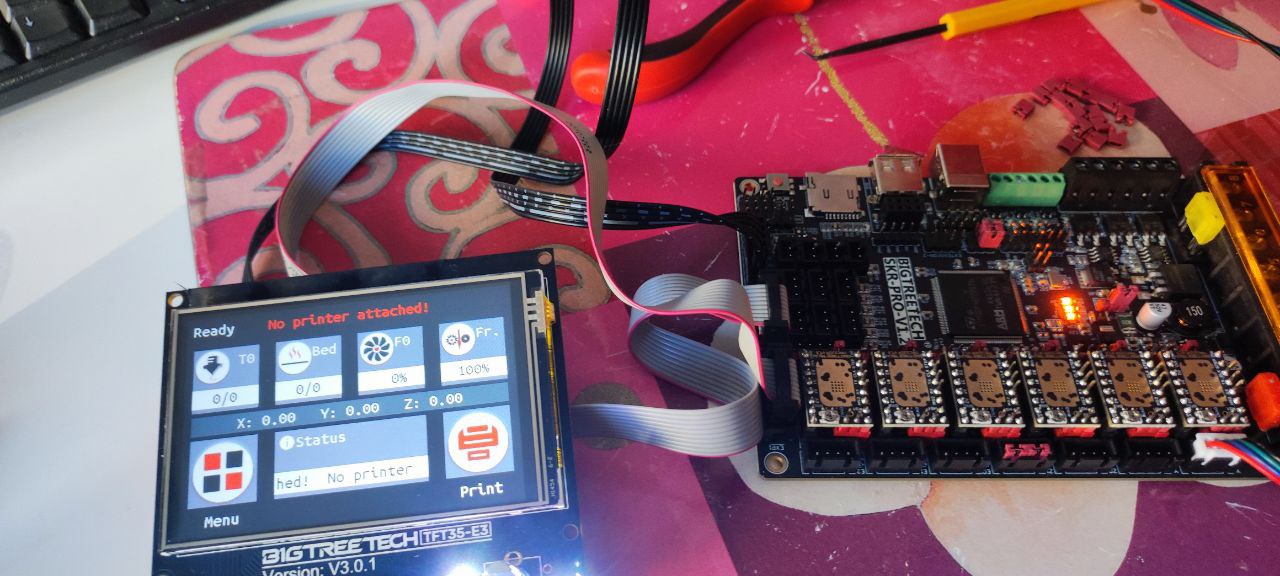

@MakerJim hello! i have bought a new skr pro v1.2
the RS232 wiring is on the photo.
the firmware is V1CNC_SkrPro_2209-2.1.1
The touch mode has the same error " no printer attached".
The marlin mode and printrun-2.1.0_windows_x64_py3.10 can control the X0,Z,Y0 engines movement.
The COM settings are 115200/8/n/1
BAUD should be 250000
@Bartman it works! Thank you!
