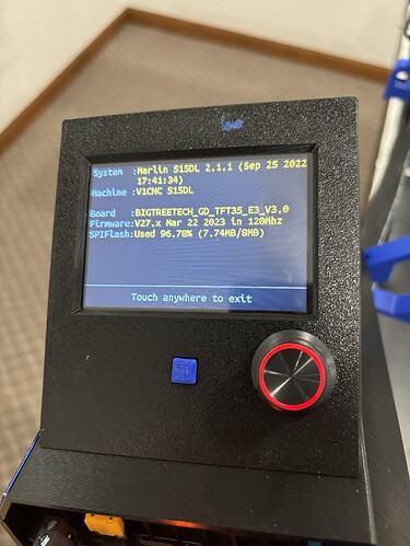

Finally finished the assembly of my LR3 and found problems with the dreaded “No Printer Attached” message on the TFT. I’ve trolled the forums here and tried what worked for many others:
  • disconnected cables except for input power and the black serial cable
  • downloaded and reinstalled firmware for both SKRPro and TFT35 (both purchased from V1 shop a couple months ago) - extension changed for both sets of files so I presume they were successful (no change of operation)
Behavior is consistent - after clicking the BigTree Tech icon and the menu appears with the red “No printer attached” message at the top of the screen. None of the icons are clickable and the screen quickly reverts to the startup menu you get after power is initially turned on. Clicking the icon multiple times eventually causes the TFT to sound a continuous loud tone until I hit the reset button.
One additional thing I tried - I mapped the wires between the TFT and SKR board and it appears that the RX pin on the TFT goes to the RX pin on the SKRPro (same for TX). Normally I see these swapped so I swapped pins 3 and 4 on the SKR end but didnt help.
During the troubleshooting I also reversed the four pin connector on the SKR side, but the TFT wouldn’t turn on.
Any other ideas?
Thanks for the help!

From the TFT package, I chose BIGTREE_TFT35_V3.0_E3.27.x.bin first and later tried the GD version as my TFT has a GD chip, but saw no difference. The config.ini specifies 250000 (option 7), I have no idea how to check the SKRPro side.

Wondering if BIGTREE_GD_TFT35_V3.0_E3.27.x.bin is the right one, given the Info Screen above. There is a GD chip on the TFT board, but the info screen may just be identifying the current firmware too.
