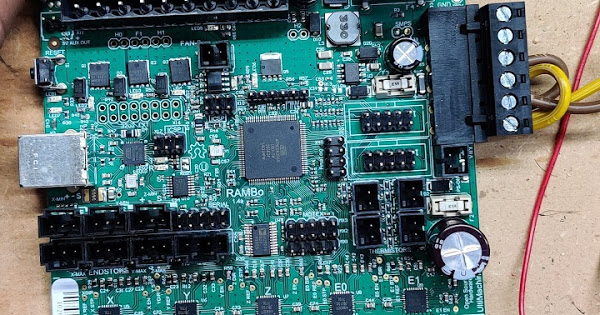

Only the steppers and power connected (not connected to the PS in this shot):
Google Photos
All the fuses are good:
Everything looks good to me, but when I apply power, there’s no green light, no life at all. Am I missing something?

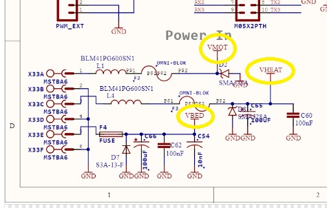

Ummmm…what is the meter connected to when the display reads OL. ?..coz if the answer is a fuse then the fuse is blown. According to the schematic, the green LED is fed by Vcc which comes from an LM22675 which is powered by VHEAT (the 12V input from power connector pins 3&4 via F3). Only other thing I can see is a jumper on JP3 will disable the Vcc power

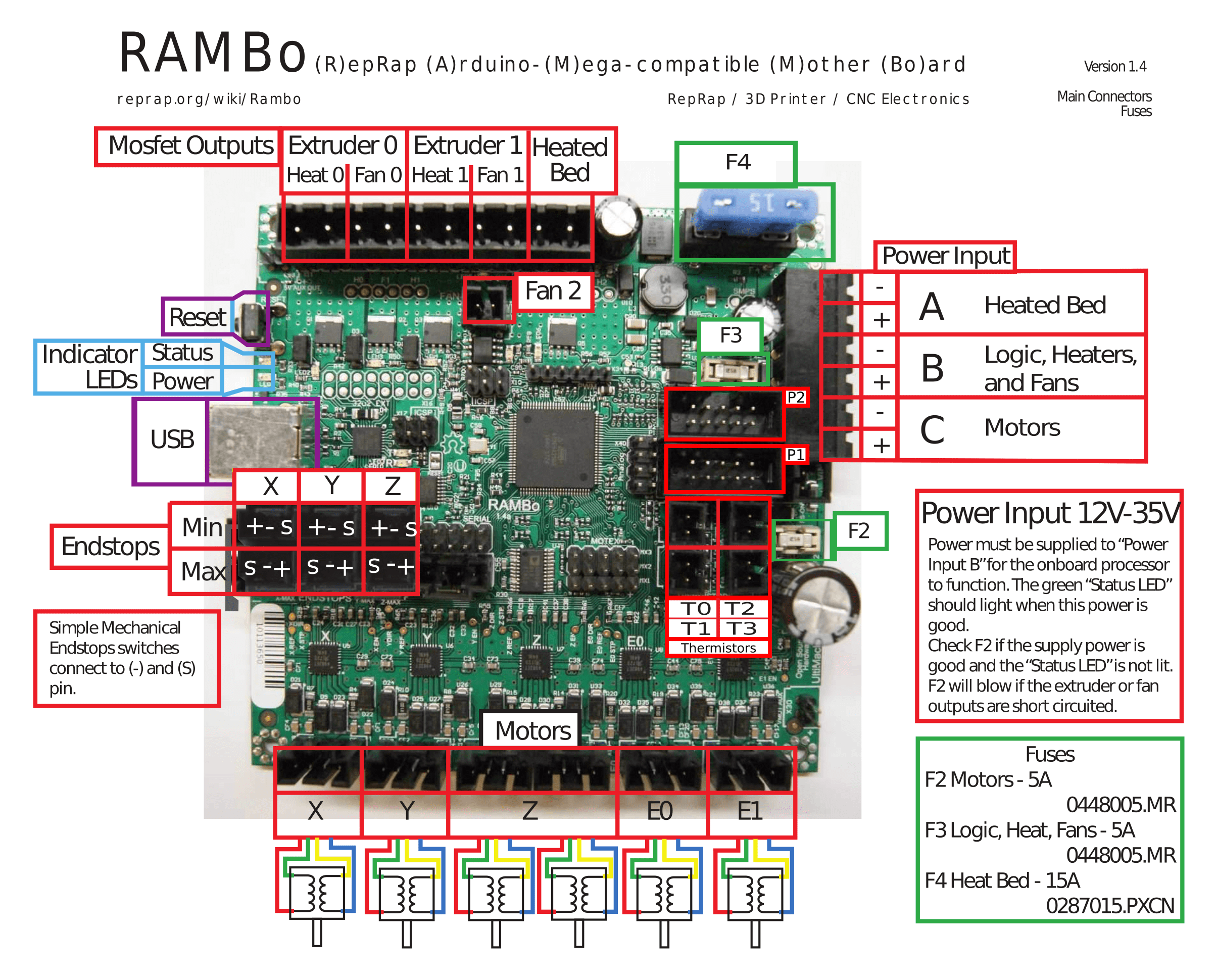

I don’t understand what you mean by a component being powered by VHEAT. I have the 12v power connected to only B&C of the Power Input block. Do I need to jumper it to ā€œAā€ also?
Also interesting, and I have no idea if its normal, the voltage drops to 0.9 vdc across the power input when connected to the board.
What kind of power supply are you using? 12V/5A is the recommended minimum size.

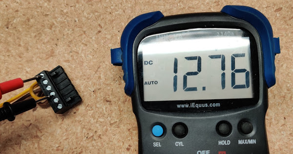

The voltage reading from the supply is the very first image. 12.76 volts. But, it drops to 0.9Volts when connected to the board.
Take the green adapter plug off and cut the power supply cord to use the bare wires. That has proven to have a loose connection.

FYI - the VHEAT is a term used in the Rambo 1.4 schematic diagram, it refers to the 12v power input for the ā€˜Logic, Heaters and Fans’ power input (B)
