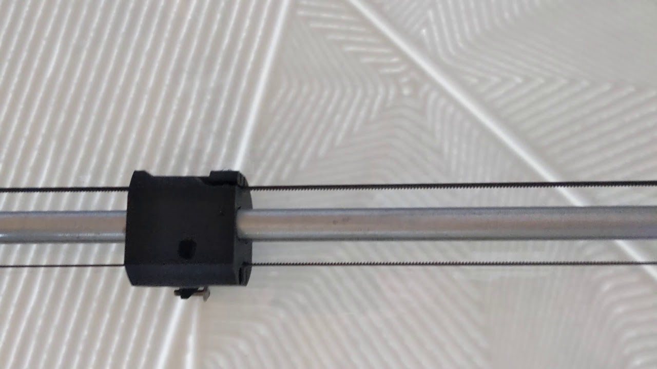

Wait, what? That is from on top of the sand? I kind of like that… Why am I hiding this beautiful mechanism?
Laying under it, on the cold hard floor for the 30th time over the last few days.

Because it looks like magic that way.
The coffee table that I’m using has a lower shelf… I’m considering putting some mirror there so you can see the mechanics once I’m not longer lying on the floor under it.
Wait, you have a glass bed and that is from underneath? I am so confused.
I bought two pieces of identical glass, the marble is between them.
I’ll take a full picture after some coffee
