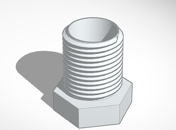

Okay built…bummed it was not perfect on my first attempt…back to CAD…happy but I have one last issue that I need some voices on.
The magnet.
I have it in a round hole and a screw under it to adjust it. If I go back to just a hole and shims the build would be centered and ideal.
I know some of you are not using the exact magnet I am so the hole would be problematic for some of you anyway as it is more constrained (I do plan on carrying them in the shop for easier access). So if you all have access to the solid files you could easily edit the part to fit your magnets, and shim to fit your build.
The screw is easy but forces and asymmetric work area. Shims are kind of a bummer once…but you never touch them again. This would allow for symmetry and a larger overall centered useful area. Symmetry just means an easier build…calculator, and instructions.
So I think I am going for the shims like it has been. Although I do believe it will be easier this time due to a much more constrained system, so measurements are far more exact and stable. The current zen can shift and cause the magnet to hit. The new one can not.
Well I just think I talked myself into it. I wanted adjustments because it moved before. Now that is does not so they are not really needed.
I would go with the shims, and then add a 3d printed shim model.
A 3D printed shim (even if it is literally a cylinder) would be able to be scaled in the slicer to fit. But even without that, there are washers or spacer models or just scrap paper or plastic.
I was just drawing this up yesterday.
I went with something a little different. A “bolt” slightly oversize for my magnets (1/2" diameter) 3D printed, and fit into a threaded hole. I chose 5/8"-18 as the basic thread for this. I planned to clean up the threads (and the threads in the center shuttle) with a tap and die set, because I happen to have them.
This gets around the offset angle of the screw, because the whole assembly is centered. It also allows for adjustment at any time, or fixing it permanently by staking it or melting in the threads. It’s easily adjustable for different magnet diameters, shapes or lengths, if you do any design stuff at all. The tricky part is having the tap and die set, but with a good enough printer you shouldn’t even need that.
All that said, I’m probably overthinking it because my magnets are a set of discs instead of one piece, and just sucking it up and paying for the shipping is probably a reasonable solution.
Yeah so I can add a mag shim, easily Z scaled. I used a nut and paper on the previous one.
I do plan on supplying shims for the corners since this version is lower profile, ~4mm clearance. So They can be Z scaled as well. Supply them 1mm thick so the math is easy.
I will try to CAD it up and test it after the boxes today. I don’t have any fasteners on the magnet though so that could be an issue. I will see if I can sneak a screw in even if it is just to stick to. Hard to describe how tight everything is to make it fit the old footprint.
TLTR I think I got it. I have to print out a full set of parts and rebuild it to test. 0.5mm to spare.
