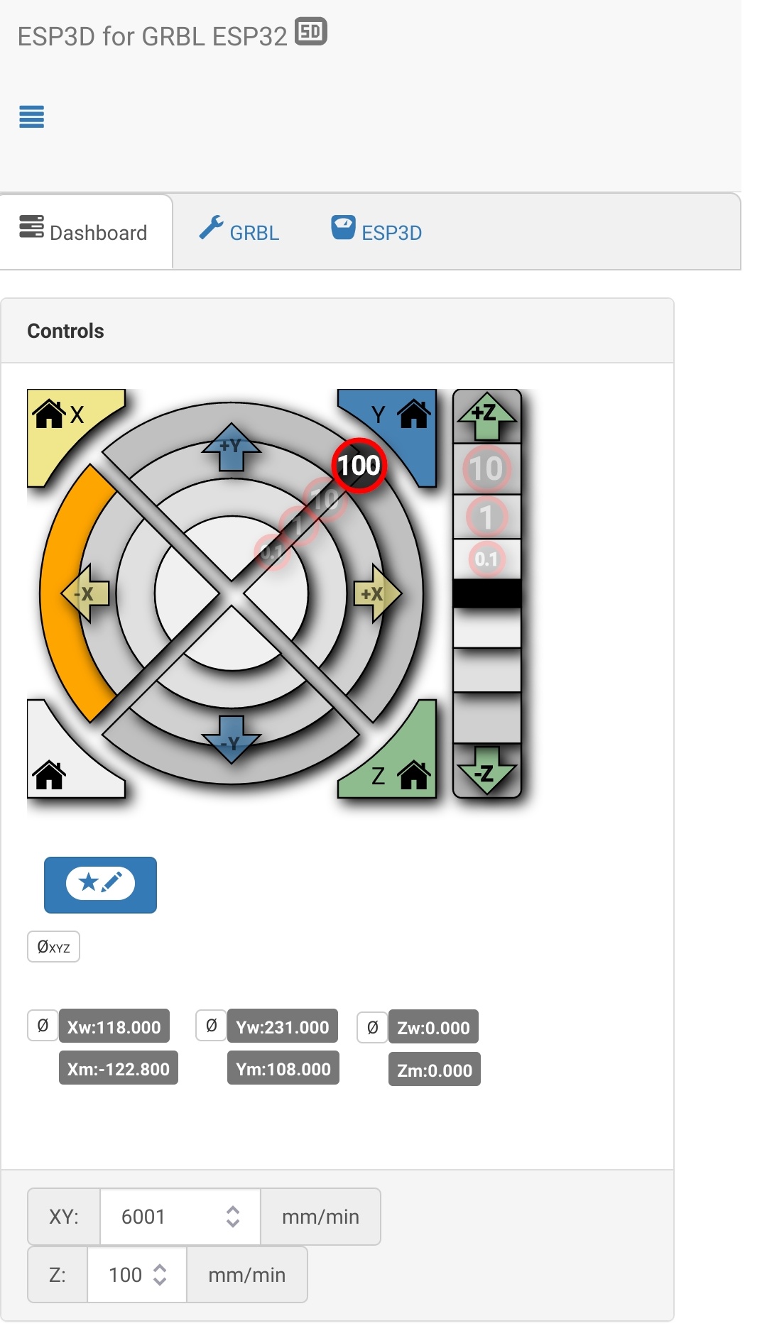

I’m running mine now, at 6000mm/min, doing a table wiper. I have a very small misalignment with my homing switches, and the ball clacks against the end of the table at Y=MAX a little. I could fix it by redefining the table to be 1mm shorter in sandify, but I’ll probably fix the home switches.
It’s running great otherwise. A fresh box of baking soda, so there are a few small clumps, but it’s running at at least half again as fast as I ever got it to work with the first build. (Wiper finished, so now I’m running some of the same files that I used to, just… faster.

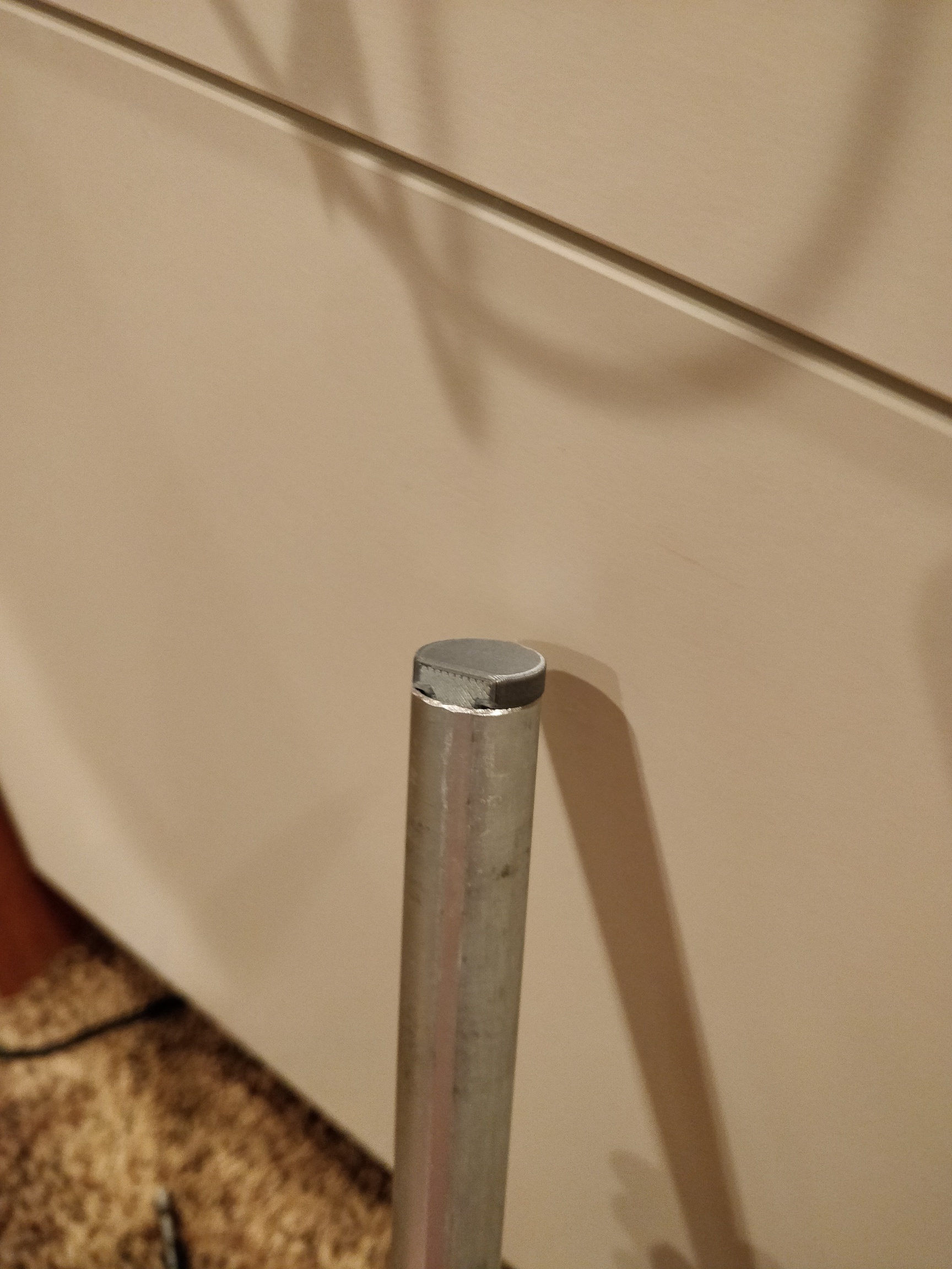

My 1/2" tubes are a tiny bit short so I am printing some extensions (*not to spec):
They add 4mm to each side and I printed them so the planes go into the tube. I hope they will keep it straighter. I just have to get it back together.

Wait… 6000mm/s? Like 6m/s? Or 6000mm/min? Like 100mm/s?
6000 mm/min, yeah 6m/s would be pretty extreme, lol. 100mm/s is trucking right along. Most sandify stuff can’t go that fast through the 8 bit arduino. Dunno if its the SD card rate reading the instructions, or just recalculating the movement, but it gets a bit jerky in the text, and at the small points of some shapes.
I actually don’t plan to run it that fast, the speed it was before is good.

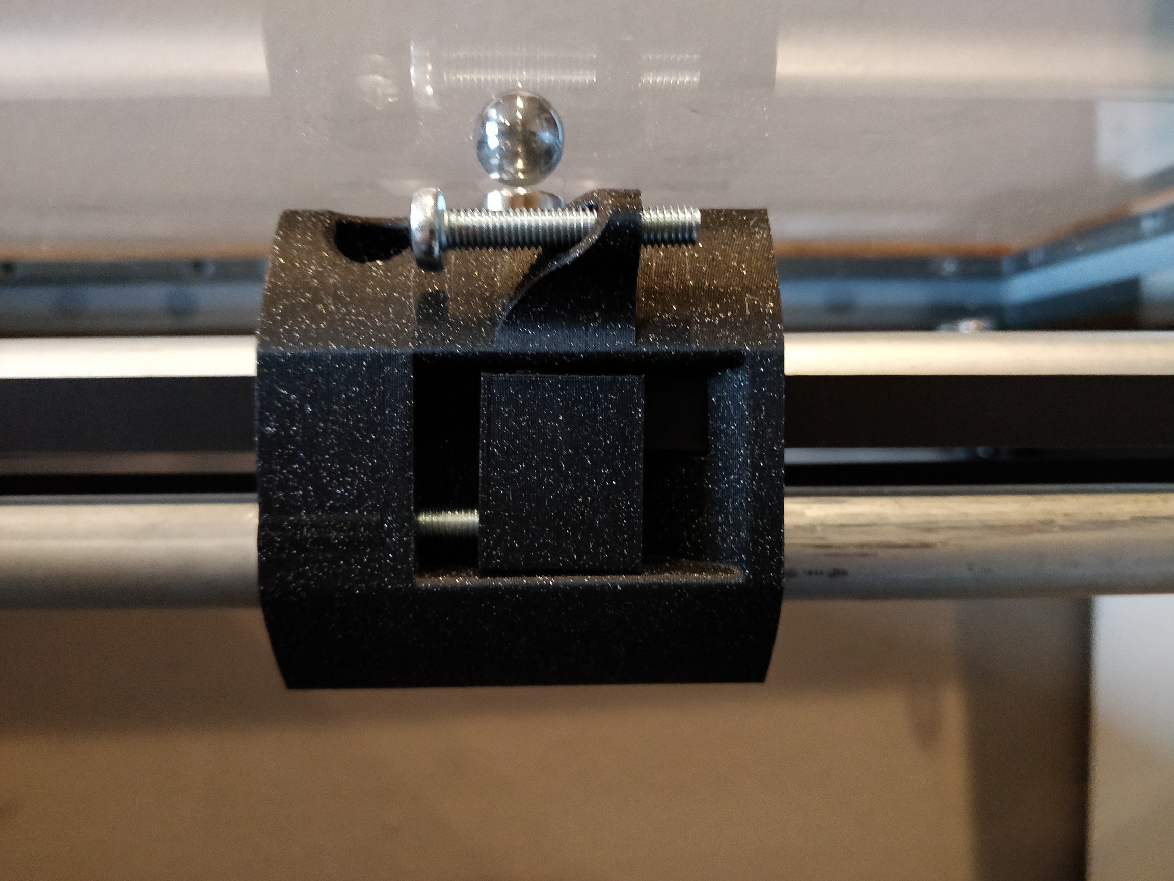

To get the belt into the tension block, there’s not much room. It has to come through that little slot, and then into the block with only a couple of mm to spare, and it comes in from right next to the table. I couldn’t see it and get my fingers in there at the same time.
Pull the belt tight, and square up the rails. Mark where it comes through the slot, so you can use that as a guide for where the tgension block will go. If you unbolt one of the pulley corners from the table, and pull the 1/2" conduit out of one of the trucks, you can then pull several inches extra slack through the slot so that you can more easily put the tension block on the belt. Then once the block is on the belt, pull the slack out, put the 1/2" conduit back in the truck, and bolt up the idler pulley corner. Shaved a lot of time off of my assembly, since I spent a good deal of it fiddling with that block. The worst was the time I got it back together, then there wasn’t enough movement in the bolt to properly tension the belt, so I had to pull it out and do it again.

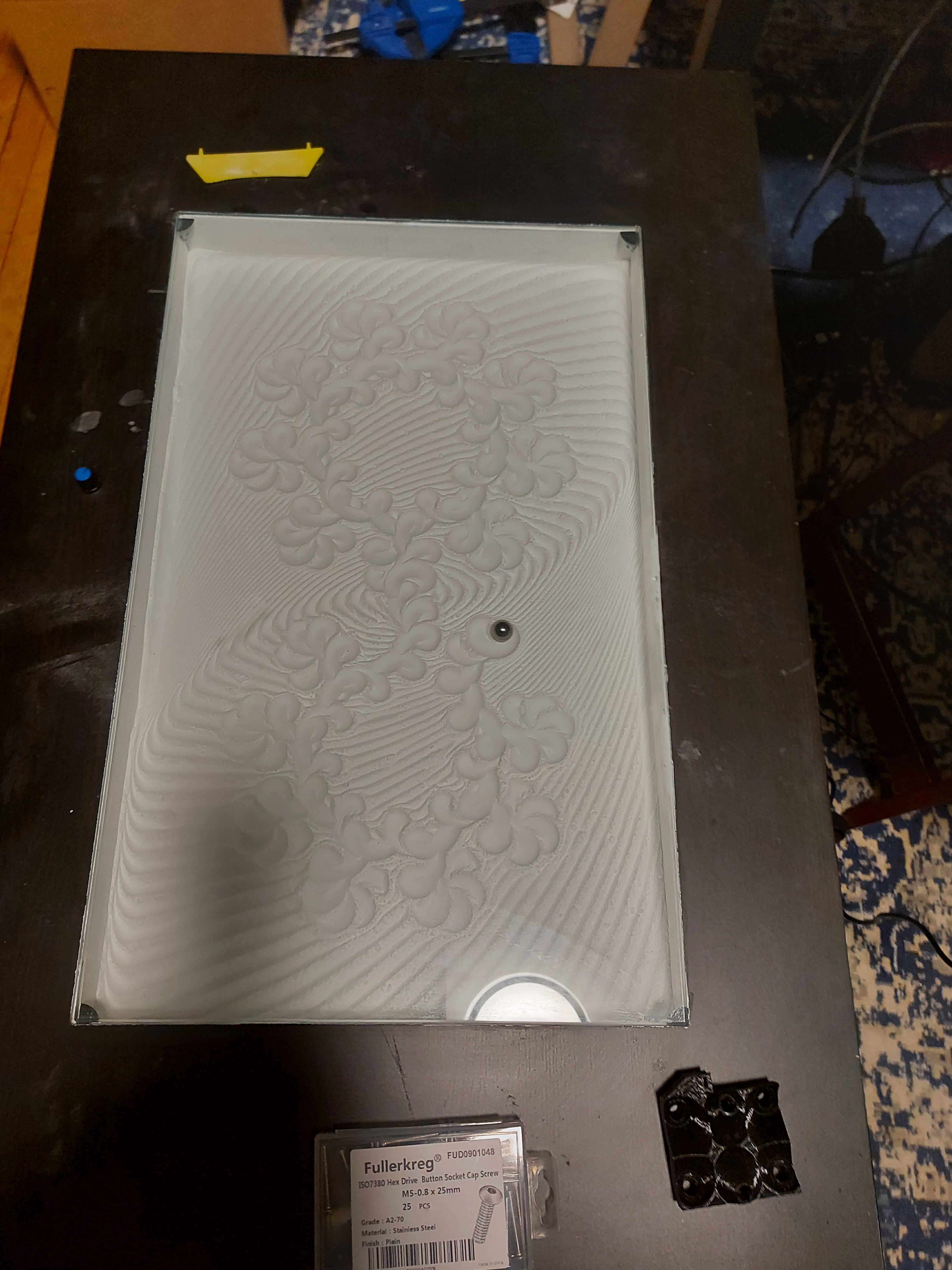

Everything about this build has been great. The only part that really stressed me out was/is bolting the corners down. It is hard to get them where I want (and the cabinets aren’t perfectly square, who installed these?!). Having to do all of that with everything already assembled is tough. It would be awesome if there was a way to clamp the tubes and stuff in place, and square while I was marking and adding the holes. It may also be that I am overly paranoid on perfection.
But honestly, this is a really fun and addictive project. I have 438 X and 421 Y and I have about the same amount of gap around the whole space (1 1/4"). This is really working well.

I was also a little extra paranoid about putting holes in the epoxy surface that I needed to be able to hold anything in there. I ended up snapping chalk lines for the hole locations, and pre-drilling.
I measured off of the .STL files (Not the most precise, but good enough for some #6 screws, I figured.)
I came up with the following for offsets from the outer edges (Which are 92.5mm away from the work area)
Y Offset, power corners: 50mm (49.95mm measured)
Y Offset, cross corners: 19.05mm (Which I figured was 3/4" so probably correct.)
X offsets, Power/Cross Corner 1: 10.5mm, 67.8mm
X offsets, Power/Cross Corner 2: 8.8mm, 66.2mm
Having pilot holes for the screws gave me a lot more confidence in mounting the pieces, but I still checked the diagonals for square before I bolted everything down. (For what it’s worth, the pilot holes were perfect off of those measurements. Less than 1mm difference in the diagonals, but that’s also based on the box that I made before to match the glass.

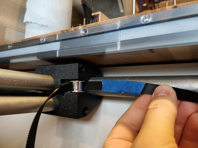

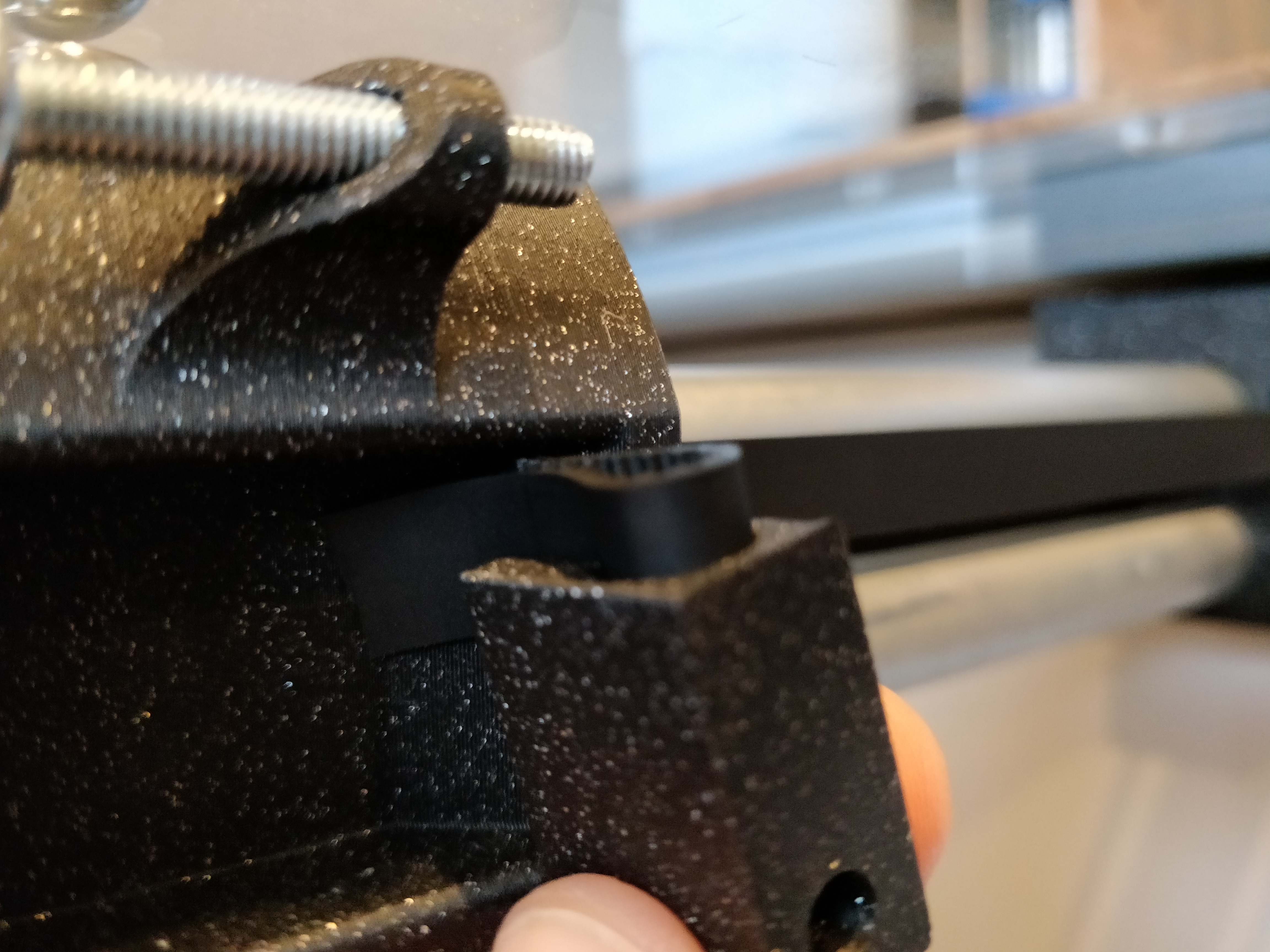

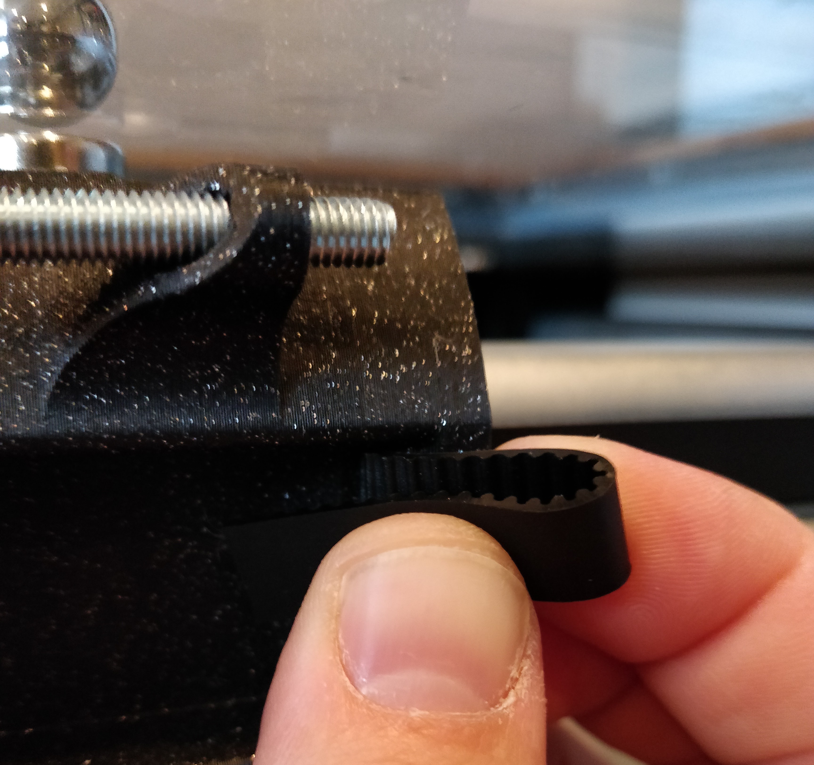

I needed to take it off, and I took some pictures:
Tightened it first with my fingers and made a loop. Pulling it to the right helped me keep that tension.
Then I held it from the top and got it started in the block. It is hard to photograph, because it just likes to pop in once you have it started.
Then I pushed all the way in, and trimmed the excess. I folded it back right and threaded the screw.
Here is a picture of how I got the belt through 2 tough spots. I just fed some scrap through the other way (from left to right in this picture) and taped the two ends together to snake it back through. It just needs to be strong enough to pull the end of the belt along the correct path.
