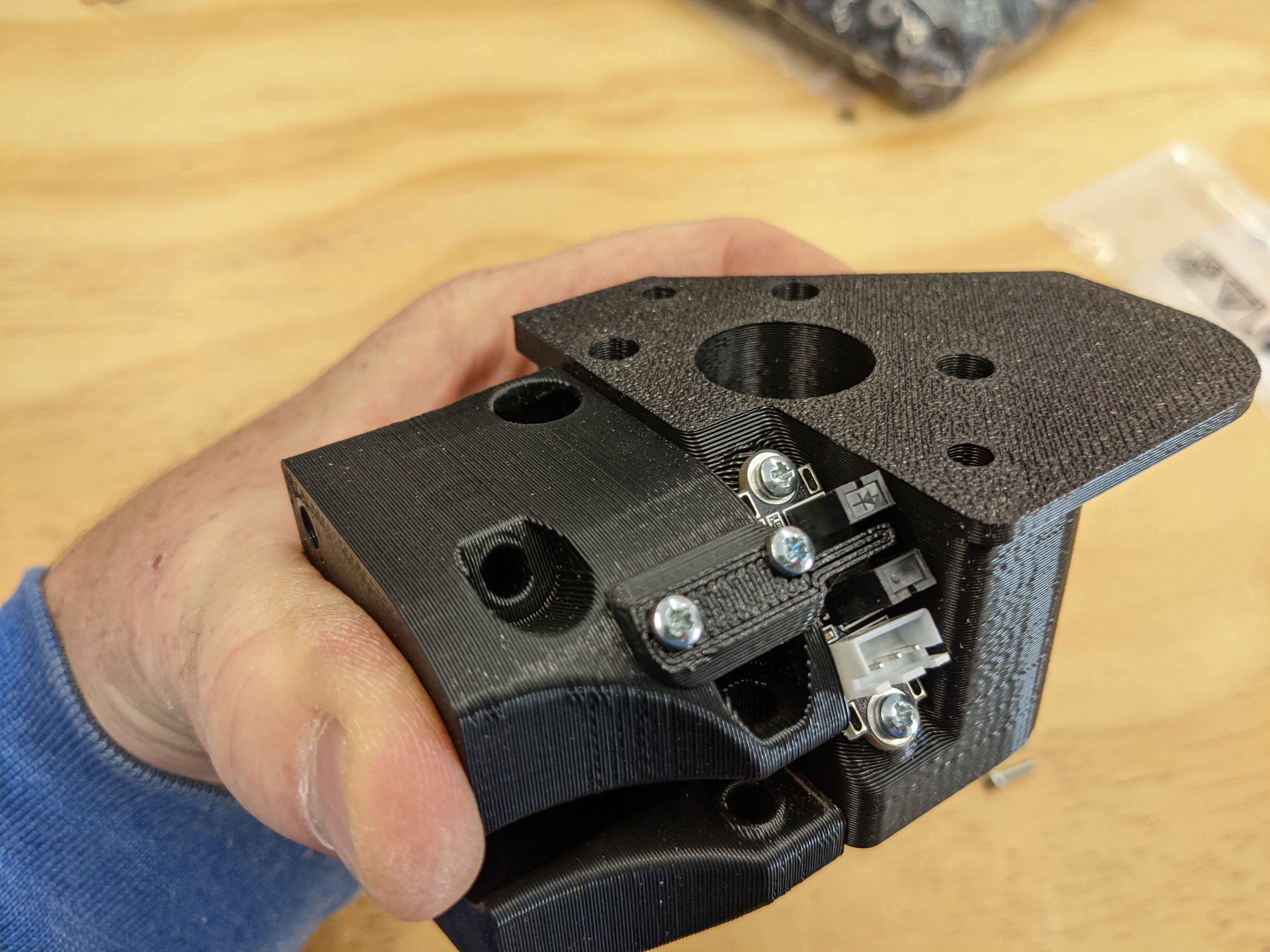

Update for everyone here. I have optical switches sitting on some actual parts. I need to assemble another Zen to use as a test bench real quick. Working upside down doing a half crunch is not my favorite thing. Need to be sure my triggers are correct and have enough clearance, and the homing sequence can be wrestled into working. Fingers crossed this is it.
This is my hack for the Y axis switch. Of course not as slick, but it works. I am re-doing the X switch, but that really means just adapting the switch mount.
I’ll re-print everything once the final design is out.
