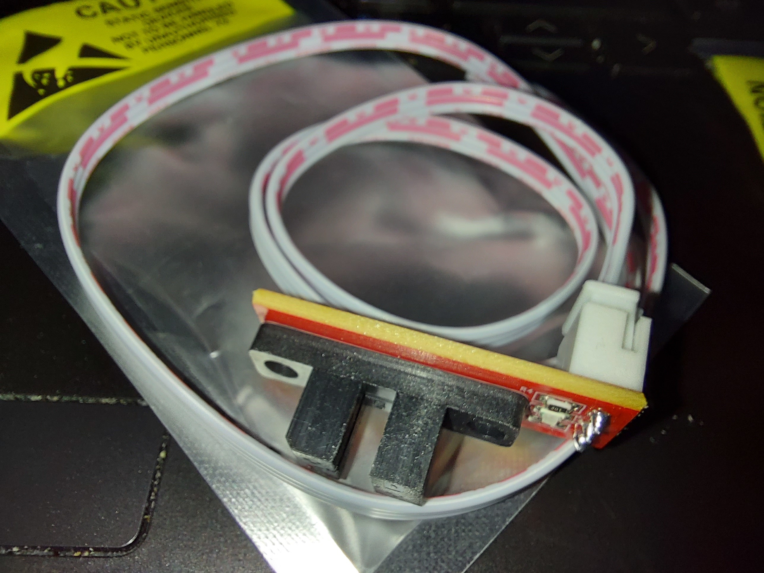

I also have some ideas for optical stops… Speaking of which…
These just showed up, so I ought to find my bag of them any second now.

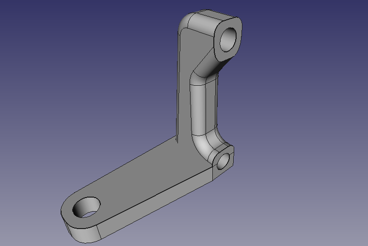

I have adapter parts drawn up, but forgot to account for the wiring harness coming out the back of the board, so I’ll be re-drawing adapter parts for the optical stops, though that’s probably premature, since I think Ryan will be changing the parts anyway. I think what I’m going to do for the re-draw will be to make separate pieces that hold the optical endstops but do not attach to the motor corner. They will just be stand-alone parts that work with the truck and shuttle (Maybe with the adjustment provisions for both.)

The optical switches seem to have been changed as well.
My old ones, in use on my 3D printer had mount holes spaced 3/4" apart. I had started with mechanical ones spaced the same, and dropped in optical switches into the same mounting solution. The new ones that I got the other day, just put the calipers on, and the holes are spaced 20mm apart. It’s not a big change, but I could not mount the new switches directly onto the old mountings.
There are a couple of other differences, too. The sensors stick out a little bit further from the mounting surface.
Now I’ve got to go re-do all my CAD for setting these up.
The optical switches are nice, sure, but I don’t think that they’re a good fit for the CNC, because chips. So yeah, it’s not like you can just substitute.

Ever feel like you just drew a 1985 era cell phone in CAD?
The idea is that it will hold the optical stop, allow it to pivot around the mount screw in the base to fine-tune the trigger position and trigger off of a flag on the magnet shuttle to signal home position. Right now, my solution is another of these triggering from a flag 3M taped to the truck for Y.

Anyway, the mechanical stops work with caveats. I believe that’s all in redesign at this point, so I’m going to fit my optical stops, and test them. It’s 2 more holes in the table, but small ones, since I’m using #4 wood screws to affix it. I think I might supplement it with the same 3M double sided tape that I’m mounting the flag on the Y truck with.
