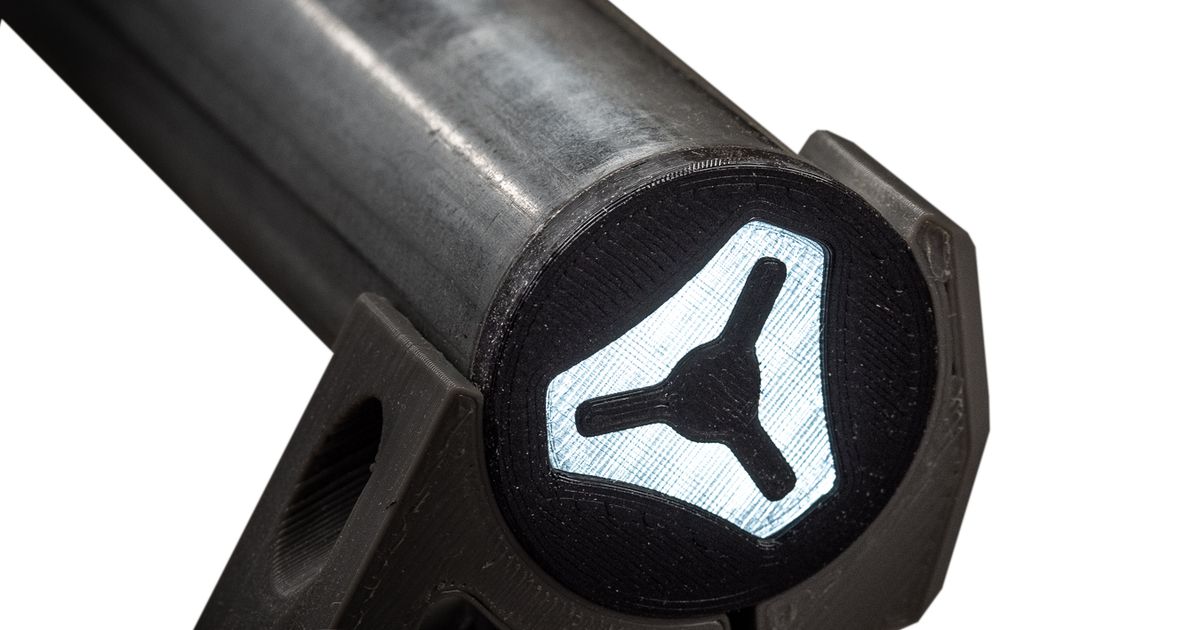

If it fits in the tube it will work - sorry about the delay - man these things take time!

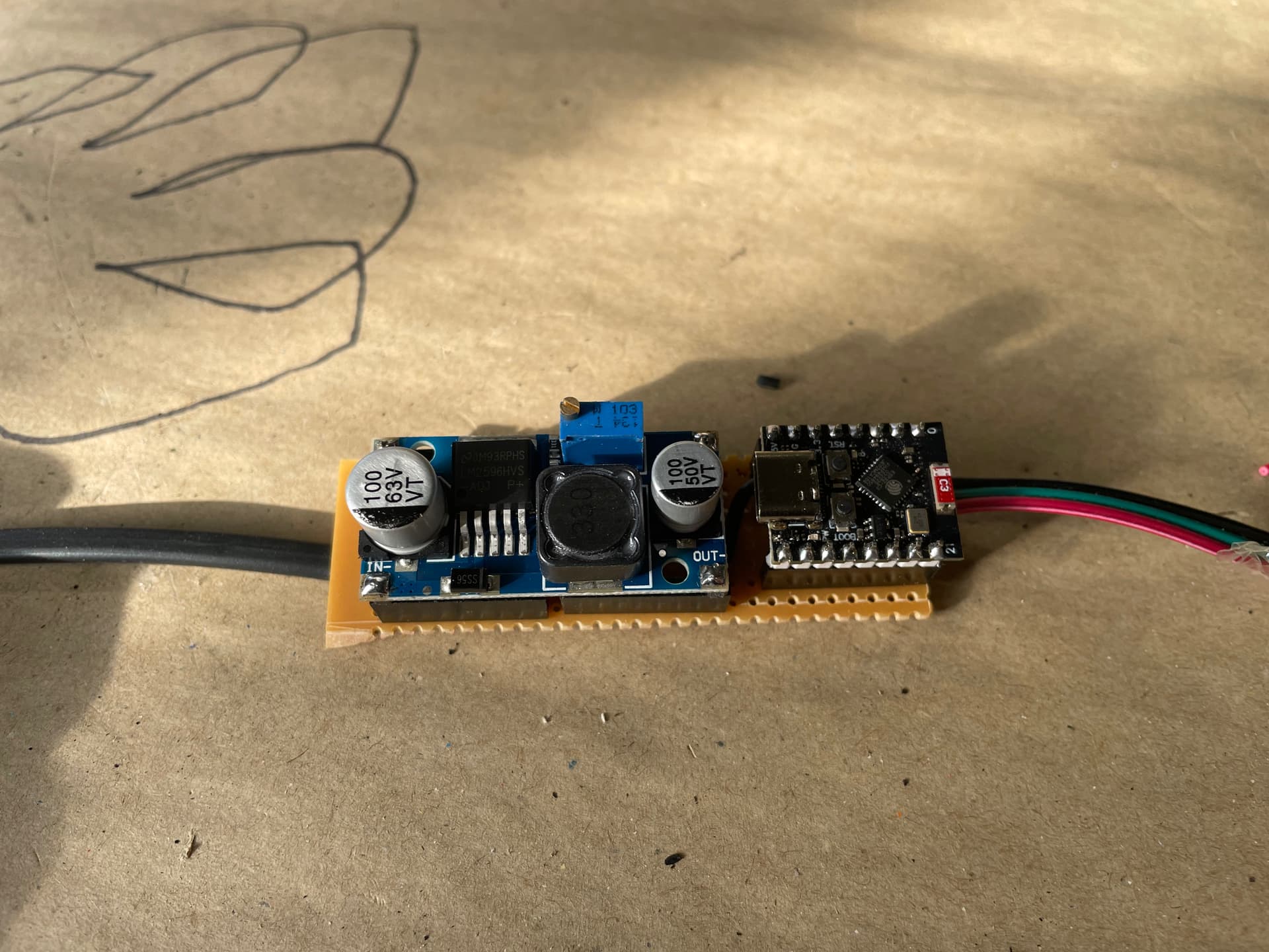

I also have to see if I can find a buck converter to use my 24v power to 5v.
When I say ‘find’ I don’t mean online. I mean I know I have some… somewhere… but where did I put them??

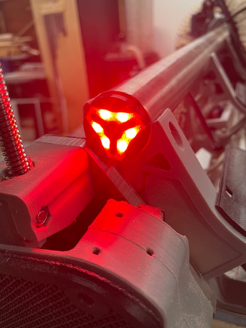

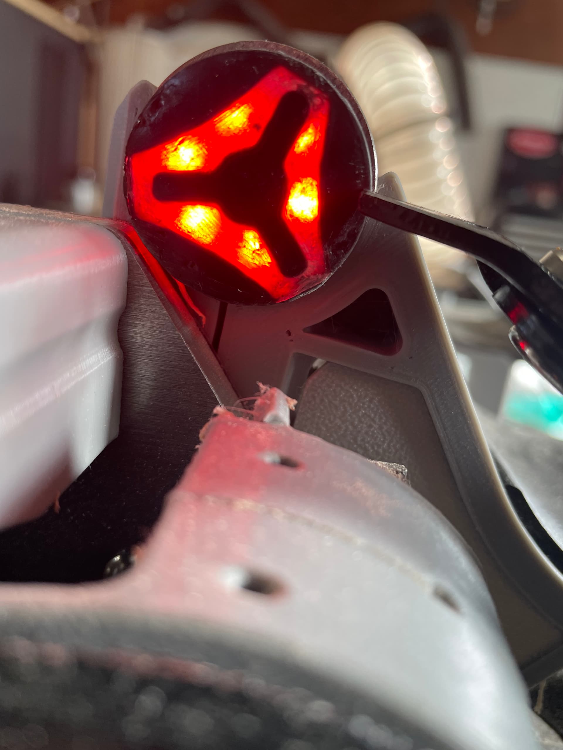

The logo on those are a little large at some smaller tube sizes if you want to print in clear, I’v e changed the parameter slightly to fix that for the clear version coming later today!

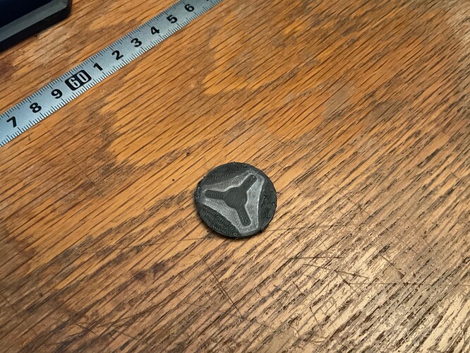

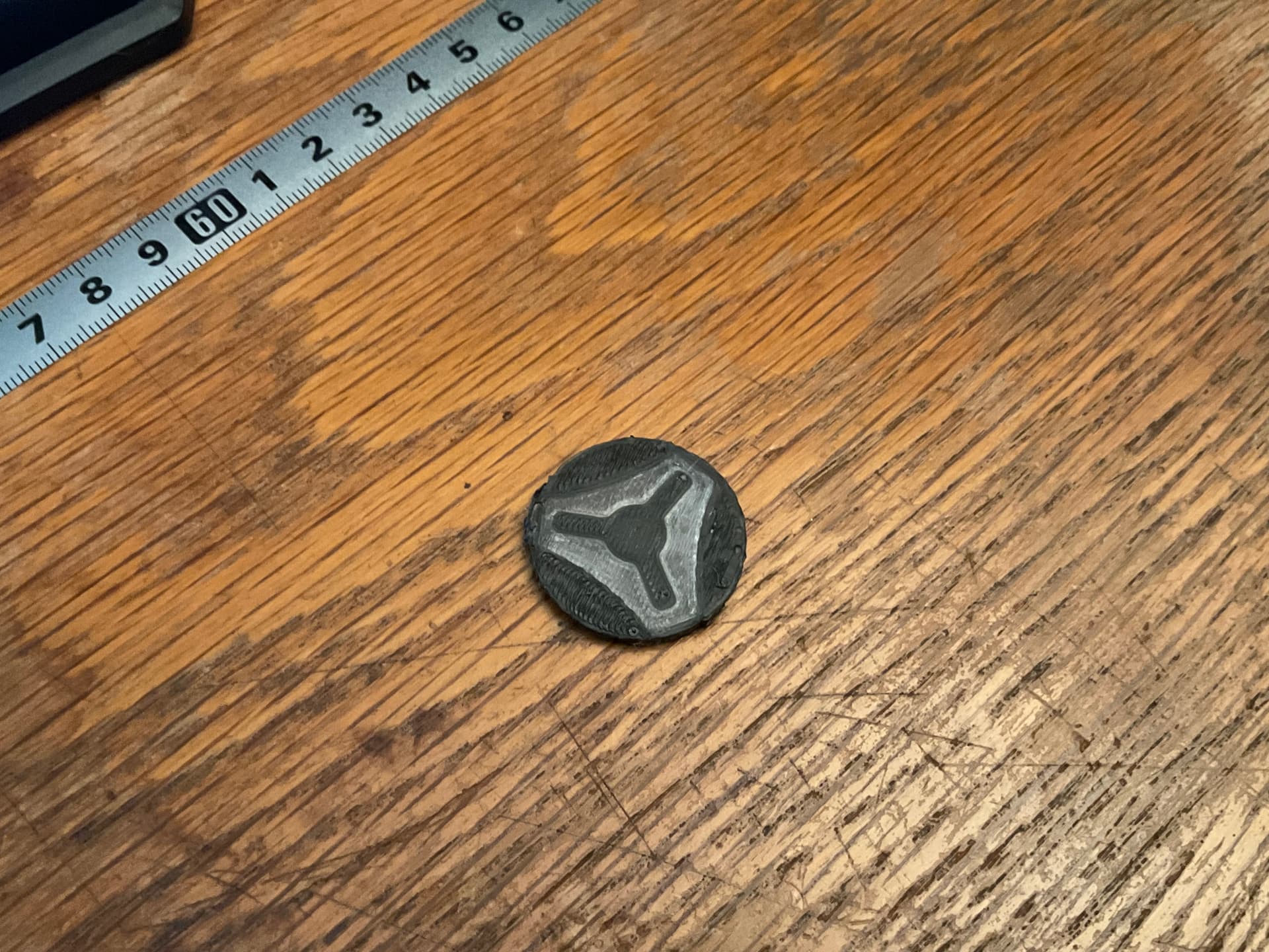

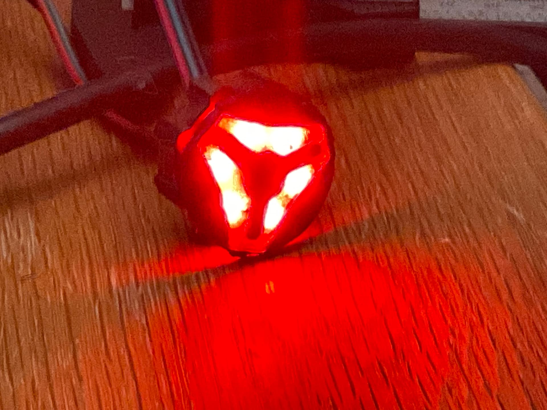

Prusaslicer gave me a warning for dual and PETG because of the temp differences but did it none the less.
3mm thick 100% aligned infill.
Adding Ironing was probably a mistake

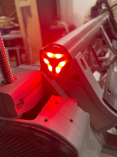

My original was 0.6mm thick clear with normal crossed infill - I think that disperses the light better and works a bit better with the logo. If you print outside face down I can’t see the need for ironing, then keep the light a surprising distance back - more than 50mm, you should get a much more subtle effect.
I am unsure about the thickness though - was going to go to 0.8 I don’t think it needs more than that, but will be happy to listen.
I’ll do a couple of dummy MMU tomorrow and put off the upload for just one more day!

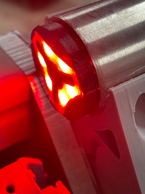

For the MMU version it’s important that the logo goes completely through. :slight_smile:
Yes - is 0.8mm thick OK for that?
Yeah, that should be enough. :slight_smile:

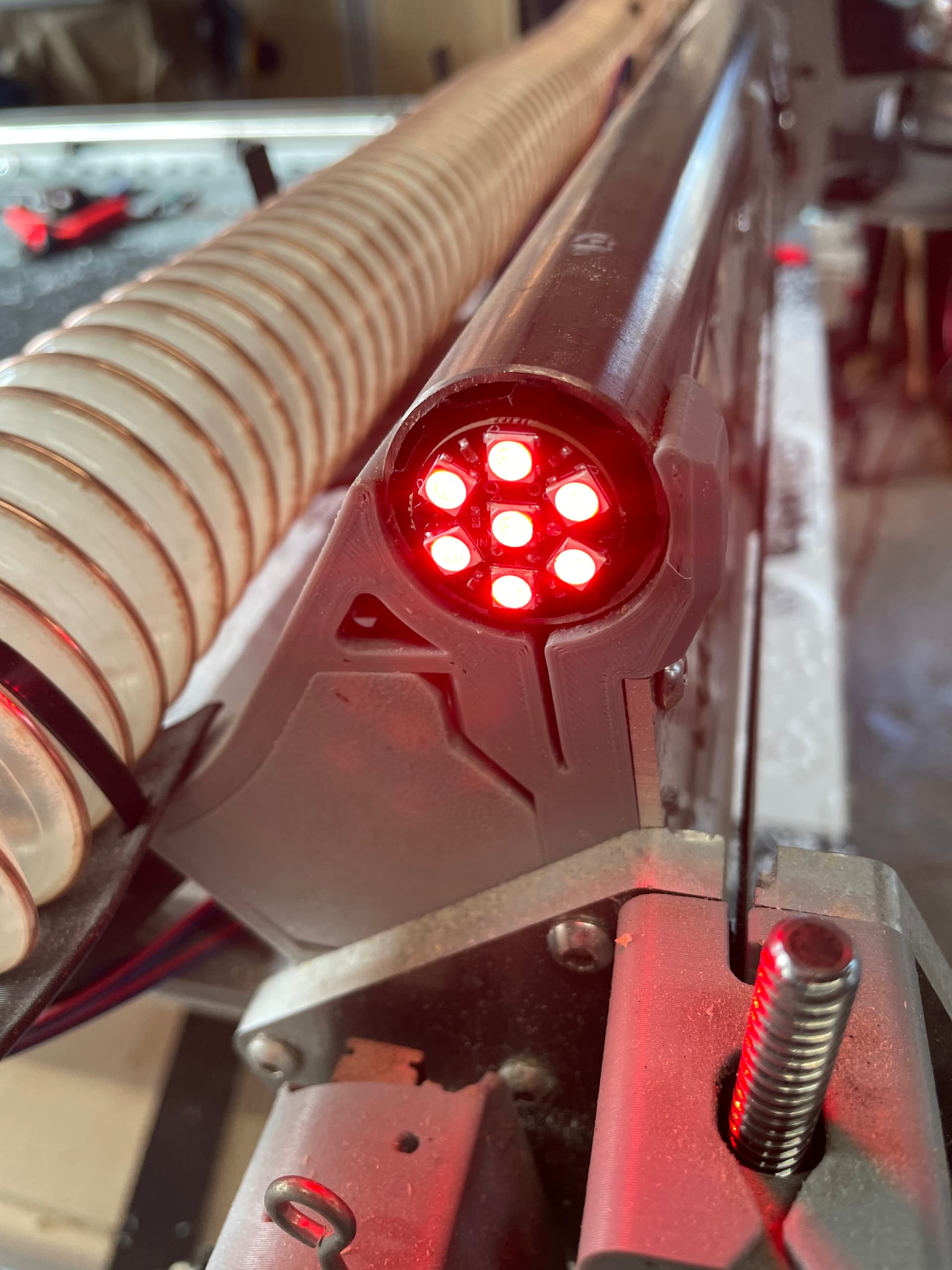

Can confirm - it’s too thick. It works but the lights very muted.

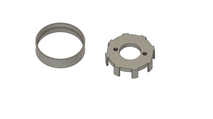

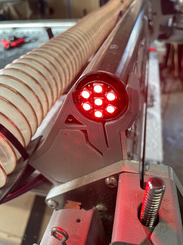

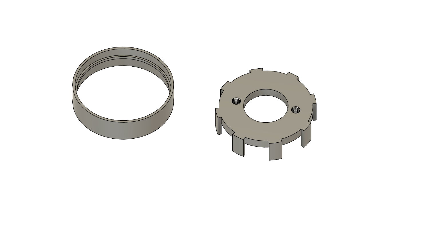

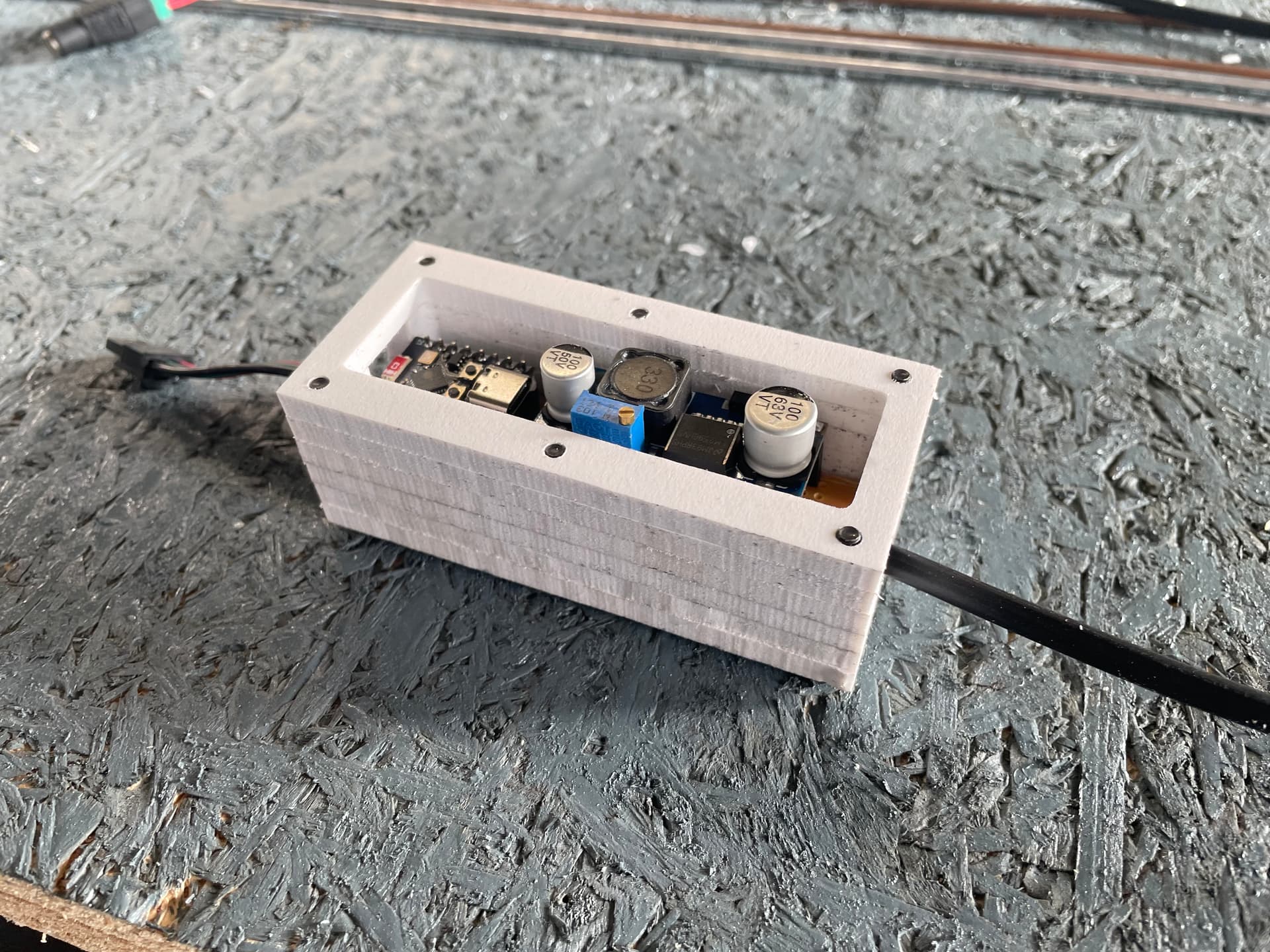

I also need to trim the board holders - they don’t slide in easily. But the better news I found some buck converters and made up the board and cabling.

Tidy up the 24v splitting supply - now serving the jackpot, laser, pendant receiver, under gantry lights and end cap lights :face_with_spiral_eyes:
