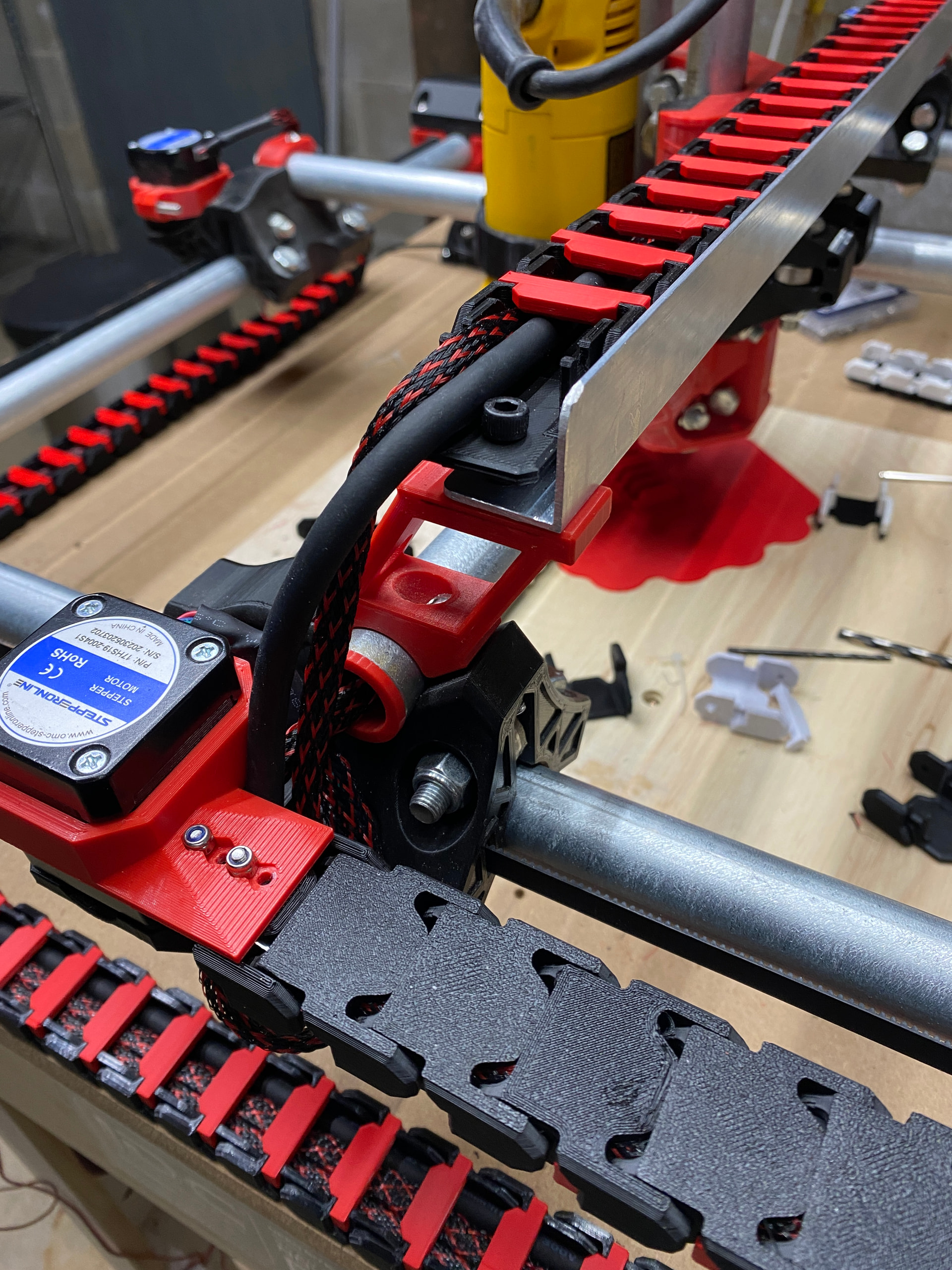

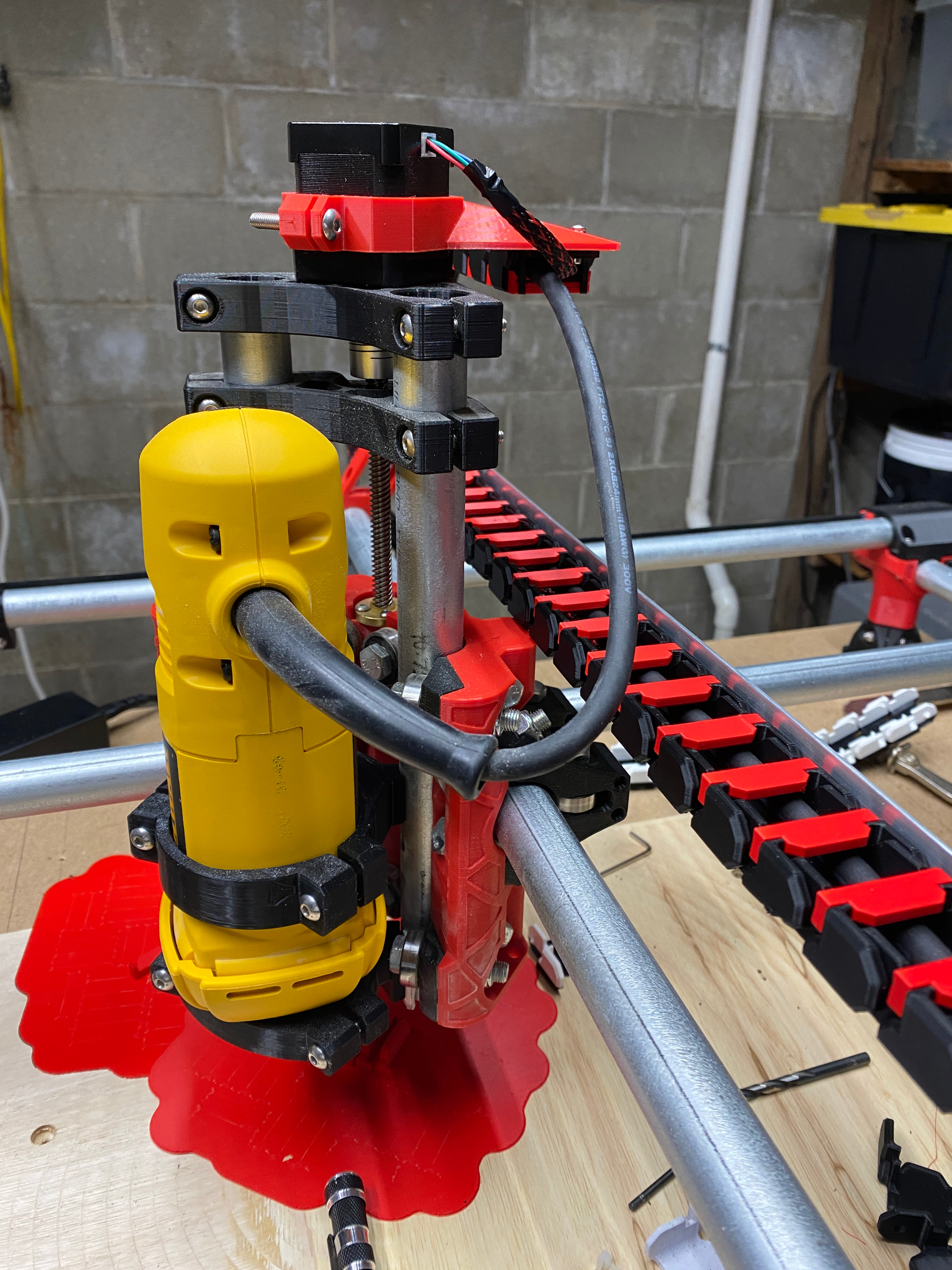

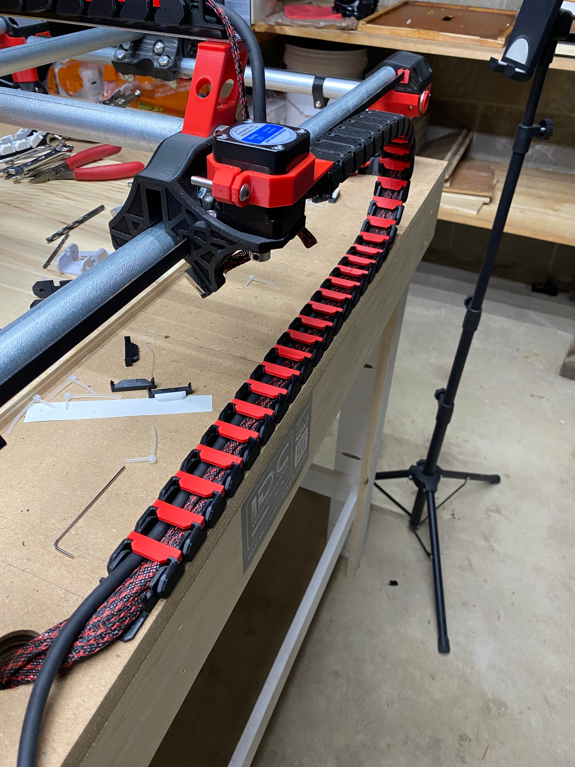

I have recently 3D printed and installed a wire chain for all three axis. I routed the stock router cord thru the wire chain. Do you think this will present an issue with the stepper motors and accuracy? Is there a better option for the router cord?
It’s not advised to fix something to the Z axis. If you check my Schneewittchen thread, there is a fixture that gets screws between the braces so it doesn’t put stress on Z. Gonna try to find it later.
Thank you. I will search for the Schneewittchen thread.
@Tokoloshe , I found your Schneewittchen thread with the cable chain bracket that attaches to the core. Thank you for letting me know about that.
