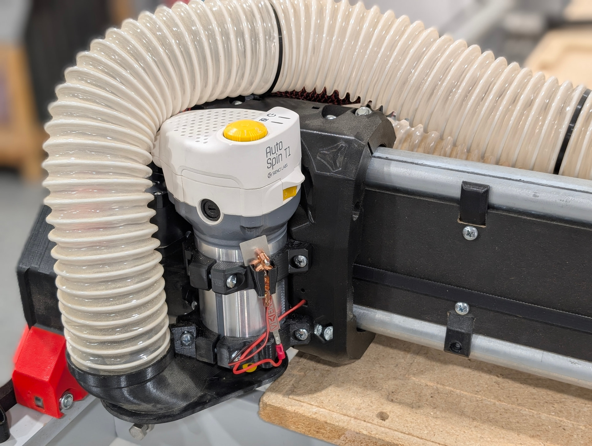

Fits good in the Makita mount, as expected. You have to bend the wires up pretty good and get them in the first core zip tie spot or it will hit the Z lead screw. No big deal. Haven’t spun it up yet.
I spy with my little eye a new touchplate holder. :slightly_smiling_face:
Ryan has this habit of tossing little surprises in pictures, but I never seem to pay close enough attention.
you are not the only one :slight_smile:

You guys are bad for my finances. Just ordered the AutoSpin. Time to reprint my mount for Makita instead of the DeWalt on there now.

The only gripe so far is one that Ryan already pointed out and its the power cord exit on the device. It’s not very fun to get it cranked down and out of the way so it isn’t crashing into stuff.
I’ll provide some more feedback once I knock out some cuts and get it dialed in.
If it is like any of the other routers we have used that part comes off anyway. I always take them off since we do not need the wear protection. I just slide them all the way down to the plug just in case I ever take the router off.
I also cut the cable at about 1ft and add in a replacement plug. It adds risk. But I like not having to fish the wire back through when I take off the router.
Not if you use a twistlock connector pair.
