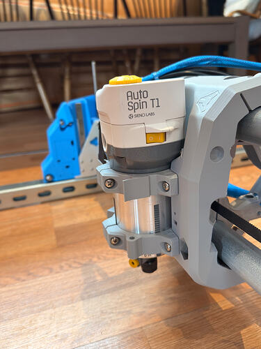

Just received the AutoSpin this afternoon, slid in like it belonged.
Looks like they send everything needed to hook it up. Plugged it in to GPIO 2 on the 5V side, now need to get into the software to initialize it.
If you’re using Fluidnc, this might help. http://wiki.fluidnc.com/en/config/spindle_speed_maps
That is perfect @Rocco85 , just what I’m going to need.
