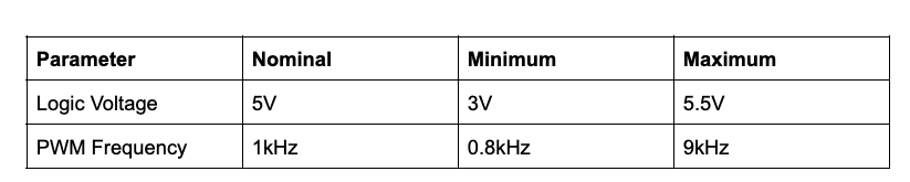

Hi everyone, working on setting up the T1 in my config.yaml and need a sanity check. Does the code below look appropriate?

I am basing off of the info provided by Scienci from this page:
And logic from the FluidNC spindle speed page:

This is from the wiki:
  speed_map: 0=0.000% 1000=0.000% 24000=100.000%
So maybe try:
  speed_map: 0=0.000% 1000=0.000% 31250=100.000%
No, that’s not what its complaining about, its the output_pin. Not sure why.

You need to change your speed map back to what you had earlier.
I put my original speed mapping in when I figured out the gpio error.
I also just updated the speed map to have the 3 .000 just in case that was needed:
speed_map: 0=0.000% 0=20.000% 10000=20.000% 10000=32.000% 30000=95.000%
I wonder if it helps to lower the hz back to 1000 or even 800.
