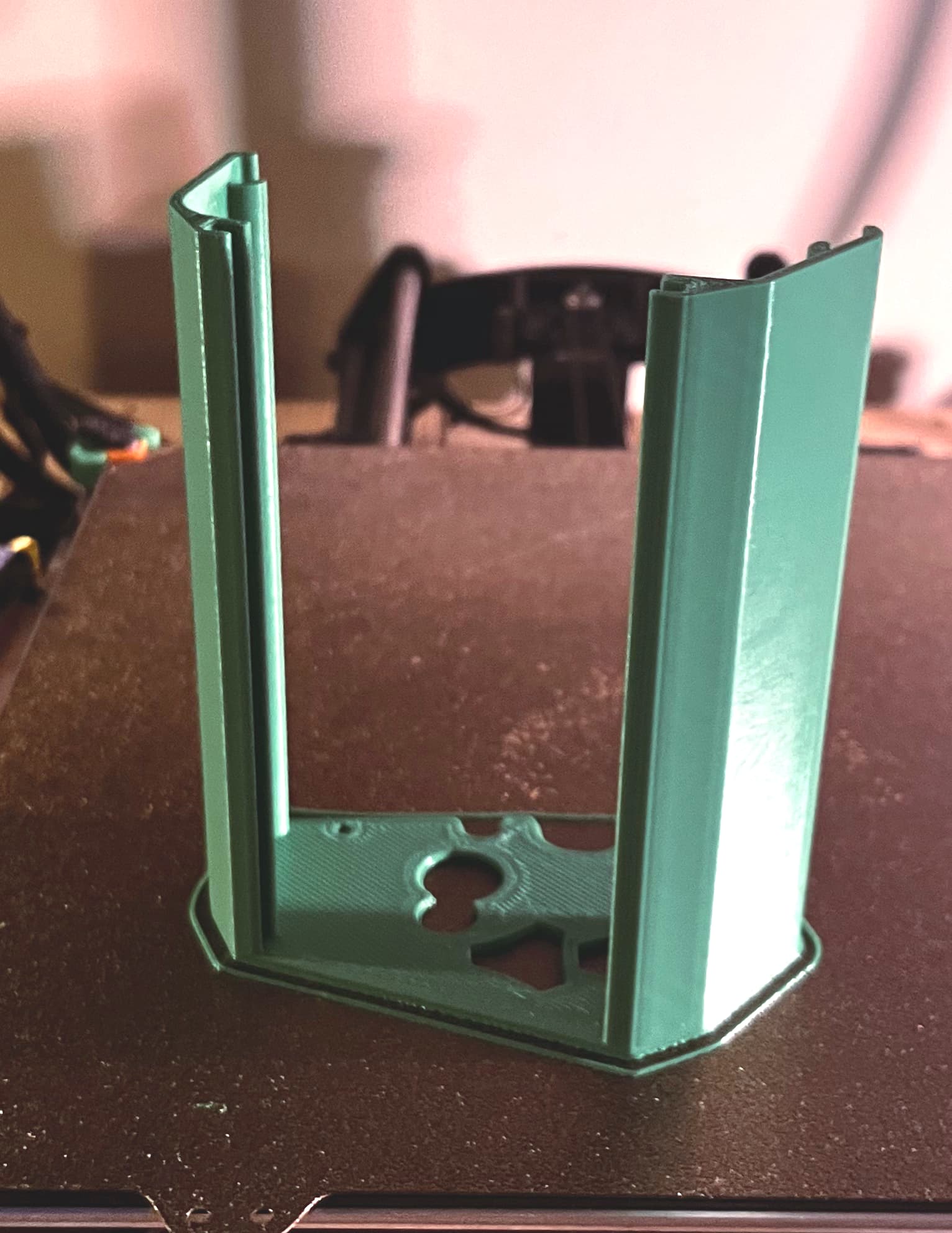

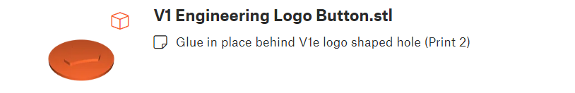

Good job! A small thought, some creators on printables use the “tiny text” for each model. I found this really helpful, i.e. it says “print 1x” etc.
I’m not sure what this means. Can you expound on this a bit more?
Yeah, of course.
Here the tiny text is “Glue in place behind…” I find that this makes it easier.
@waimea
Ah, I don’t know when they snuck in that feature, but that is helpful. I used it just now to try to distribute some of the text so the names could be shorter. Hopefully I did not leave people out in the cold after they download, by moving info into the other field, that may not follow the model parts after the download.

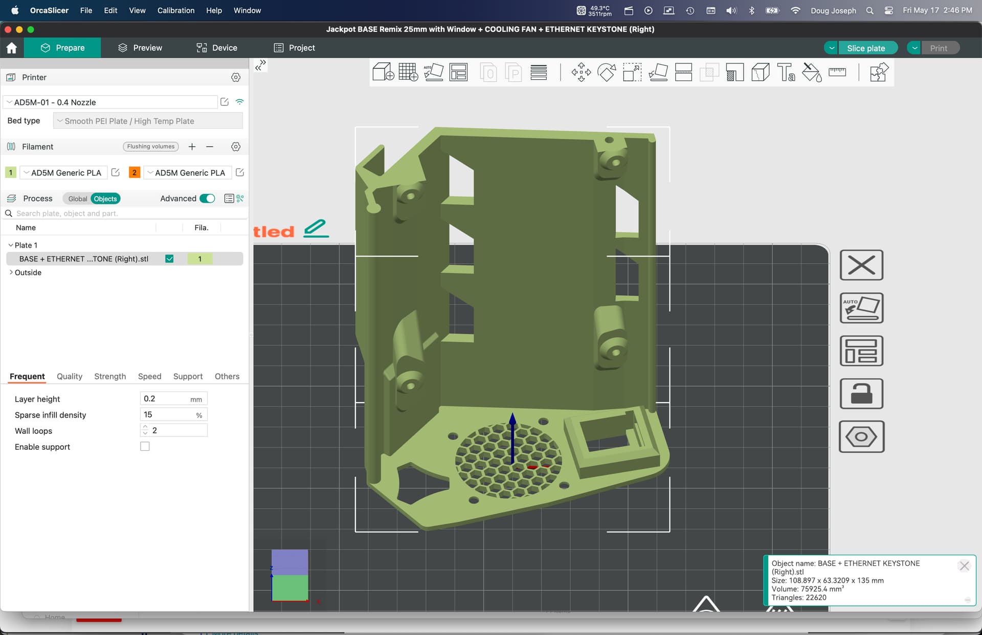

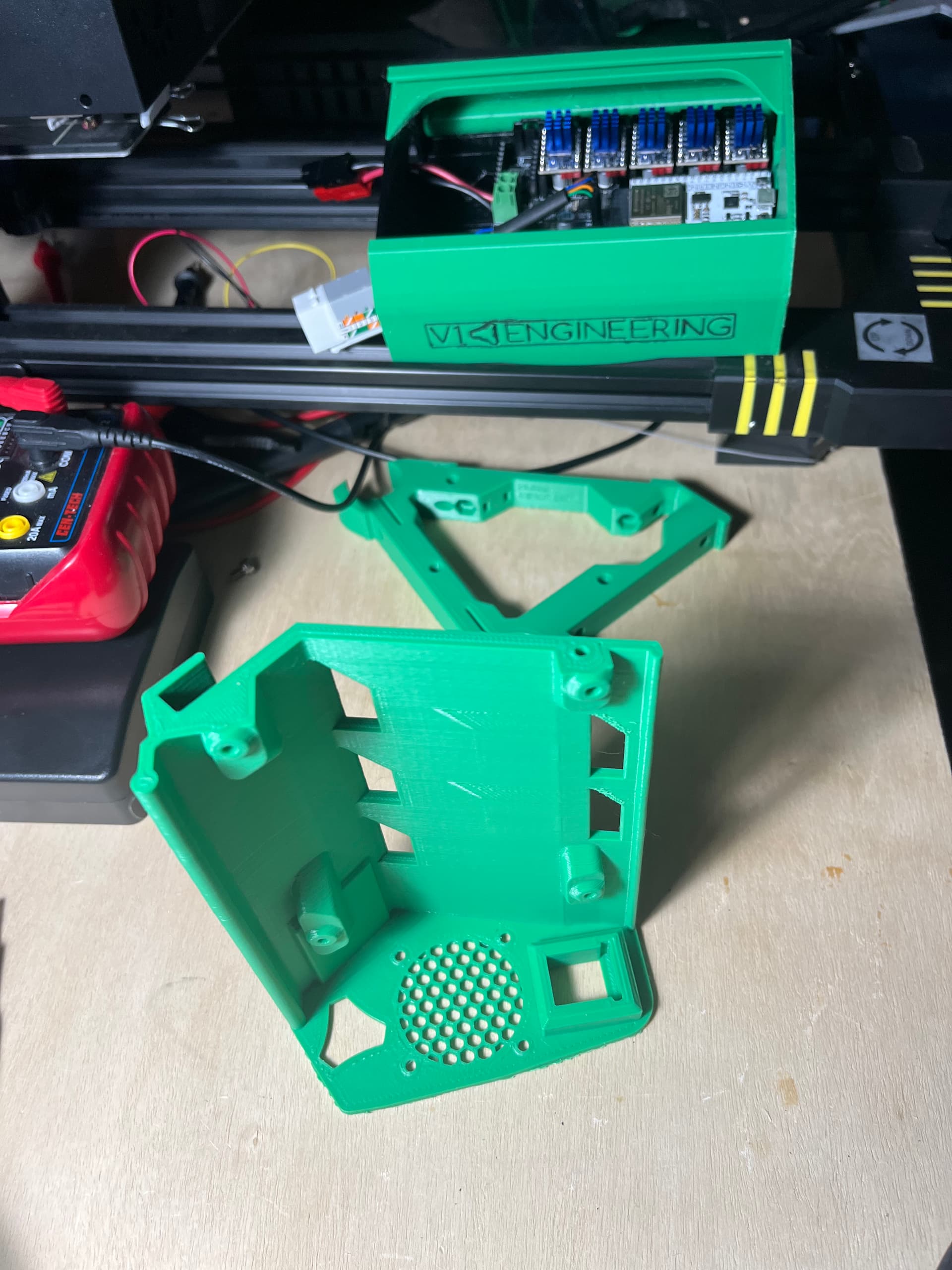

Just started working with this one.
I downloaded the file
BASE + ETHERNET KEYSTONE (Right).stl
On this file, Flashprint declared the .stl needed repair, so I did that.
I tried to place it on the build plate with the fan/keystone side down. In doing so, there is a weird vertex present, so the slicer complains the part is not on the bed. Not all of the face is in the first layer.
I adjusted the position down -.02mm, and that seems to yield a usable slice.
One of the FFCPs is warming up now and I’ll print it shortly.
Your description shows that orientation on the bed in the slicer- but it might help users to call that out early in the description (or orient the STLs that way)

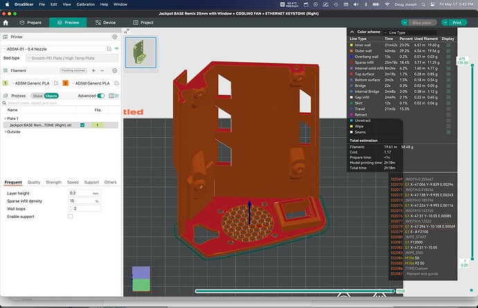

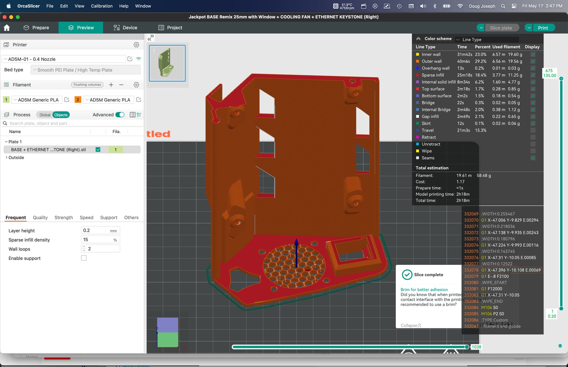

I imported into OrcaSLicer my file (same as what I uploaded to Printables) and it showed no errors. It also slices with no errors.
I then also downloaded all the files from Printables (to check “full circle”) and imported into OrcaSLicer the downlaoded file and it showed no errors. It also slices with no errors.

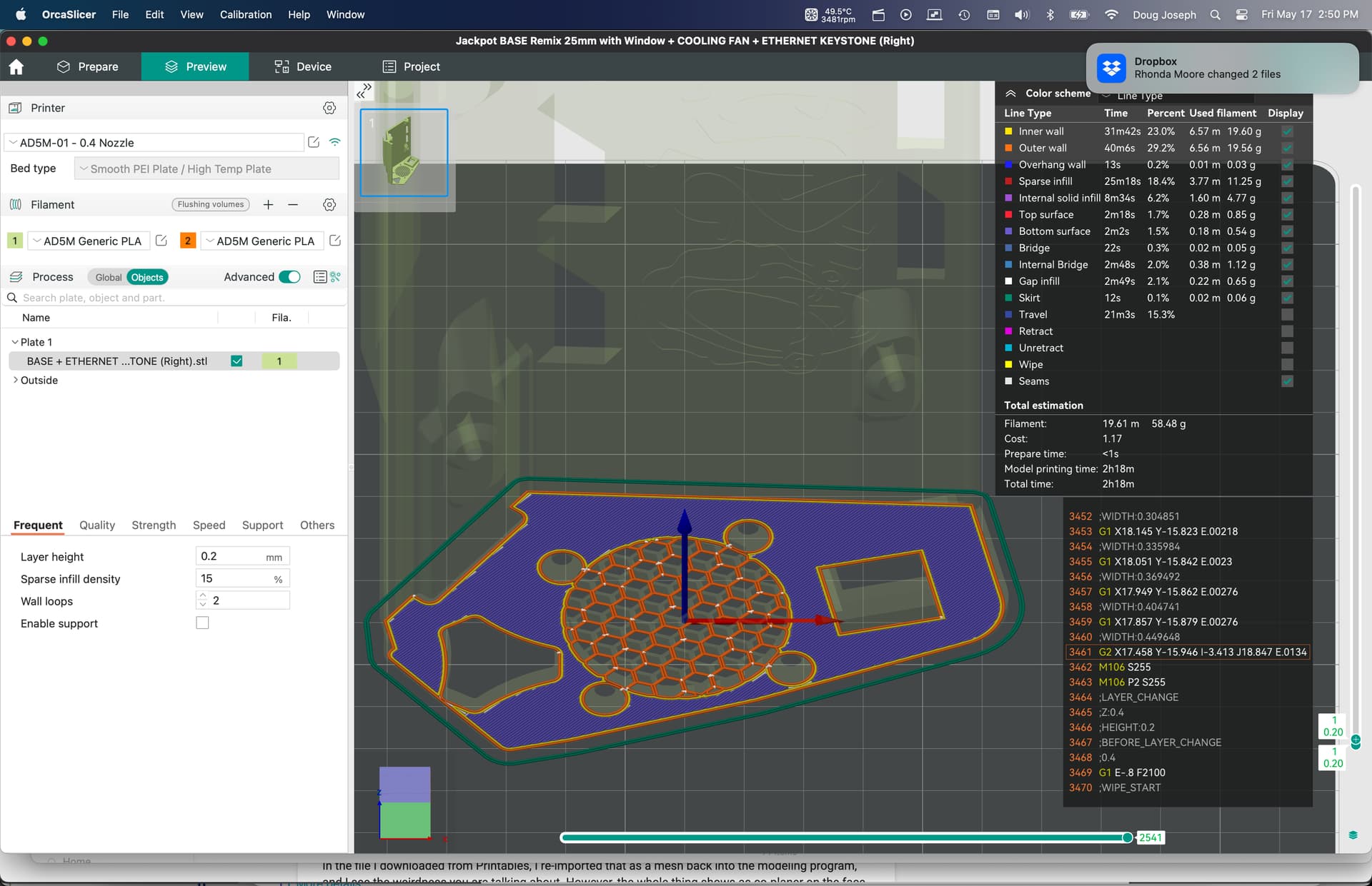

In the file I downloaded from Printables, I re-imported that as a mesh back into the modeling program, and I see the weirdness you are talking about. However, the whole thing shows as co-planer on the face that should go against the bed.
I am tweaking the source file to re-output with hopefully prevening the weird thing.
This is the sliced first layer of the file downloaded from Printables (full circle test).
OK, I re-edited all the variations of bases, and re-uploaded them to Printables. If you get a chance, try just looking at it in your slicer after a fresh download.

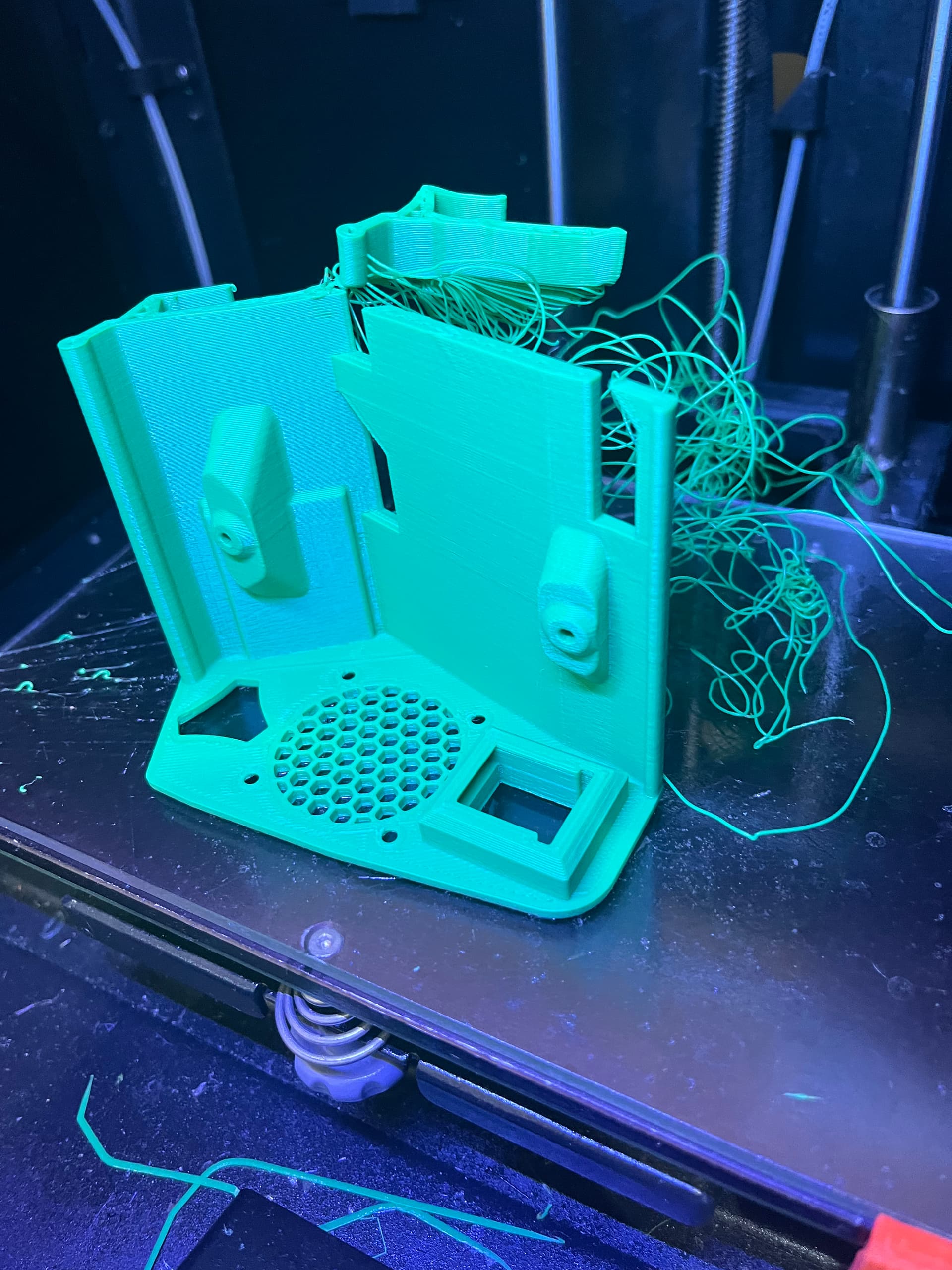

I’ve been able to make a little progress.
The first print (Where I lowered the base -.02mm ) failed.
It popped off the build plate and spaghetti-ified.

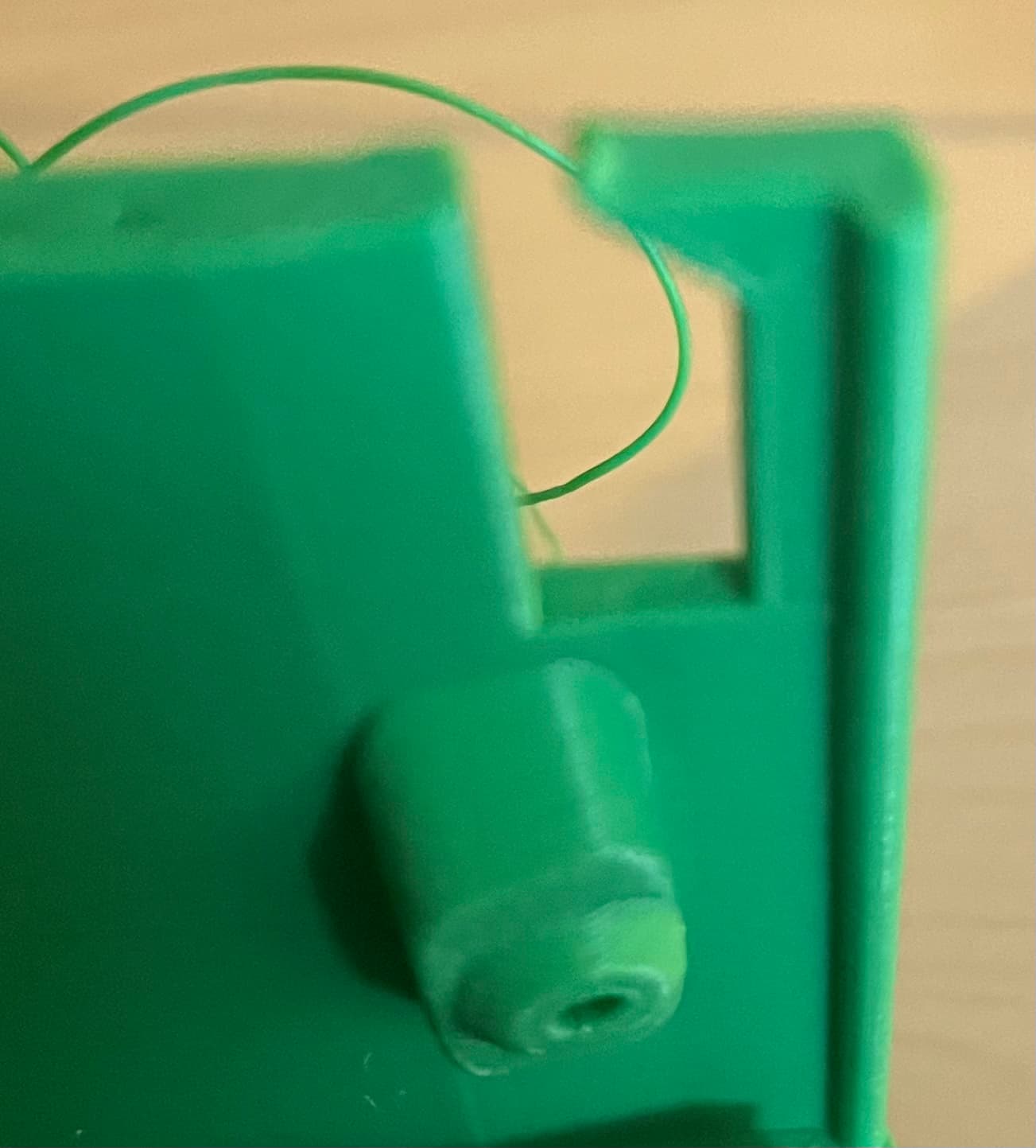

The reason for that (Aside from needing even better adhesion) is that there is upwards curling happening on the overhang shown below. Top right of the print has an upwards curl.
I didn’t orient this one the best way, as the FFCP is dual extruder and if you don’t keep such things out of the Y axis line, then every curl gets hit by both extruders multiple times per layer.
For narrow, tall prints this eventually pops the part off the bed.
Couldn’t get this to focus, but you can see the tip of the curl where it finally caught hard and popped off the bed.
As you may be able to see, the keystone jack port looks great and printed very well.
I re-oriented this and started a fresh print with a brim. It looks great, and I’ll fit a jackpot on it late today.
