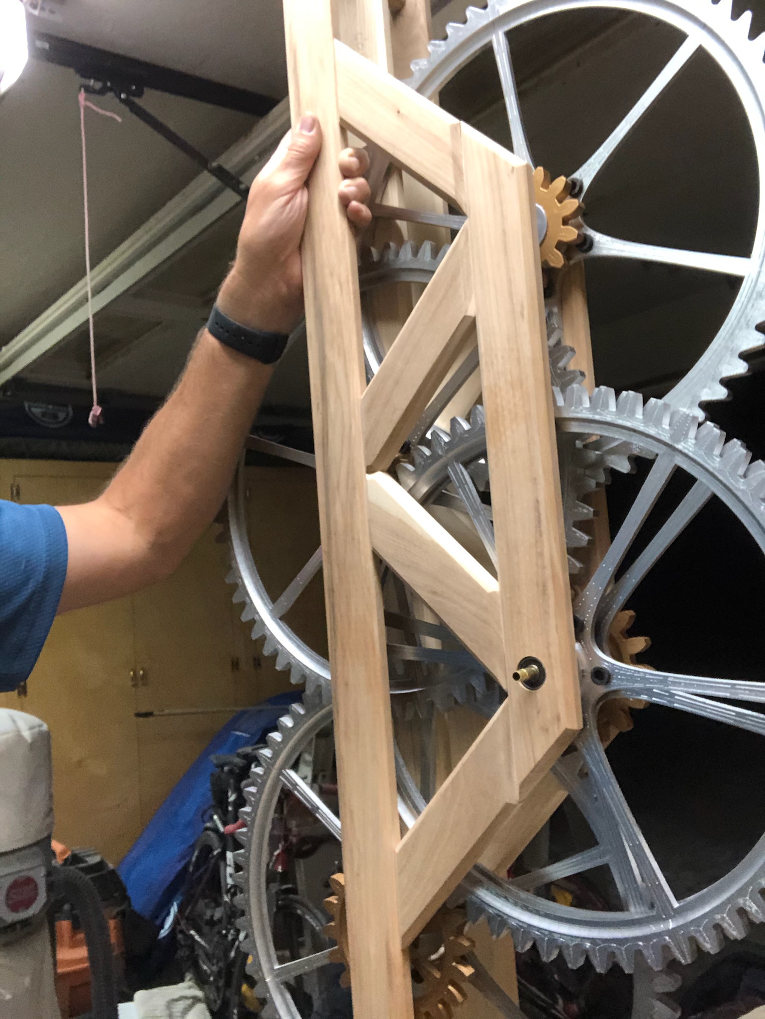

I’m in San Jose, so you’ll have a local guy flushing out MPCNC 2020 as soon as I can download and print it. I have the perfect project that needs a little more stiffness. In the previous picture you can see a fireplace. I designed a clock/kinetic sculpture that hangs on the wall. The 3D printed gears are too light and hard to keep planar, so I’m going to use the MPCNC to cut new gears. See photo of the 3D printed prototype.

How thick are each gear? Rather than cut away a huge amount, it might make sense to get 1/4" stock and laminate instead.
The voronoi panel was done by indexing the cut in sections and pushing the 97" x 34" sheet through a couple of feet at a time and having the G-code for the new index pick up from where the prior cut left off. The machine was built on a 48"x48" base, so it can cut 36 x36, or thereabouts. It’s not very accurate, but for this cut-out job, plus or minus 1/8 absolute accuracy and 1/32 relative accuracy was fine.

Correct. I’m keeping the hickory wood chassis of the clock and just cutting new gears with the MPCNC 2020. I printed and glued the original gears in 60 degree segments. But the PLA was not very stable and did not glue very well - I kept cracking them apart. Also, they did not print out totally accurately and so the glued gears ended up with a slight bowl shape so they did not fit in their lanes to mesh properly without scraping against gears running at different speeds in different lanes. Occasionally it would decide to lock up and that made for total chaos. A clock as a huge reduction ratio - so a one pound pendulum generates a lot of torque by the time you get to the hands, easily breaking teeth off a locked-up gear train.

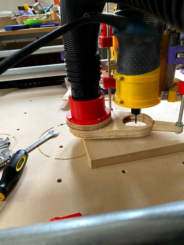

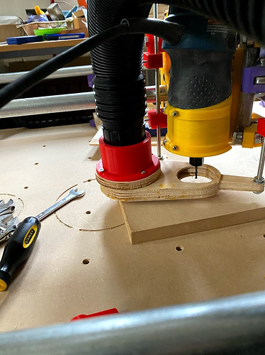

Oh no, I just modeled the xy and xyz assembly and modeled myself some dust collection.It would be great if the new design had a recommended dust collection approach. I was inspired by http://www.thingiverse.com/thing:2597409 but modeled it in Fusion 360 and made the brackets a little more organic (though they are still not super beautiful)… But it does make me more happy to use the CNC as it doesn’t spit dust everywhere.

I am still not sure where I stand with this. You will always loose some accuracy strapping a vac hose to the gantry, and a little build volume. I have made some lower screw holes to mount to for thin mounts, and maybe I can provide one at some point but it is not a huge priority for me. I use my MPCNC for accuracy and my LR for large parts with bigger tolerances.
