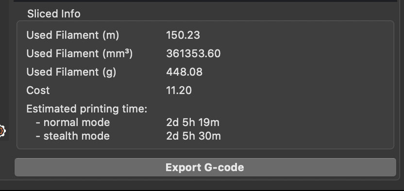

Same dilemma but made easier since my burly zyx core is showing some fatigue and now has play that is a problem when I use a 1in leveling bit.
The core is some serious print time.
Whoa. Start with a new filament spool there. My luck I’d run out at 2d 4h while I was sleeping.
This is with 4 perimeters, 70% infill (as recommended for this part), 0.2 layer height and Gyriod infill. Swapping out for rectilinear infill drops the time to 1d 10h!

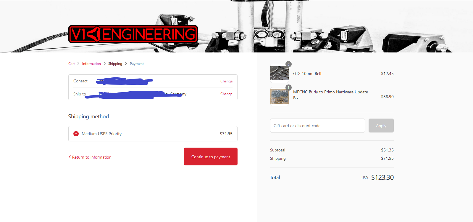

To redo my setup, the stainless would cost $160 :frowning:
Should I just wait for the 23.5? Is that the next release or the last release?
Or is stainless a much better upgrade from 3/4 EMT conduit?
There is no way the shipping is that much from my site if you only bought the upgrade kit and a normal amount of belt. I designed it to fit in a small flat rate box $26 international.
