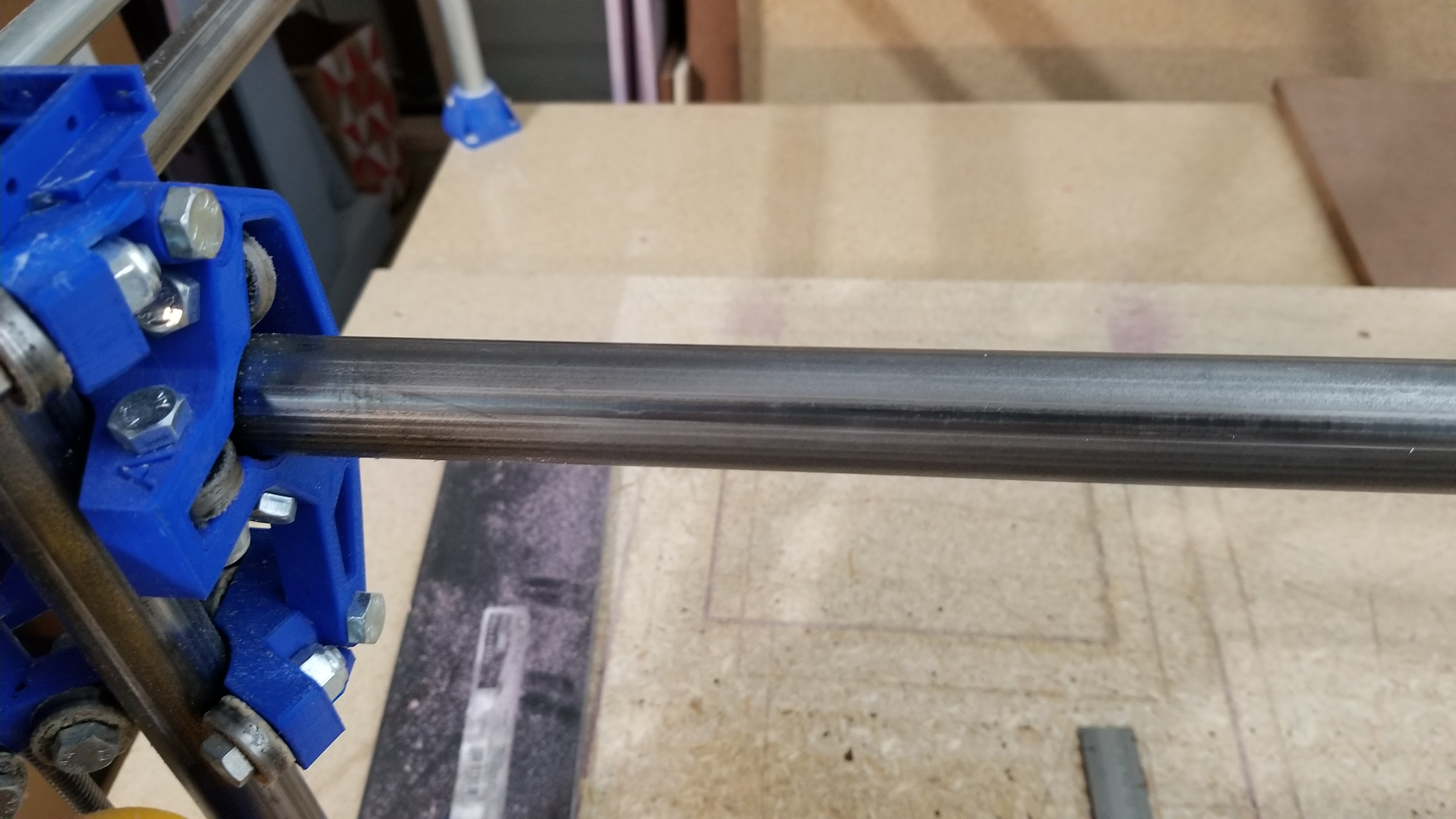

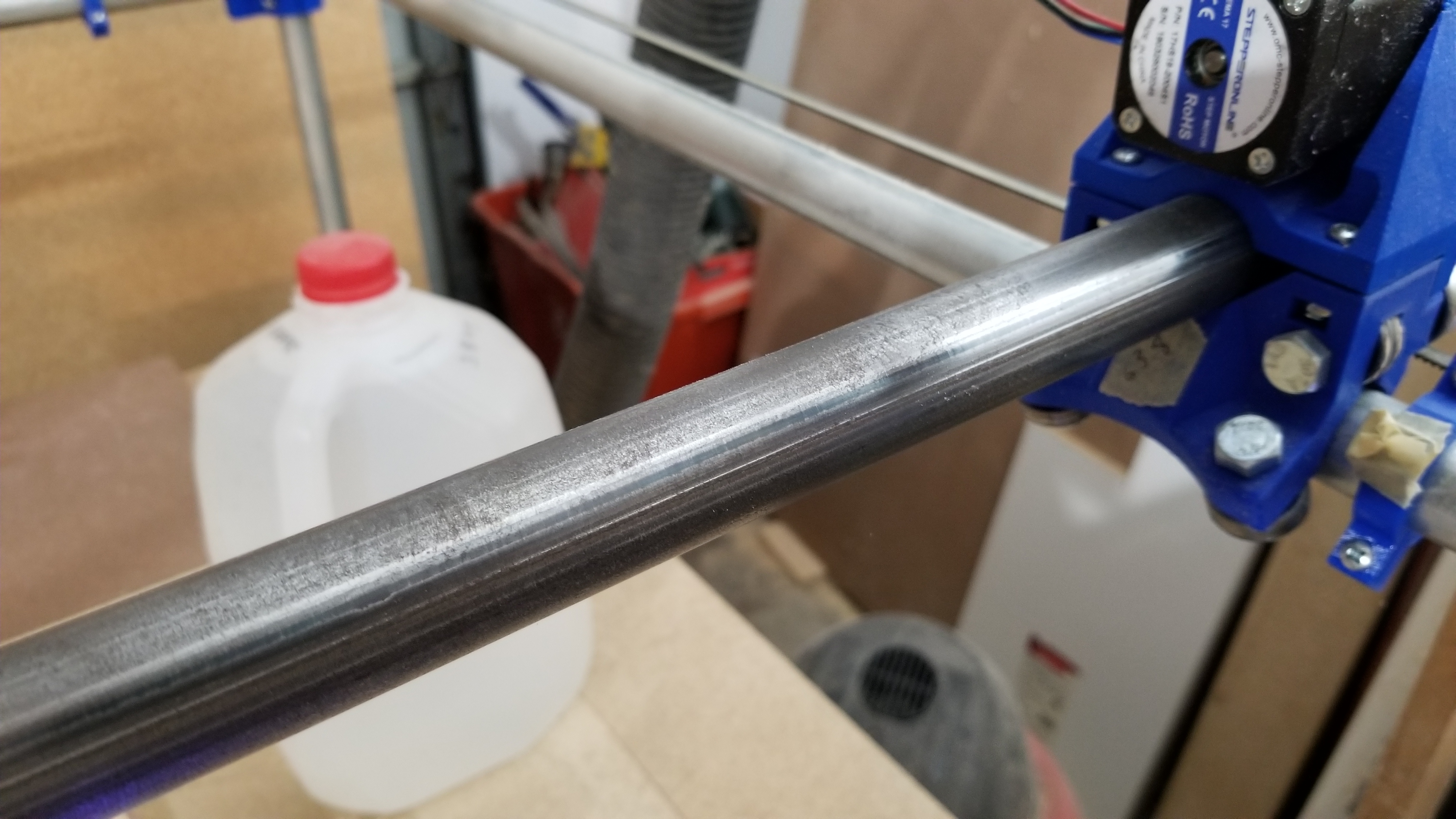

A year ago I got some 1" x 0.120 from Metal Supermarket and it was pretty economical.
I think “HTR/1120” might be hot rolled but it was pretty smooth and not covered with scale as far as i could tell (not an expert).
I did no treatment at all and after a year, this is what it looks like now:
This is in a garage in north Texas, so it’s not Louisiana but it’s also not Arizona. Seems ok.
