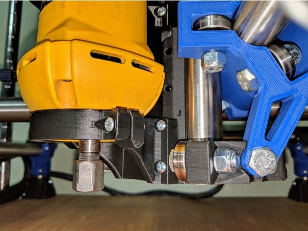

Is this still the current 660 mount?
Nope!
Look at the picture of the mount that I post.
Completely different.
