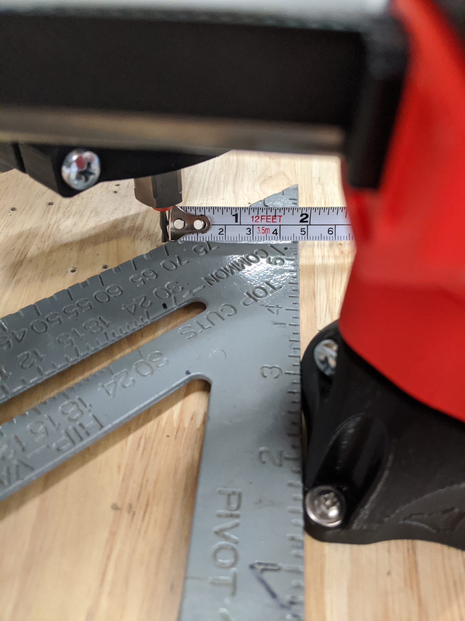

How close does the 660 get to the 0,0 corner with my 660 mount on the burly? I Think measuring from the shaft to the corner would work, and it should be symmetrical. If you measure a different way let me know. I am trying to see if I gained or lost work area with the new mount.
If I was smart I would have kept my burly built so I can do these things myself.
From the inside edge of the foot (same footprint on both versions) to an 1/8" endmill, looks like 47mm
