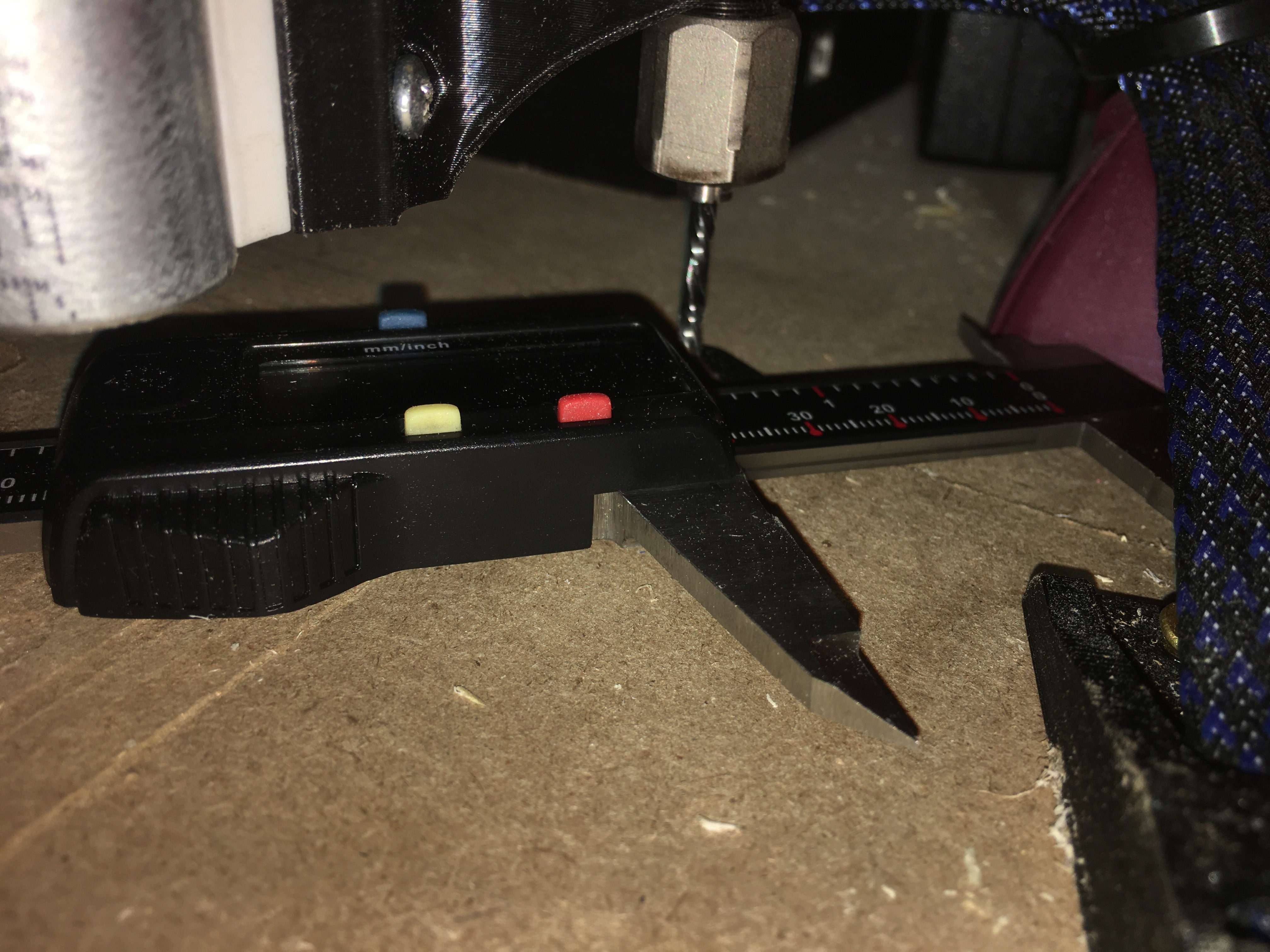

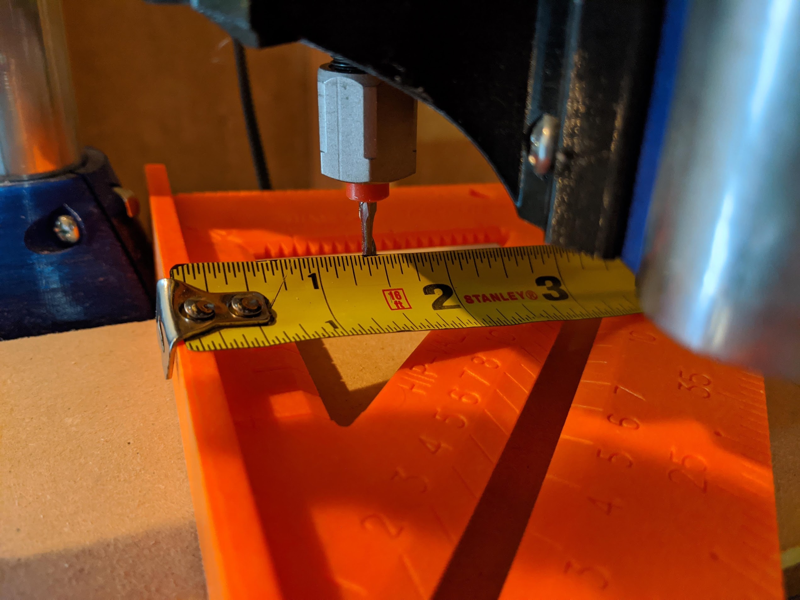

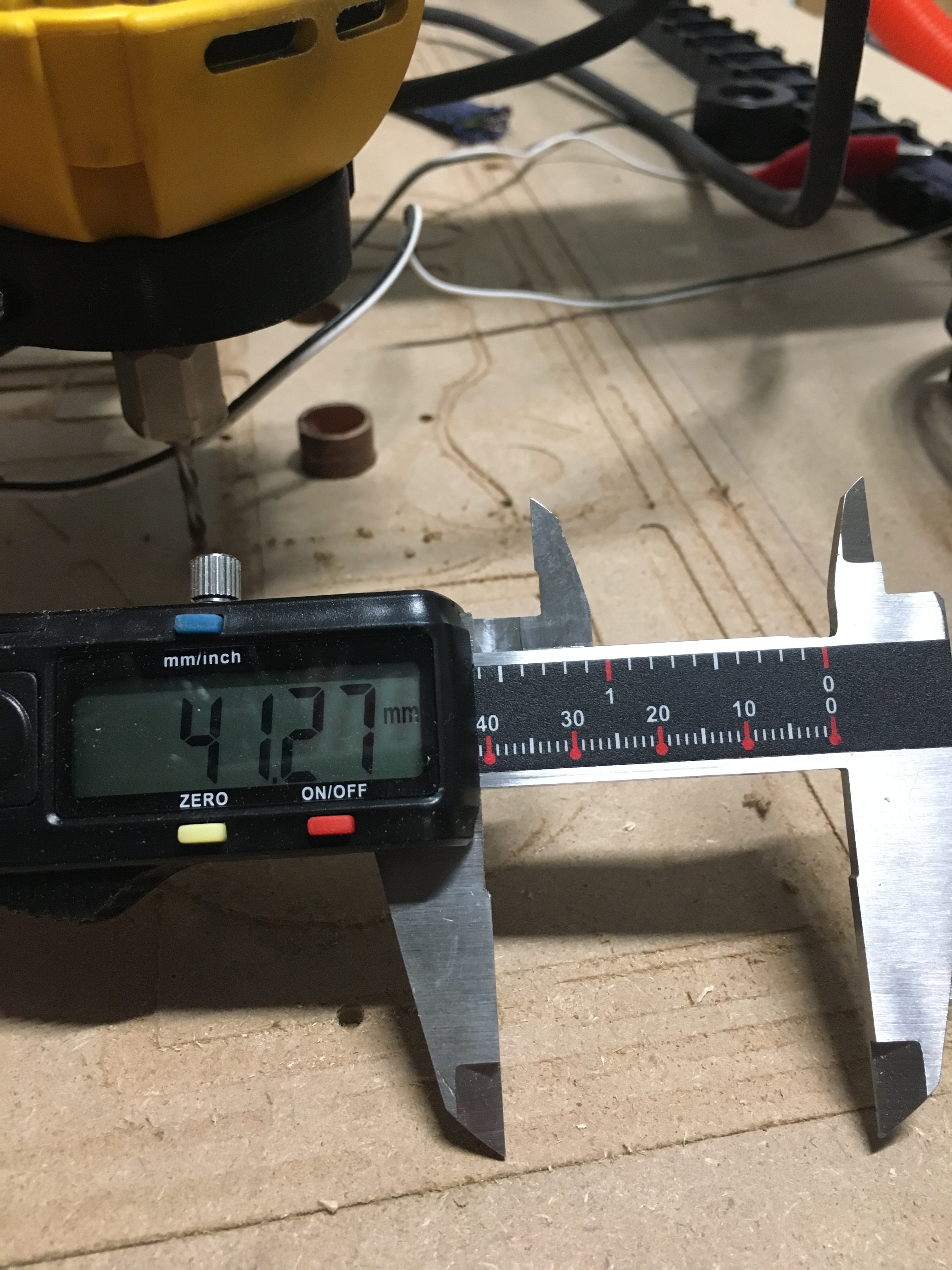

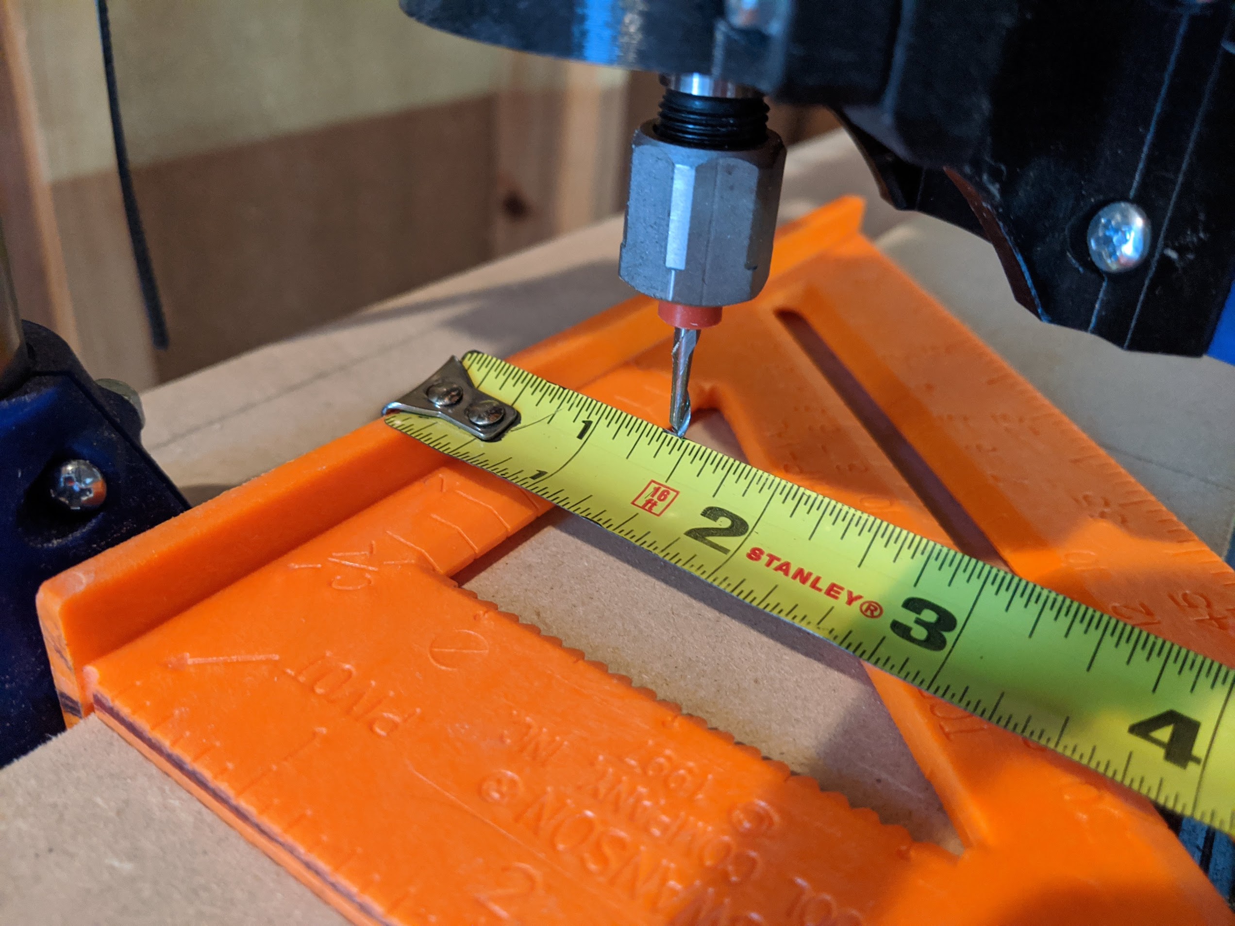

This is what I came up with the closest I could move the axes to the corner.
45 degree from feet. bit is align with the cut at the feet.
I can’t measure any other way cuz of cable chain and control box.
Dang that is a huge difference. 12mm 1/2"…not happy with that
Ready to print new parts.
